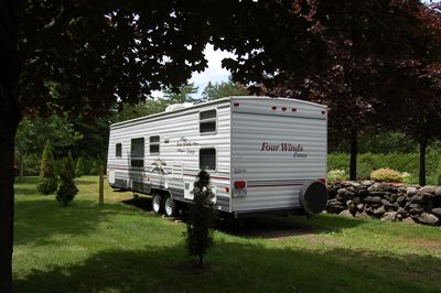

Anybody have experience with this company and their tractor parts/attachments? OMNI BX Special 3 Point Trailer Hitch for Kubota - OMNI Mfg
Looking for something to haul the utility trailer around and also move my camper (30 ft) into a tight area not easily done with my truck. Would the camper be too much weight? No grades, pretty level when moving.
I have BX 2660.

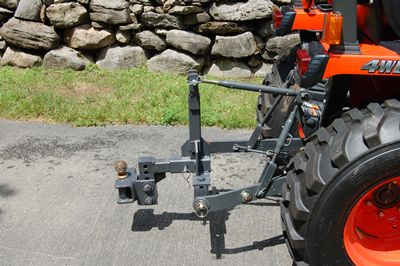

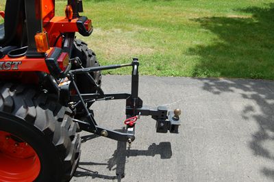

Bamacummins,
I pull my 31 ft travel trailer around the yard for the same reasons with a homemade 3 pt hitch on my B2320. see pictures.
Inky05 is bang on the comment about not enough tongue weight. It can damage your system or its very anoying to climb on your utility trailer and the front end starts lifting. My travel trailer has plenty of tongue weight (800 lbs) so it is not a problem but if you use a smaller utility trailer the tongue wants to go up depending on how your load is distributed. I would recommend getting a 3 pt hith with a chain that attaches to your drawbar and prevent the movement upwards. I added this into my design and it works well (it's not on my pictures but is similar to the one on the link below). I believe this company (see link) design theirs this way also.
Bad River | Home
You can probably modify the one you are looking at to serve the same purpose.
Like radioman I keep the FEL on otherwise the tractor front end is too light. My heavy travel trailer makes the front wheels less effective when turning. (some weight in the bucket will also help)
It's a great add on to your tractor and makes your life easier to move things around.

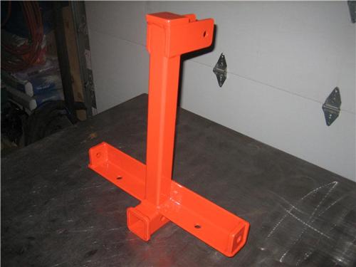

Built mine from an old reciever hitch off of a pickup truck, It works great and moves my 16' tandum axle trailer just fine.
