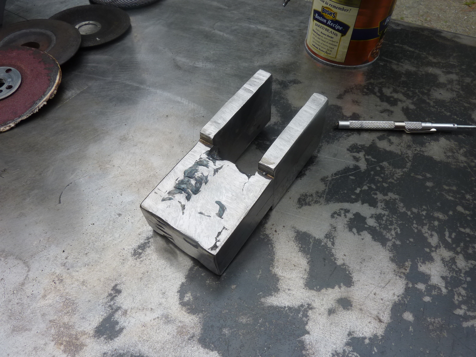

I would take some 7018 at 125 amps to it and give it a go. Nothing to lose but a little time, and if it failed, so what? Bevel it good and just keep putting in the passes.
That's what I'd do first.

I've seen several broken tractor drawbars repaired by welding.

Friend of mine did the same to his Ford 4600 drawbar while using a manure spreader. He V'd it out, heated it to like 400 degrees, welded it with 7018 on AC Tombstone, then post heated it, then buried it in sand for slow cool down. It was still on the tractor like 10 years later when he traded it in. He was a weldor in the local steel mill.

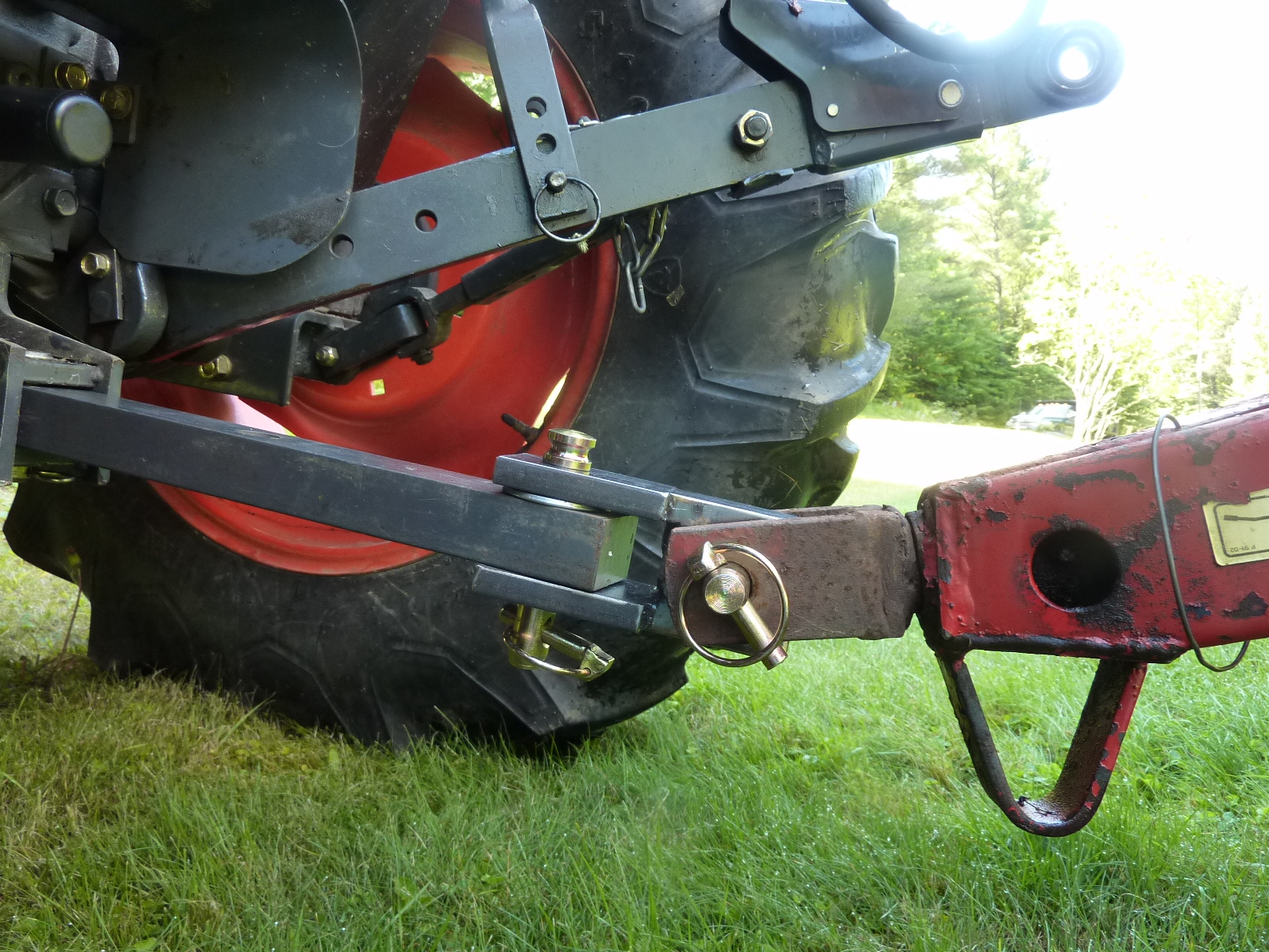

Bruce, I certainly agree with the thought of swinging clevis conversion. Do you know of any 'options' which would allow a solid 'vertical hole hitch' to be converted into a swinging clevis hitch? I would have thought there would be something I could purchase that would simply bolt into the solid hitch, therein adding the 'swing' between the blade and tractor, but I don't see anything similar. I don't know that a 'shackle' between would work, but then again, I don't know that it wouldn't.
My drawbar is also 1 1/4" thick. I made a clevis hitch out of sandwiched 1/2" plate welded together and drilled.

The drawbar is a special high strength steel,,, you can not weld it. (BTDT)<snip>
Devices made with special steels are often welded, with an appropriate rod and appropriate technique. Most rod manufacturers make a special purpose "Maintenance" rod that is versatile but expensive. A good local welding shop likely has the rod, knows the technique, and probably has some experience with the application. Expect to pay for their expertise.
Yeah, I welded a blade holder on my JD 10' brush cutter cause I didn't want to pay $600. That was 2 years ago. No problem. That's why I asked about using the hole where it's broken. If it's not used, I'd weld it.
gg
That's what I was thinking but with a 3rd axis (swivel). It would be able to move side to side, up and down and rotate. There would be no twisting force on the drawbar, some tongue weight and a little side to side if you really pinched it when turning.
