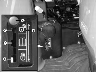

Open Station
Selective Control Valve (SCV) lock lever (A) allows the operator to control the type of dual SCV lever movement needed for a particular operation or situation. Operation of the lock lever is indicated on label (B).
To allow movement of dual SCV lever in all directions, move lock lever to the top position (C). Operation of the dual SCV is totally unlocked.
To prohibit engagement of the regen (regeneration) function of the dual SCV, move lock lever to the middle position (D). This position is recommended for all implements except for the front loader. Heavily-loaded loader buckets will dump more rapidly when the regen function is engaged. The regen function is available only with the lock lever in position C.
To prohibit movement of dual SCV lever in all directions, move lock lever to the bottom position (E). Operation of the dual SCV is totally locked.

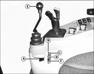

Cabs
To allow movement of dual SCV lever in all directions, push the lock lever inward to center position (D). Operation of the dual SCV is totally unlocked.
To prohibit engagement of the regen (regeneration) function of the dual SCV, push the lock lever all the way inward (F). This position is recommended for all implements except for the front loader. Heavily-loaded loader buckets will dump more rapidly when the regen function is engaged.
To prohibit movement of dual SCV lever in all directions, make sure SCV lever (E) is in center position, and pull the lock lever straight outward (C). Operation of the dual SCV is totally locked.
