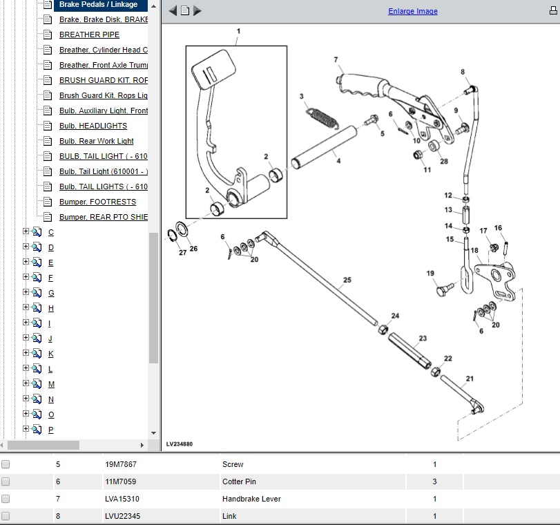

I have searched everywhere for some information and have not found anything. So I am looking for some help. I recently parked my tractor on the side yard on a slight hill without setting the parking brake. This was mainly because I was being chased by ground Yellow Jackets, so my judgment might have been a little off. While I was spraying myself off with the water hose one of the neighbors had come over due to the commotion and the tractor was rolling down the hill toward the pond. He pulled the handle on the parking brake to stop the tractor and got nothing. So he lowered the bucket and stoped the tractor. I am not sure if the brake broke or what caused it but before I started using the tractor that day it worked.
Now when I hit the peddle or pull the hand brake all the visible linkage works. It engages the diff lock as it should and turns the shaft that goes into the rear trans axle. But it does not stop at all it is not an adjustment setting as there is not resistance at all and before I would get stopping force from just a slight press of the peddle.
Does anyone know what is inside the transaxle housing that the brake shaft connects to and how hard it is to get to? Or is this a simple problem that I could be over looking the solution?

Go to jdparts
John Deere - Parts Catalog
and put in the tractor model and look at the schematics to see if it helps track the parts for the brakes.

Thanks everyone for the input so far. I used that website and I think I might have damage to the cam on the shaft that goes in the axle housing. But I think to get in the housing I have to crack the case and drain the fluid. I really don't want to do that. I will call the dealer tomorrow.

Engage park brake and move transmission range shift lever to a position other than N (neutral) before leaving machine unattended. Transmissions will not prevent machine motion without the park brake engaged.
The parking brake needs the transmission range to be in any position other than neutral to work...:(
   / 3038e Brakes and Ground Yellow Jackets
Thanks for the note. Problem is I can pull the brake up in low and drive with no resistance. Pushing the brake and driving does nothing.
