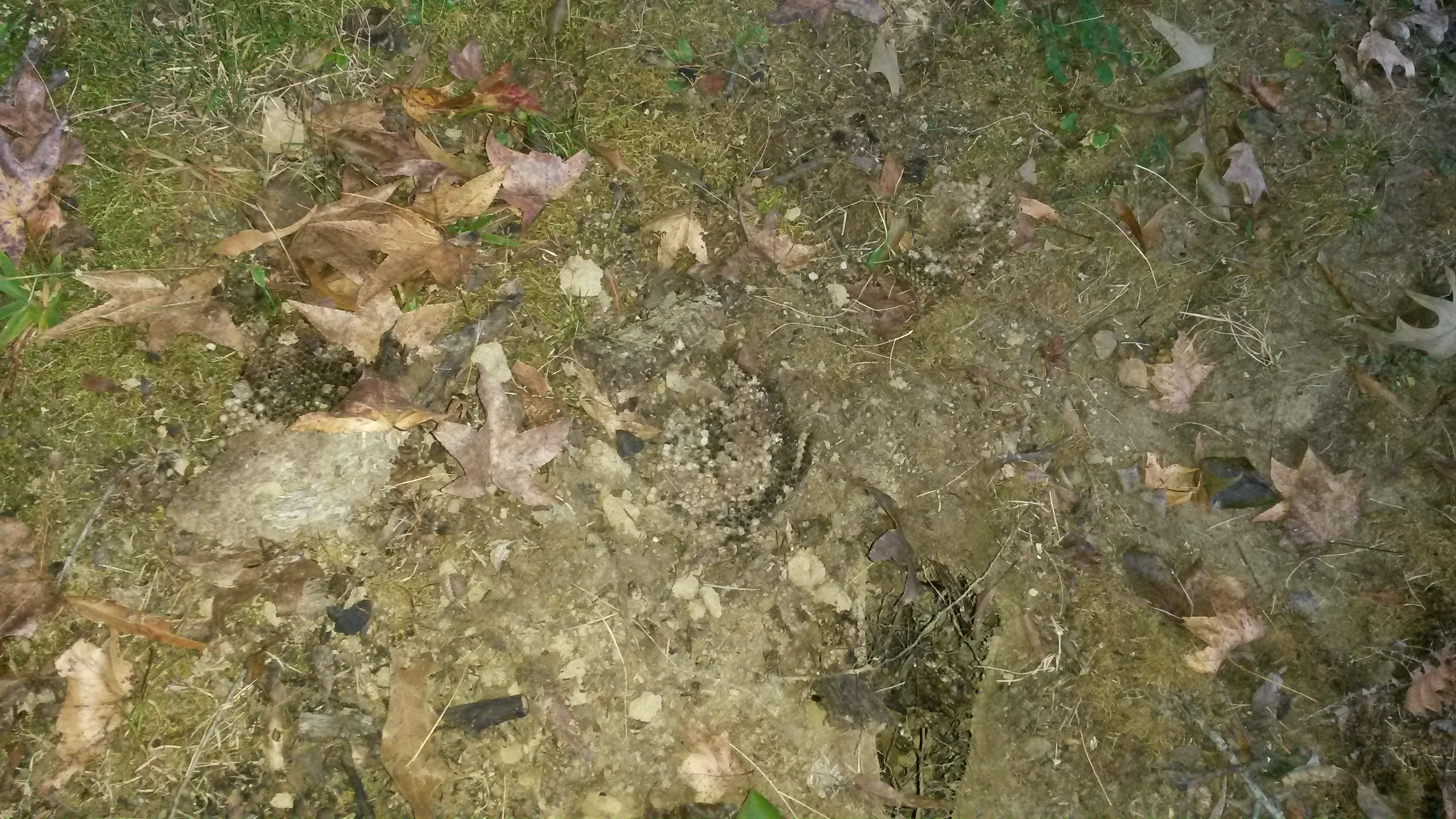

Something dug up the ones I burnt/poisoned. Idk if it was my dog or a racoon. Kinda interesting. 1507525420969.jpg
   / 3038e Brakes and Ground Yellow Jackets #43
There are tasty morsels in there, and would expect skunk or raccoon, or could be even bear, badger, ferret, or weasel..
   / 3038e Brakes and Ground Yellow Jackets #44
Tasty Morsels......You need to consider changing your choice of protein intake. :laughing: :laughing:
   / 3038e Brakes and Ground Yellow Jackets #45
We got raccoons, skunks. Never seen the others. That's why accused raccoons or my dog.
