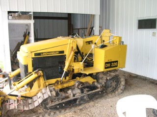

Hi folks. I just was given a DH326ST dozer that the right side track does not drive. I have determined that the axel is not broken and possibly the clutch was stuck or burned out. At this point I was able to free up the clutch and seems to be ok. I was given the machine dissembled down to the axle. I have no manual and have no clue what fluids should be in this machine. I filled hydro tanks with standard hydro fluid (ISO 46) and the gear box with gear oil 80-90wt. Got the machine running but don't have seat yet to try the drive train. Does anyone know where I can get any info/manual/parts for this unit. I know it is Chinese some where 2000 to 04 ish. only 100 hrs on unit.
Thanks Dan
Thanks Dan
Hi Dan,
I have parts and operator's manual for your machine. PM me your email addy and I'll shoot them out to you when I get back to town.
You have the correct oils in the machine so far. ISO AW 32 hydraulic oil can also be used. I use a multi-grade hydraulic oil (ISO AW 32/46/68), it's good for all weather conditions and reduces inventory. Final drives use 85w-140 gear oil, and the engine uses 15w-40 Delo 400 / Shell Rotella, or equivalent.
Keep us posted on your progress.

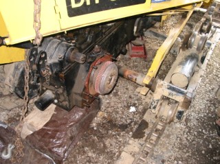

I am working on a Guilin JLW-R2 because it steers great to the right and lazy to the left. I took the plug out on the left side clutch housing and oil came out. The right side was dry. I have the owners manual and it doesnt have any exploded views of the gear box and final drives. Does any one have any pics. Also in front of the gear box there the trans i assume. I put fluid into it and it always empty. No leaks visable . anyone experience this. Thanks
   / 30hp Chinese Bulldozer Parts #39
You need a parts manual, there are exploded views in it.
The transmission and bevel gear case (what you are calling a "gear box") have a common sump. It takes quite a bit of 80w-90 gear oil.
Thought you said "no leaks"? Your left steering clutch compartment is leaking gear oil. It's either coming from the transmission / bevel gear case or the final drive. The final drive should have 85w-140 gear oil in it.
If you have saturated the brake lining with oil, the brake band will have to be relined or replaced, and that is an involved job for the novice.
