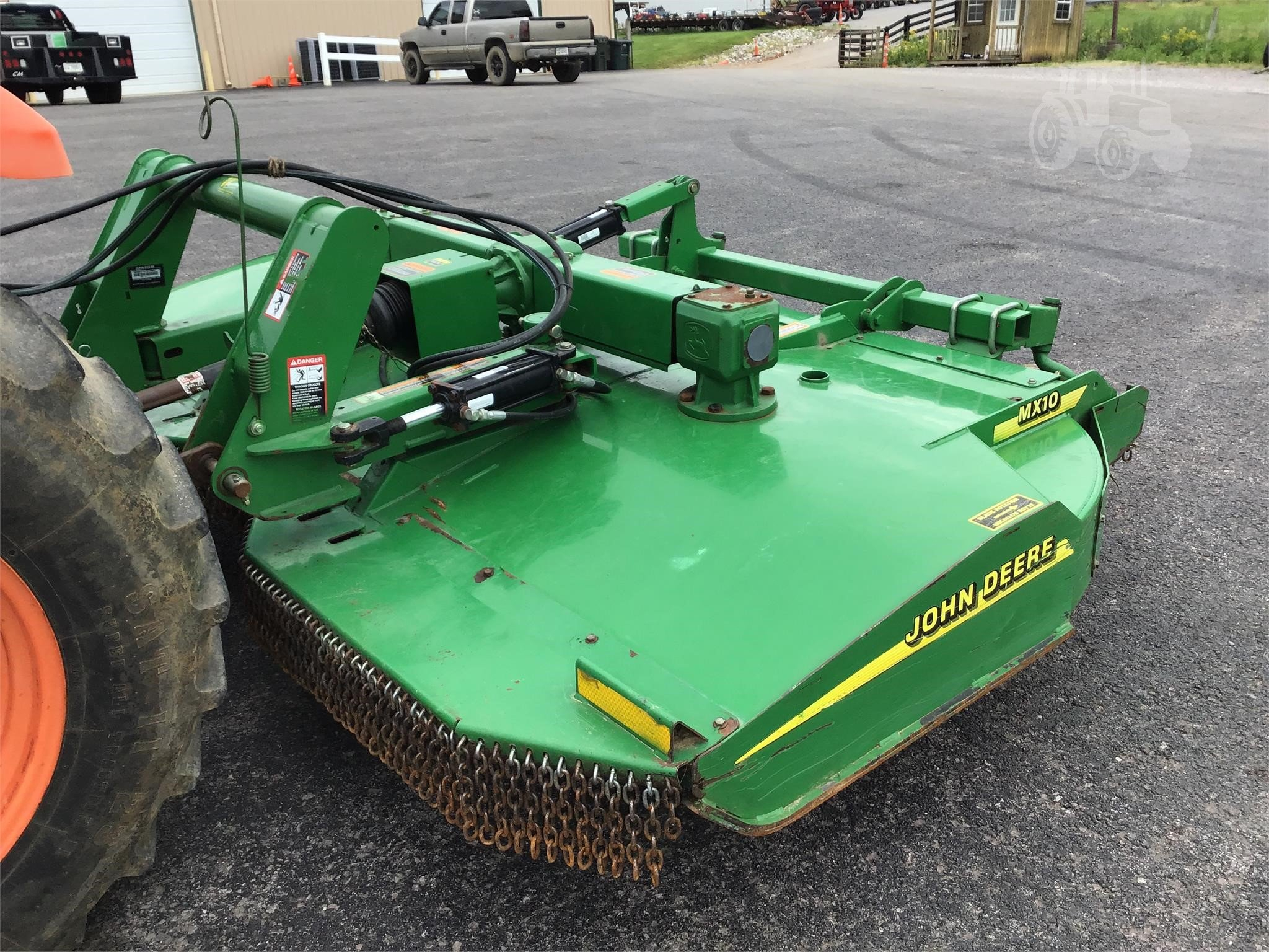

Interesting. Any chance you would have some pictures of this?
Do note there are other semi-mounted implements that attach differently. A semi-mounted implement simply doesn't carry all of its weight on the 3 point hitch and instead uses a tail wheel. There are a lot of plows in particular which are semi-mount and they use all 3 three-point links but have a tail wheel and a cylinder to raise the rear of the plow.
I just learned something new. I never knew this until you pointed it out. Thanks!
