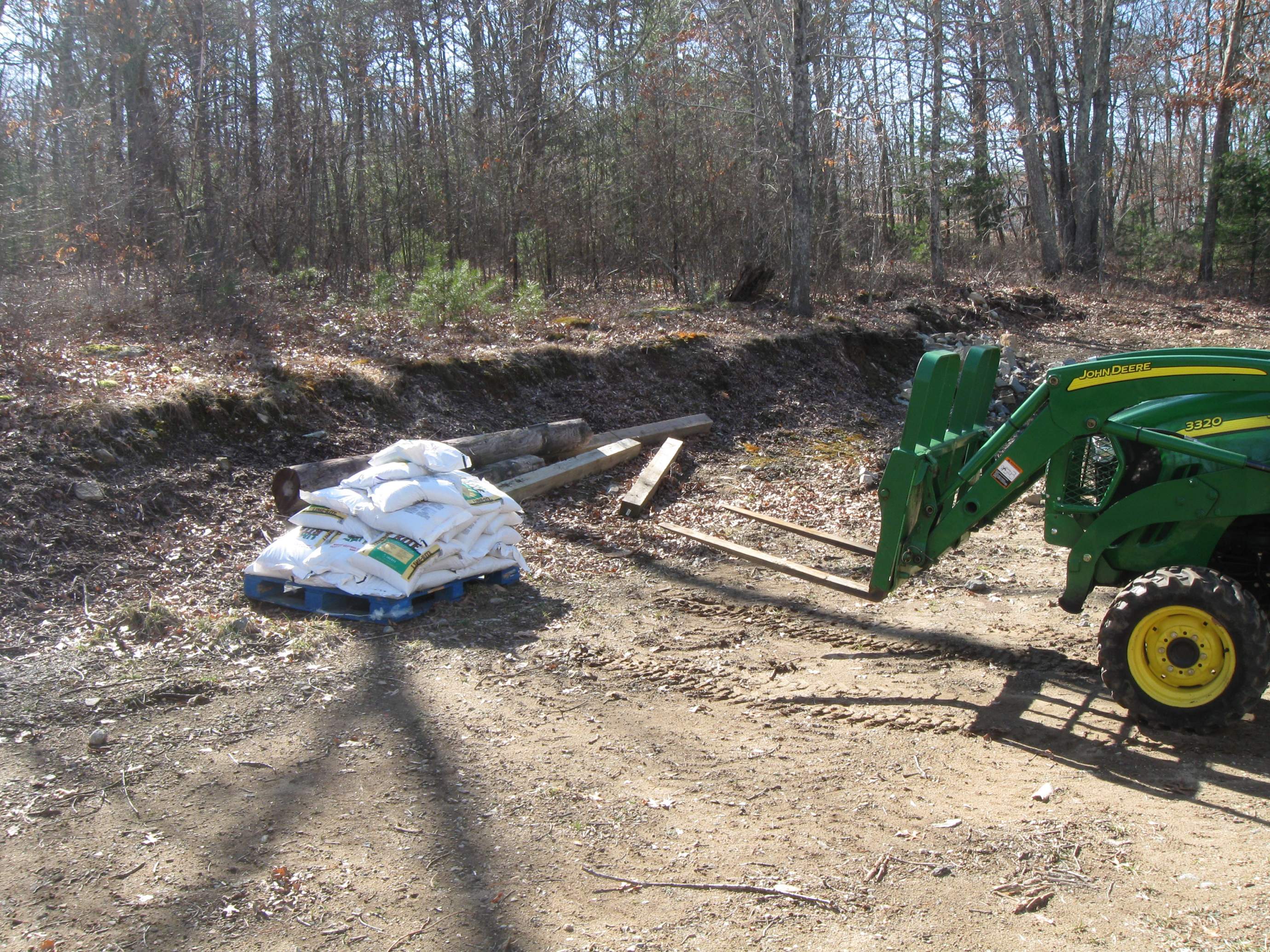

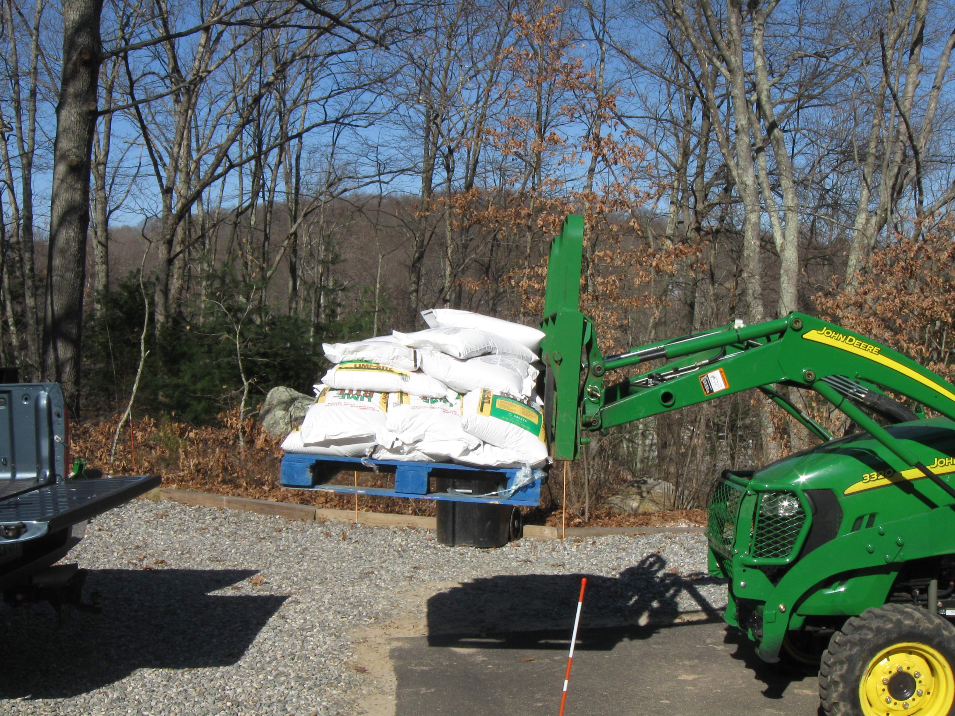

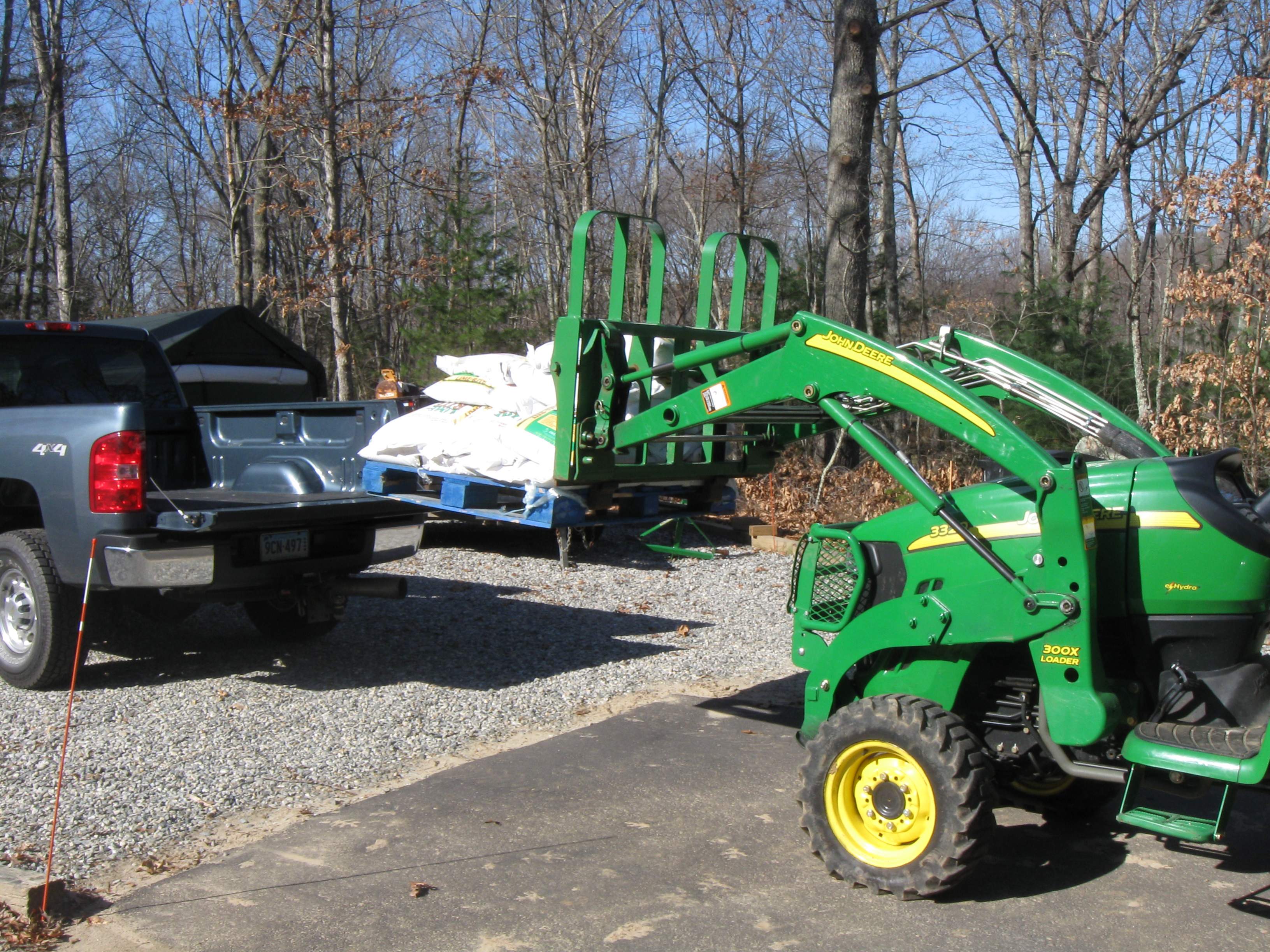

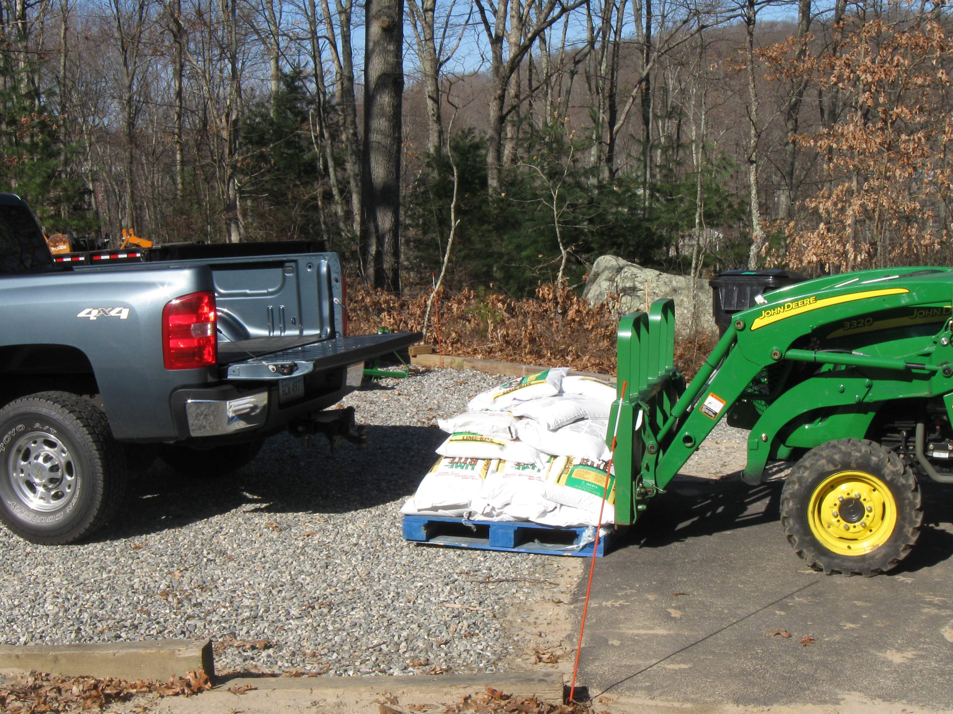

I plan on testing the loader capacity again tommorrow. I'm getting a 1260lbs pallet of pelletized lime. I'm not expecting any issue maybe I'll snap a few pics if I remember.
Matt;)
/ 3320 / 300CX Lift Capacity - Example #7
Please do on the pics.
/ 3320 / 300CX Lift Capacity - Example #8
As promised, I figure the total weight is around 1280. I had no issues lifting the pallet and was able to lift it to full height. This is why I have such a hard time justifying a 110. This 3320 never lets me down and always gets the job done.

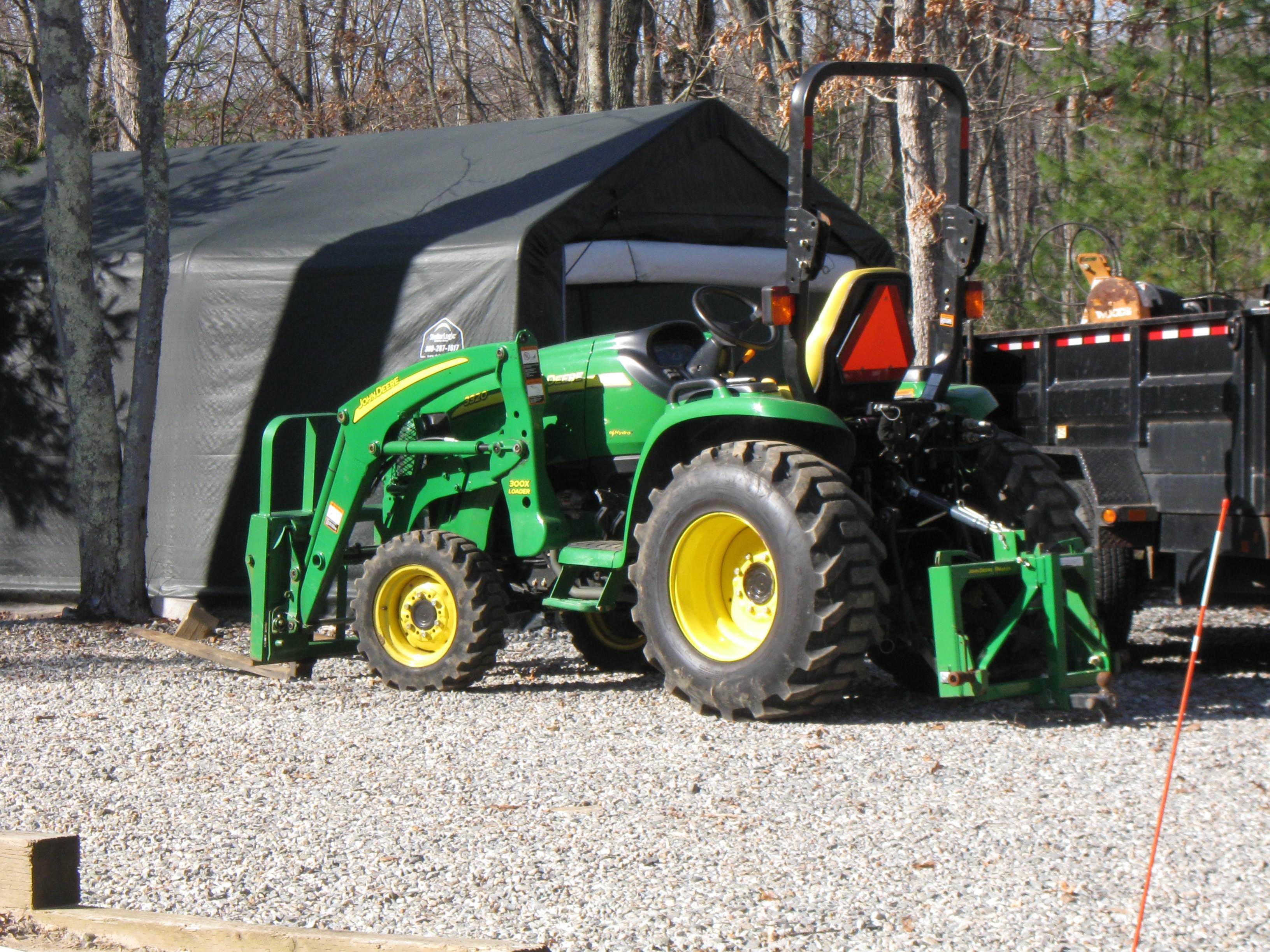

Negative, I had my ballast box on when I lifted the pallet. The pic with the trailer hitch on was awhile later. I've lifted over 2k with my 300x.
Matt;)
