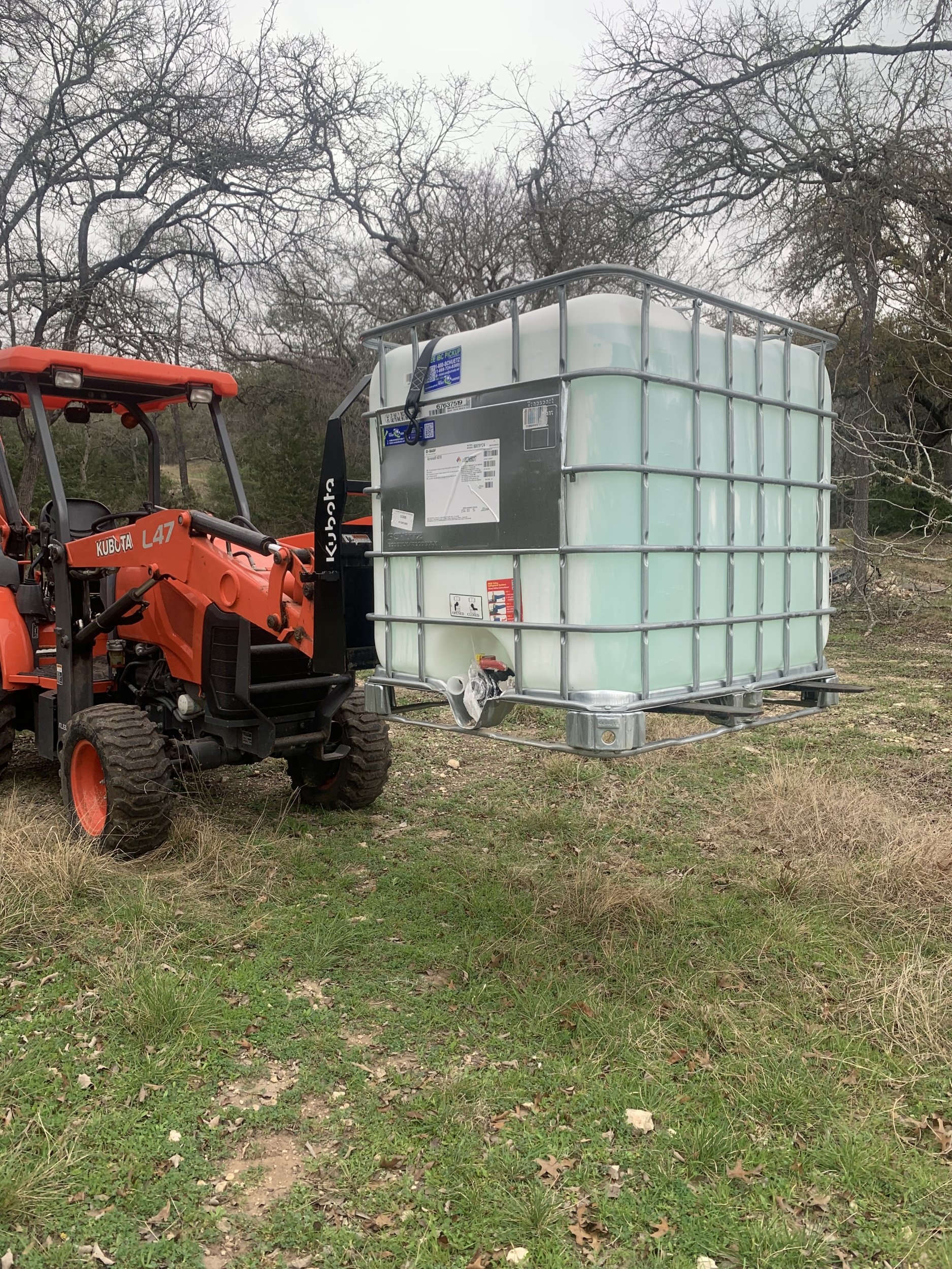

O.K. The results are in. I was only able to lift the 2,330 lb IBC tote using my 412 lb forks (2,742 lbs total) about 3 ft off the ground. Rolling the forks back helped a bit, but I would not want to do that with the load. I could likely get the crate off the truck by slinging it from the forks with the sling loops pushed all the way back, but I would still be stressed until delivery. I decided to just pick up the crate at the local terminal instead.

I had it up at close to 3000 rpm. I agree, I probably could have managed it one way or another as this test was also about 200 lbs heavier than the crate. The problem is that being wrong would have cost me big bucks quickly. The tote was only $75 and nice to have regardless.

If you turn up the pump pressure 100 Psig, it does not hurt anything. Before I installed 5mm larger cylinders on mine, I wa running 3,300 psig. That was bad, but a full 3,000 Psig is fine.

Impressive Lift using SSQA forks. Bucket forks really cut capacity. I have set up my bucket forks so they also can be bolted direct to the QA of the loader, but you cant adjust width when directly bolted.
