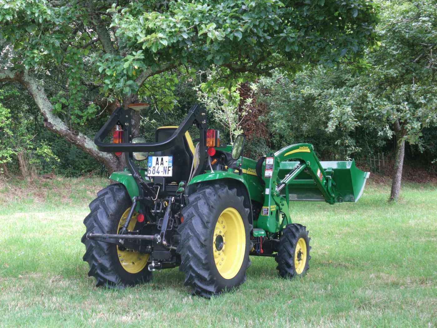

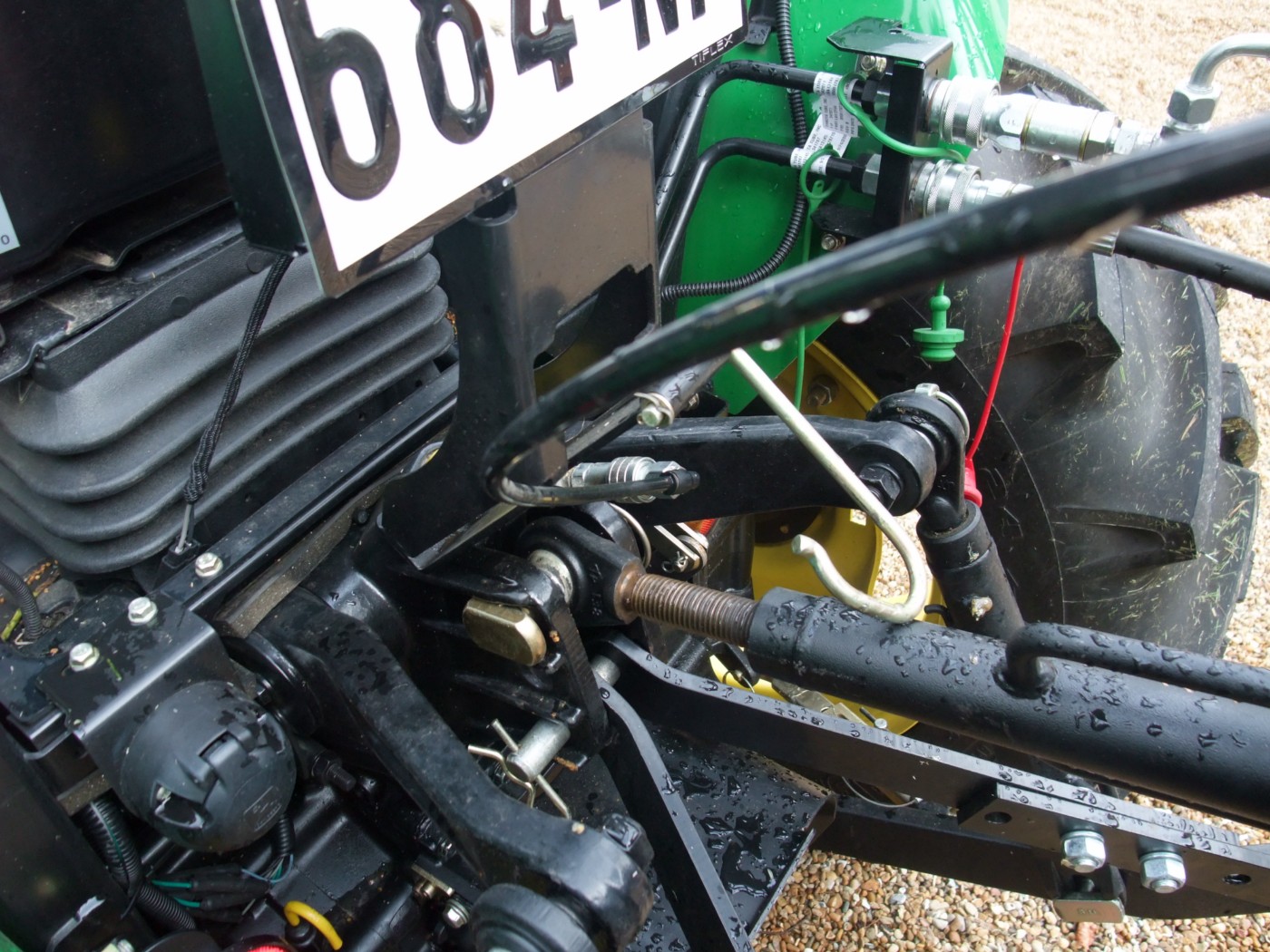

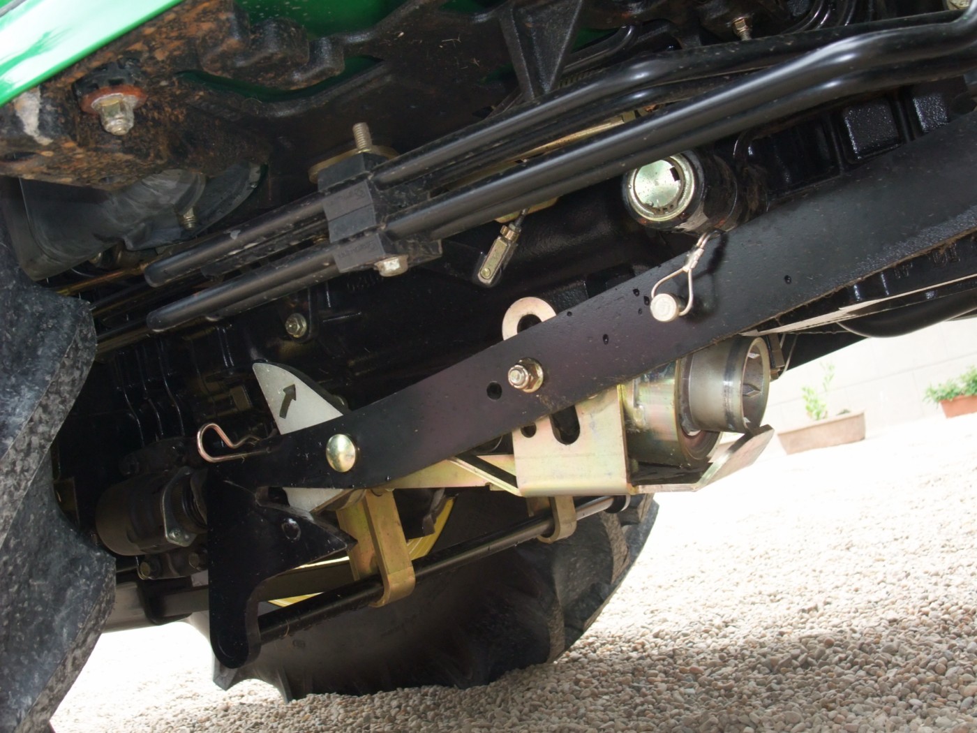

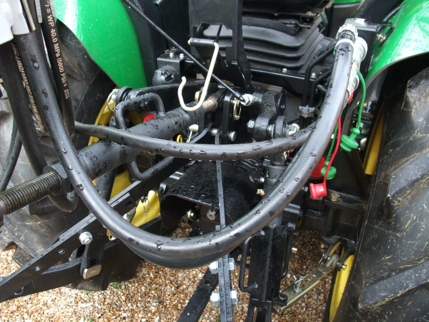

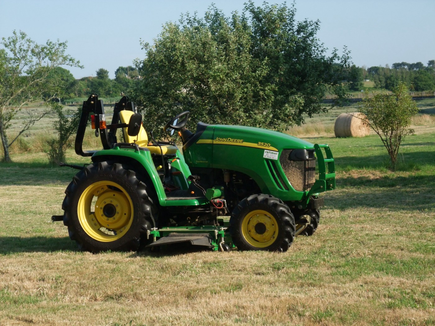

I have nothing against aluminium but where is all this aluminium supposed to be ? Most of the parts I can see tend to rust ...

Nice tractor, love the R1s!
I think they use aluminum on the rear gear reduction axle housings.

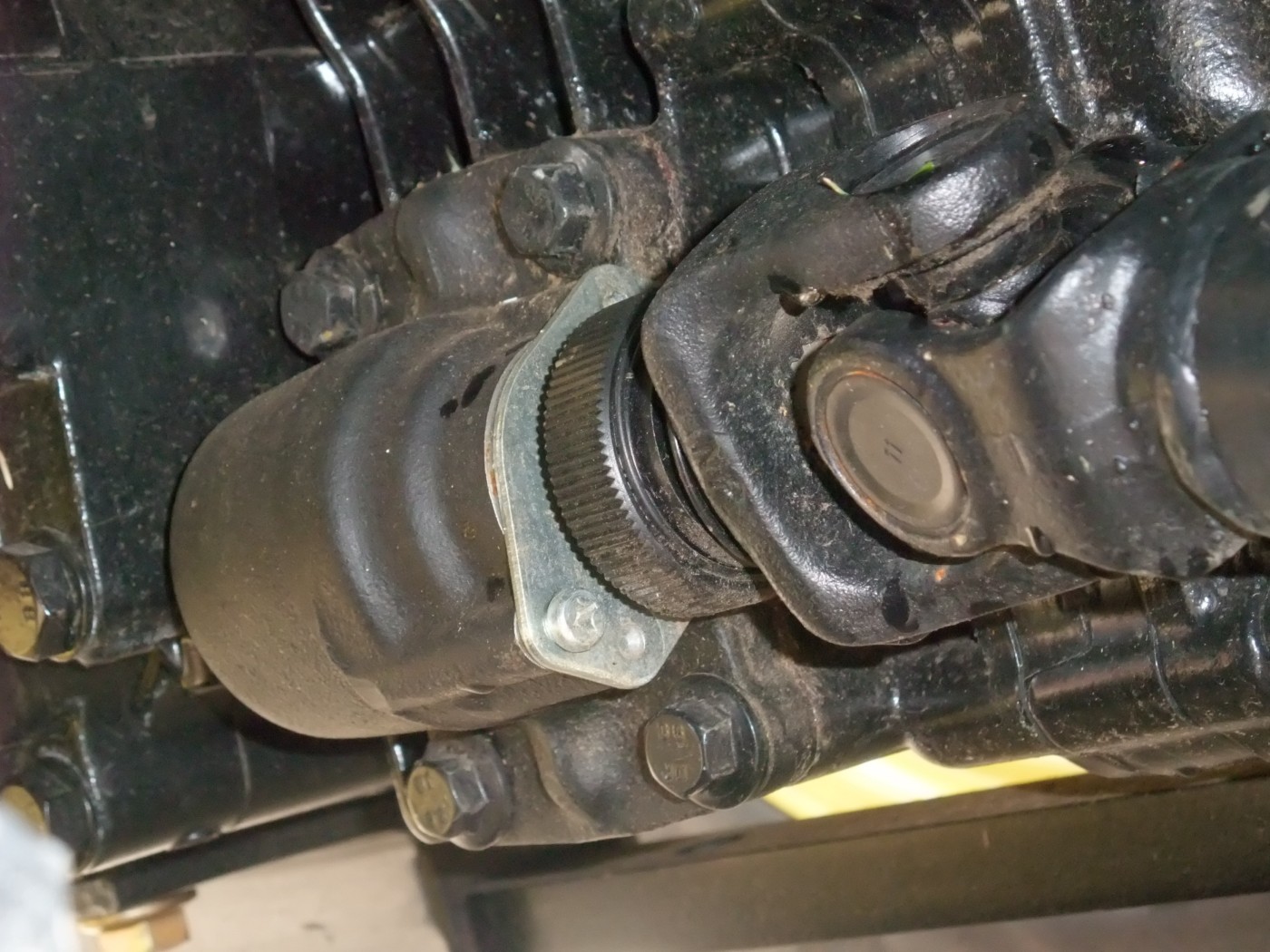

Take a magnet to the rear of the tractor.

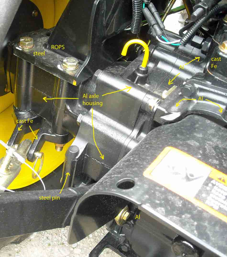

Here is a photo of the rear of a 3520. I have posted pix of the 3120 in
another thread.
I like how JD has beefed up the axle housings, vs. those on the 4310, but
I find the move to more aluminum to be puzzling and troubling. The move
to a cast steel lower ROPS bracket is interesting, but it means that adding
a hoe subframe that welds on there will be tougher, requiring it to be
replaced. The steel pin I noted is grafted onto the axle housing to beef
up the 3-pt arm pivot ears. Very unusual....I wonder how it is attached.
The 3-pt cyl housing is still cast steel and made by HEMA of Turkey. The
toplink anchorage is part of the housing and needs to be of steel. (I see
you have used two of the hole pairs to support your sickle-bar mower...nice.)
Although threaded holes in Al can be made stronger via use of helicoil-type
inserts, this additional process would add yet more production costs.
Thanks for your excellent picture, I won't need the magnet now.
I wonder why they are doing that, I mean mixing steel and aluminium. Especially surprising in a tractor where weight is no problem, we all add weight to get more traction.
The only problem with the back end of the 3x20 I've read about on TBN was with one of the holes for the toplink ripped out. But that is a cast iron part and judging from the pictures it seemed due to a faulty cast, so no real cause for complaint so far.

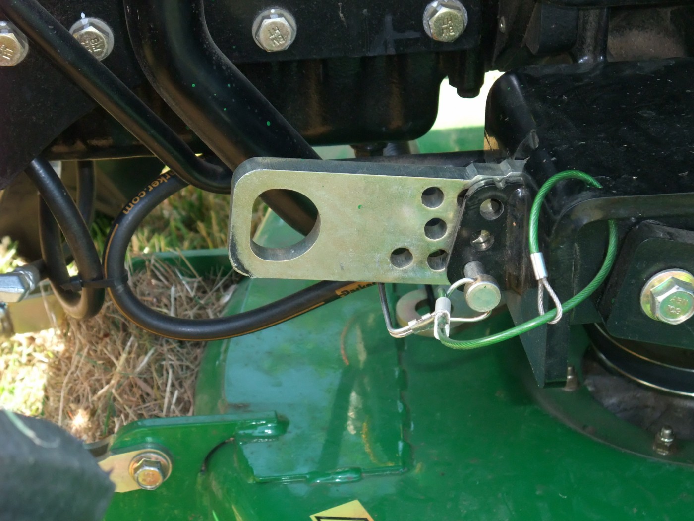

Phillipe,
Which mower are you using on your machine?? I really like the R1 tires but was under the impression that many of the JD mid-mount mowers were not compatible with them. Have you found your R1 tires to damage your lawn or do they do well for you?? I think my next tractor will have the R1 tires if I could make sure the mid-mount mower I would want would be compatible.

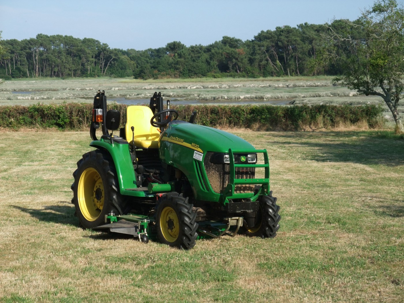

John M

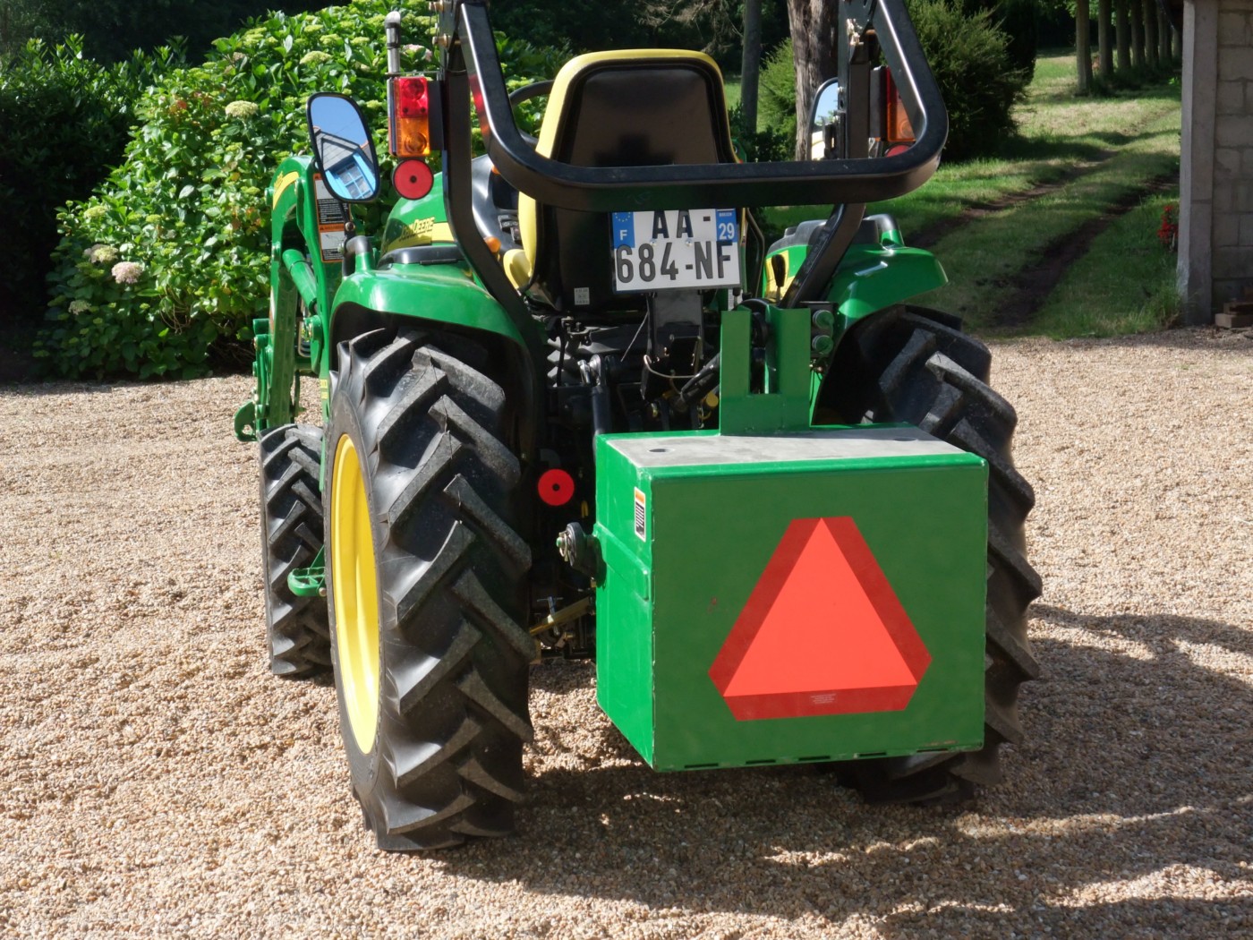

I use the 60 D Autoconnect, but could have used the 72 just as easily. They are both totally compatible with R1s, the only difference is you won't raise the deck as high when not in use, but already plenty of clearance.
I wouldn't really call it a lawn ... In fact I had 2 Massey 35s 2 WD with R1s and hardly ever damaged the turf. The Deere 3520 is harder on the grass, especially in 4 WD, the front tires are responsible. I have learnt to avoid 4WD and sharp turns around the house and the tire marks have disappeared.
