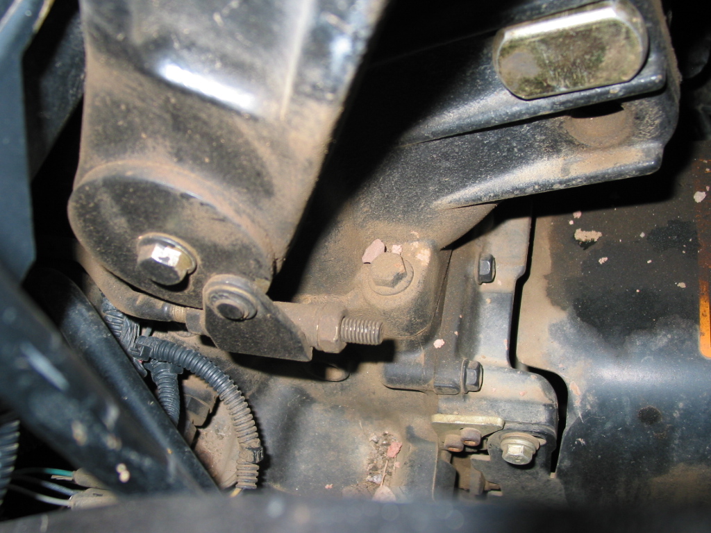

A simple rockshaft adjustment will resolve ........ see this thread http://www.tractorbynet.com/forums/...g-3-ph-485-backhoe.html?highlight=485+backhoe
Does this adjustment work for the 3320? I've tried it and no-go, but maybe I'm doing something wrong. If any 3320 owners have a 48 BH and have been able to adjust the rockshaft, I'd love to hear how you did it.
My 3720 has the adjustment rod on the left lift arm like my 4320. I'd be surprised if the 3320 is not the same, but ......... let's hear it from the 3320 folks that have a backhoe.

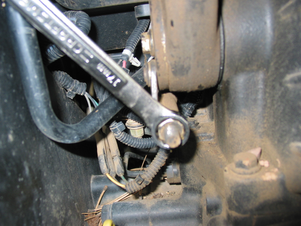

Here's a couple of pictures to make the adjustment.
Loosen both nuts , run engine and make rockshaft raise a little higher.
I did mine in Jan '08 right after I got the 447 installed by dealer, I couldn't get it off via rockshaft only. :mad: Can now. :thumbsup:
I had very similar experience. The 3320 rockshaft adjustment looks just like a 3720 rockshaft adjustment. I only had to turn mine 1/4 turn to get the two top pins in. The dealer cautioned about adjusting too far as damage could occur at the end of the stroke.
   / 3320 with a 485 BH #26
Superexcellent - I can hardly wait to drop the BH to try it. Thanks!
