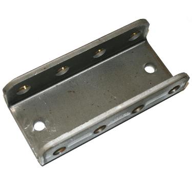

Rob, when you get your new toy be sure to post pics of the thumb. So far know one has had pics and JD only shows a drawing not an actual pic. I've told my dealer to call me as soon as they have on in. I'm going order one for my 448 and fab my on positioning bracket.

He's correct but not due to the bucket. The 2010 485 has holes on the dipper to pin the arm of the thumb, to fix it's position. He may be refering to the teeth of the bucket an alignment of the thumbs teeths. But that's not too big of an issue. I've been waiting to add a thumb on for some time, but I really wanted a pin on thumb because of the stength and geometry. I've already talked to my dealer and looked at the pins. The pin for the thumb is the same just longer with a few more shims.

I'm going to use 2"x2" square tube, I'm thinking my design will be stronger than the factory setup. But I'll reserve judgement until I see a real one not an illustration. I've been planning on ordering the thumb since it was first announced. I've been toying with using the adjustable hitch for a trailer as my mount. Like this one, but I would add flat stock to it to distribute the stress. It will be welded by a pro also.

I used a 1" stainless steel pin for the positioning arm, so the hitch base might be on the small side. Stainless to avoid rusting (PITA to attach/reattach) and pretty hurky to take abuse.
Was cautious with too thick a base plate as it could warp the dipper with the necessary heat to weld the plate to the dipper. Think it was all 3/8".
