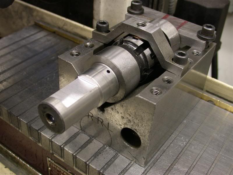

GuglioLS said:
What a cool positioning jig you've got there. Funny, I don't remember seeing one of those in Rob's assortment of stuff.:)
