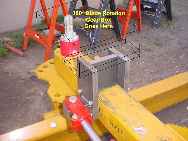

Here's the progress report for work I completed this weekend -
The swing offset cylinder mount is done. It's an integral part of the Gear Box mount system. The steel used for the mount is 3/4" x 4" wide hot rolled flat bar. It's attached to the blade boom with four 3/8"-16 SHCS (socket head cap screws). The gear box Rob Machined and fabricated for me, should arrive sometime Monday 4/2/07 :D
This picture shows the cylinder mount and an outline of where the gear box will rest on top and be attached to it.
This 23 second video (2.1 meg) shows the swing cylinder in action:
This is a much larger 59 seconds (5.3 meg) video. showing the Swivel, and Top & Tilt.
The plan is to get the gear box mounted, hydraulics connected, then performance tested this coming weekend. I can hardly wait.

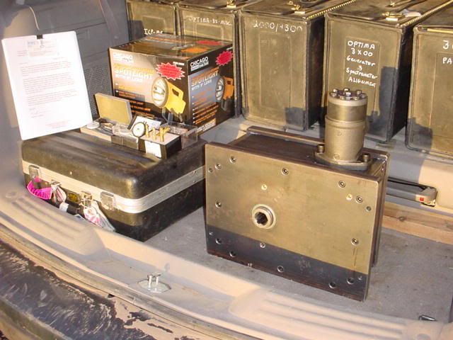

I removed the shrink wrap Rob put on there - man he used lot's of that stuff - it was tough to get off. Then I cut the banding and muscled :p the gear box off the pallet into the back of my van. Rob was not joking, that bugger is H-E-A-V-Y.
Here is a shot of the gear box ready for it's trip home. My van was doing wheelies all the way ;)

You guys have unbelievable skills. I wished you loved near me and were both my friend!
I must be missing something though . . . I looked at the movie of the blade and it looked to me as though the blade swung through a wide arc, both directions (I guess with hydraulic cylinders since the gearbox wasn't installed yet). What additional functionality will the gearbox provide that the current range of motion can't handle?

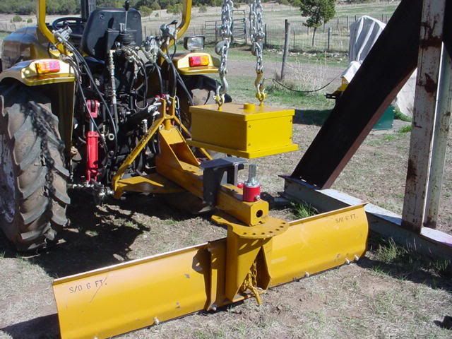

WELL here is the latest good news -
I had NAPA make me up some paint to match the Leinbach yellow. Turns out Komatsu dozer equipment yellow is a very good match. Also looks very close to Cat yellow :)

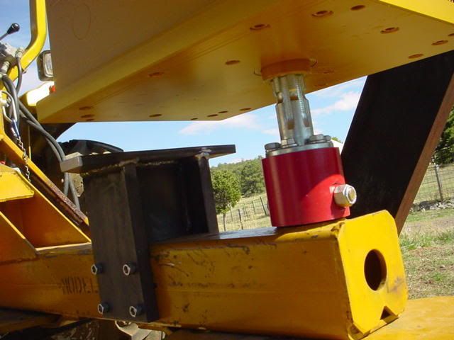

I got the Gear Box suspended in the air on my chain hoist and painted it. Then centered the Blade PTO coupler shaft under the gear box then proceeded to lower it into place with the chain fall:
When I got close to the shaft all I had to do was rotate the blade by hand a little to get the splines lined up, then lower the gear box a little at a time:
Larry
   / 360* Rotating Back Blade Project
#129

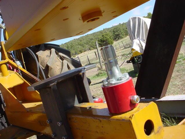

I continued to lower the gear box so that the PTO coupler was engaged and not binding :

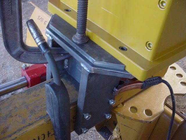

Guess what ? All the holes lined up :cool: How could this be? This is going much too smoothly :confused: I bolted the Gear Box to the bracket I made with two 3/8" SHCS that Rob provided to me in the care package. I doubt those two little screws will hold all the rotational torque. SO Now it's time to add a plate on top of my bracket and push it up against the bottom plate of the gear box to prevent those two little 3/8 screws from shearing off:

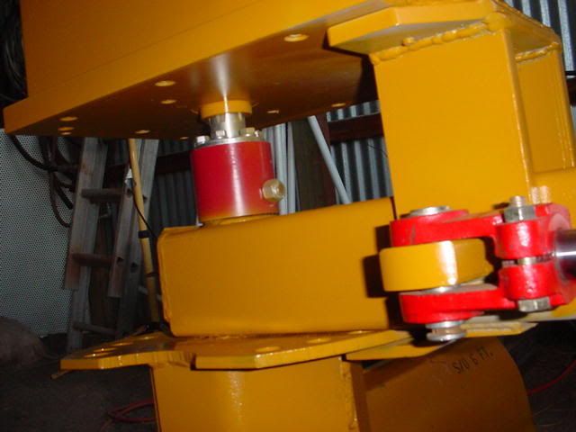

After welding and cooled off, I painted all the brackets:
Here's another bottom view showing the coupler completely engaged:
Larry
