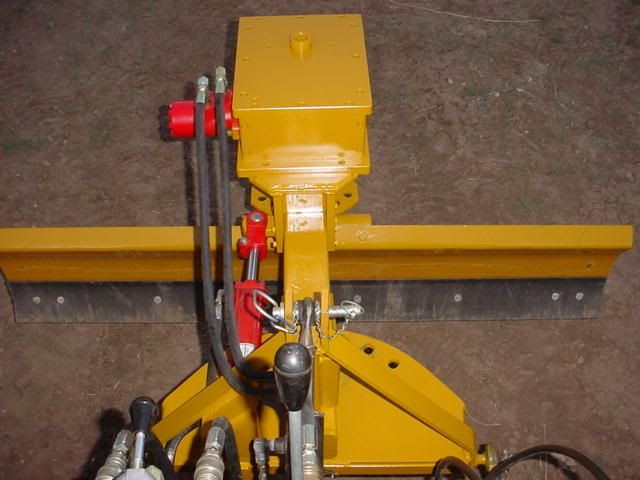

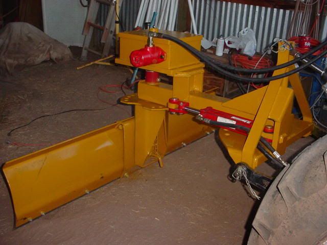

All the painting is now complete. Then I installed the Motor & hydraulic lines with quick connects to my Joy Stick valve I have on the back of the tractor.
Side view:
Back View:
Tractor Seat View:

Because I have installed hydraulic priority flow dividers, I can set the flow rate of the hydraulics. So that the speed of rotation and swing offset is just right (not to fast & not too slow).
I am able to control speed of swing & rotation to whatever I need for the task at hand. All without leaving the seat!
One more major bracket needs to be added to the rear of the Gear Box to completely support it. I will do some REAL dirt moving to check it's real life performance AFTER that bracket is fabricated and installed in place.

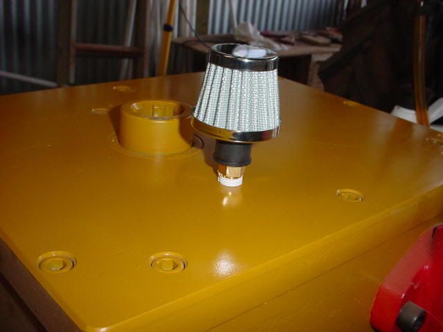

Oh almost forgot - I filled the Gear Box with 6.5 quarts of 85W90 gear oil. Rob, drilled, tapped and plugged (with nice brass plugs I might add) several fill (and drain) holes that are conveniently located. Rob made this thing so well and with such precision, there are no leaks!
I used one of those hand pumps attached directly to the jug of gear oil:
And added some *Bling* in the form of a chromed air vent:
