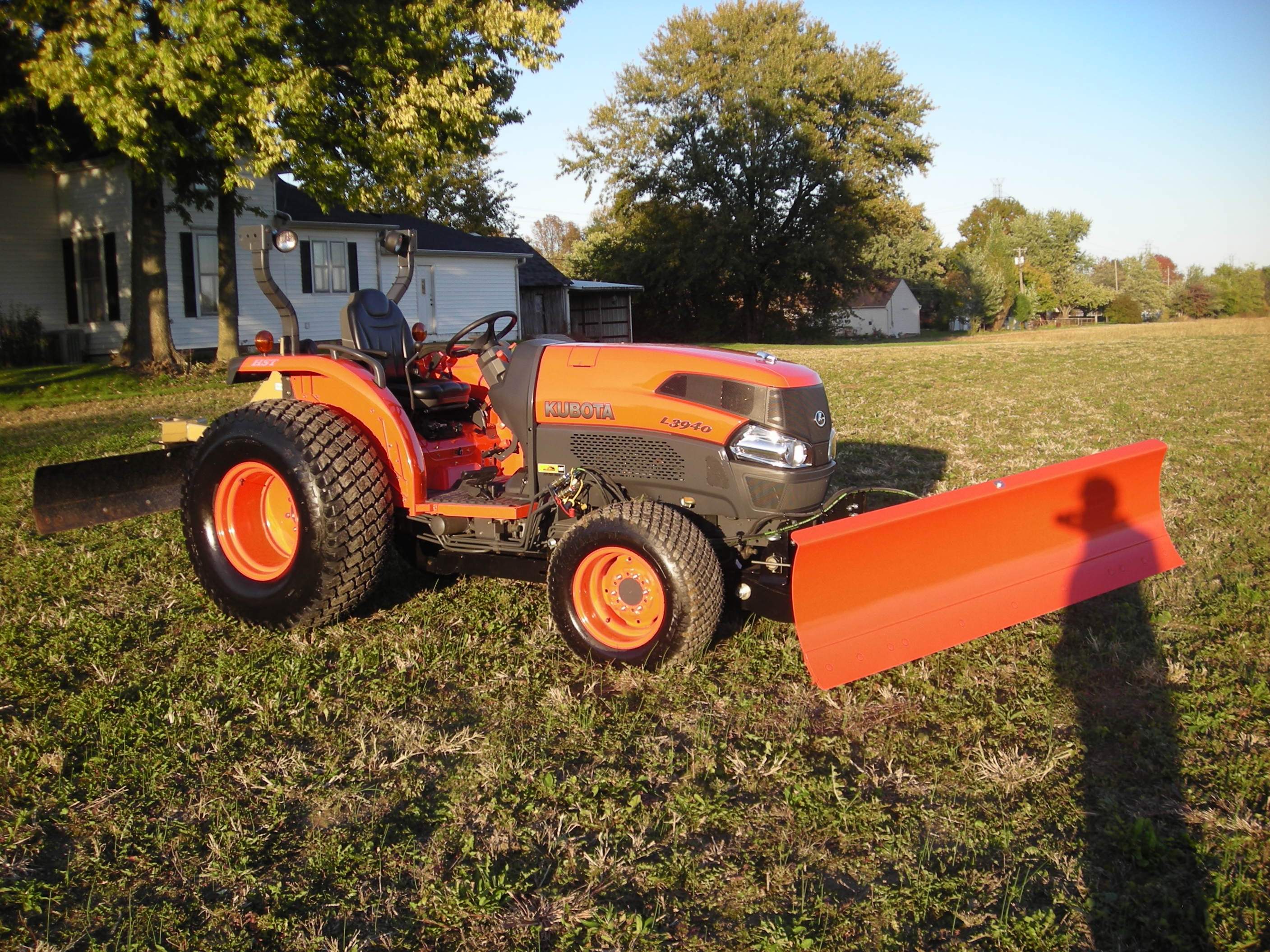

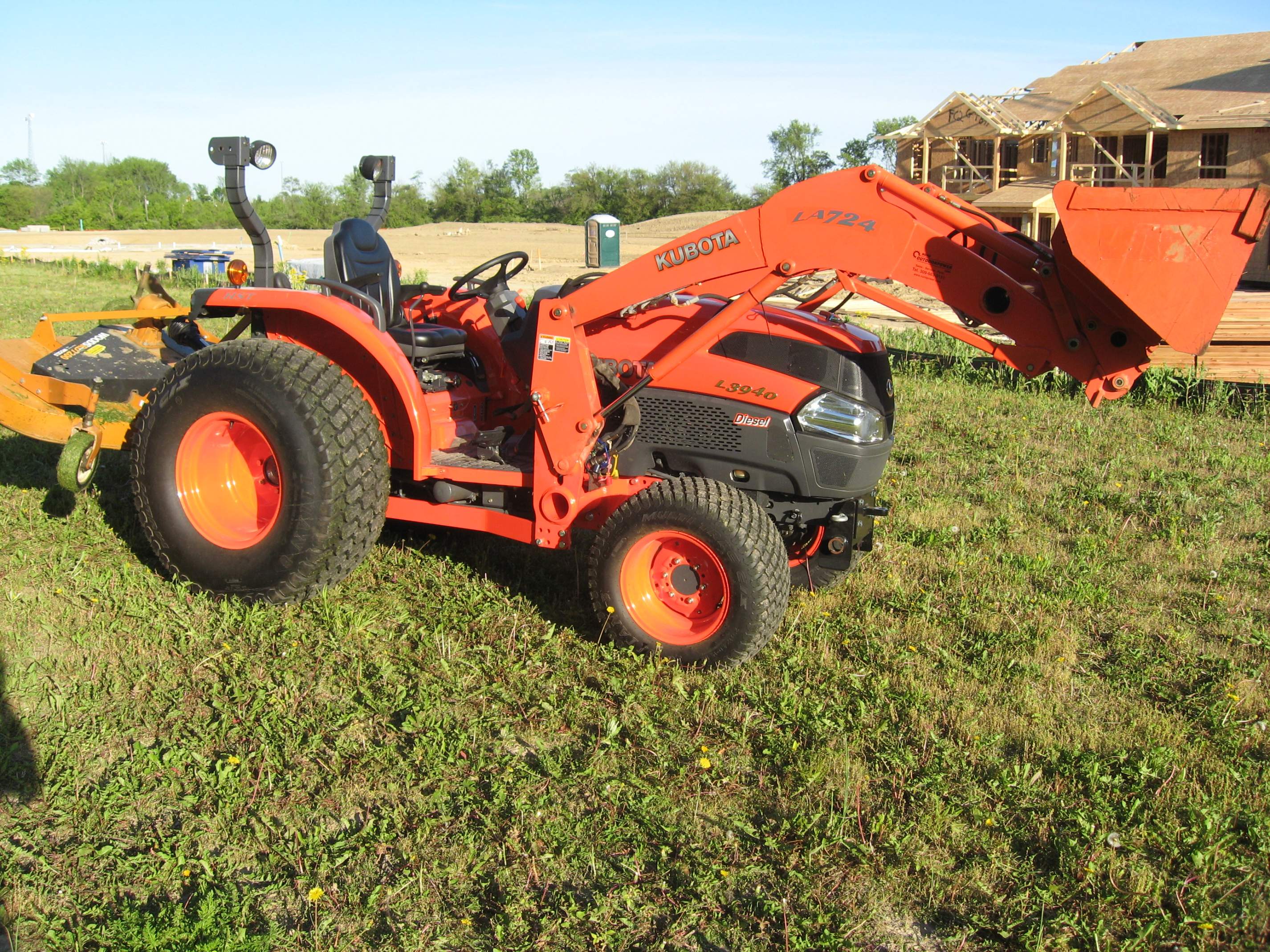

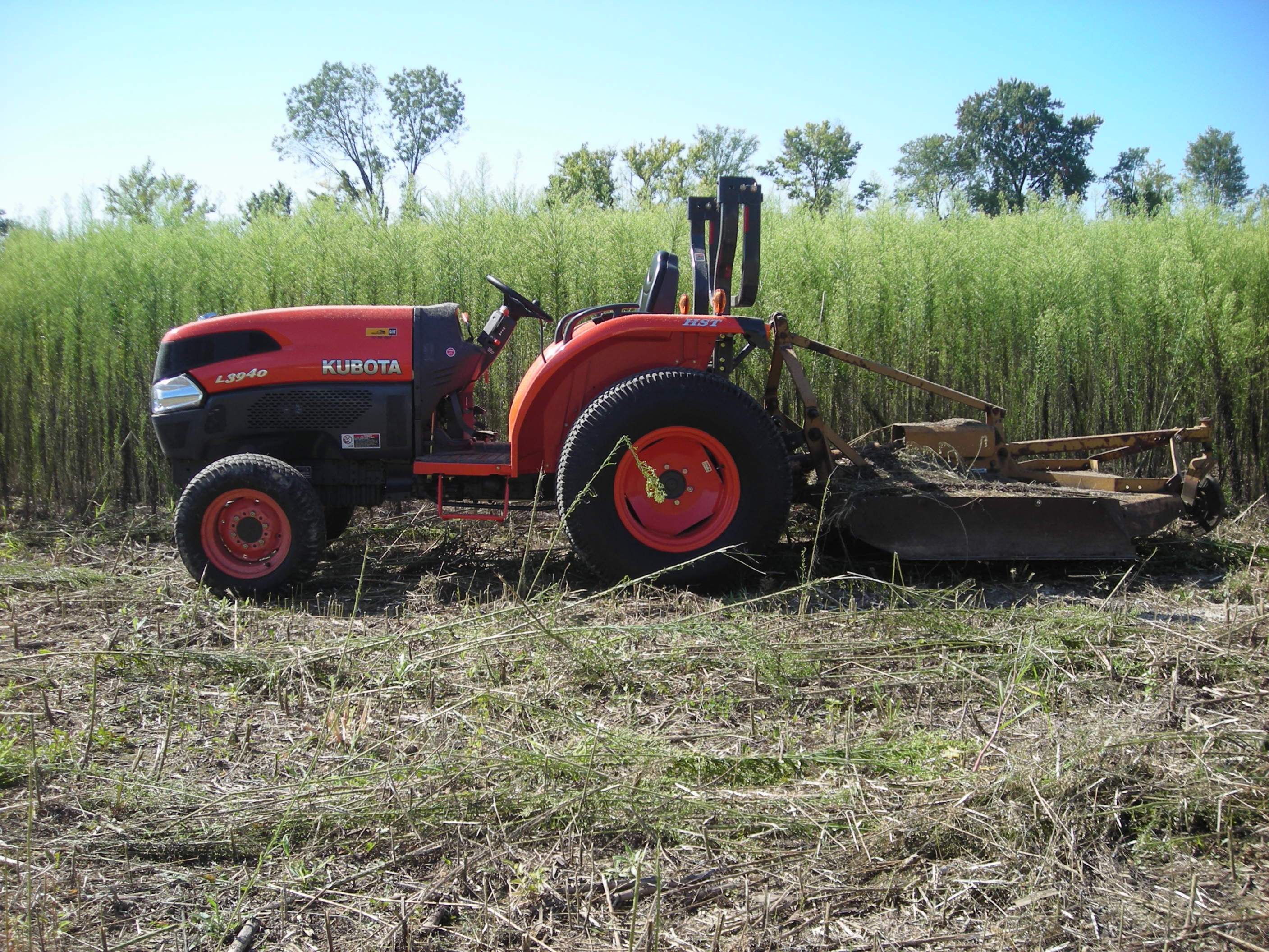

If your stuff can get 4' tall and your cutting with a 6' hog I would not want to get anything smaller than a L3940. For long runs of mowing, the cruise control is very nice on the HST+. I also like the auto-throttle when doing loader work. Looks like we have similar duties, except for the snow blade. Here are a few picks of the L3940. Philip.
