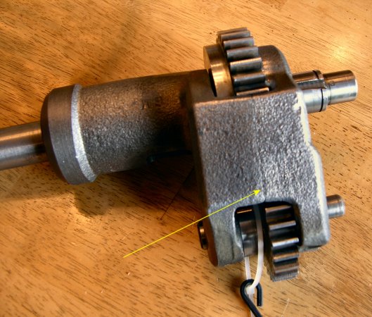

The main reason we decided to disassemble, rebuild, and repaint the lathe was so that we would know if it needed attention before we started using the lathe. This way we could take care of all minor problems before they damaged other parts beyond repair. This casting is an internal part of the gearbox and after a close look-see we spotted a hairline crack in the casting at the point of the arrow.

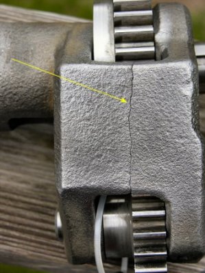

Look closer at this macro picture and you can now easily see the break in the casting. This is not just a crack as we originally had thought, After disassembly we find that the two shafts that are a part of this assembly were actually the only thing that was holding the two pieces together. /forums/images/graemlins/frown.gif
Since there is very little stress on this assembly I will most likely make a repair by brazing this piece over the weekend. I'll take a closer look at it at that time and post another picture after the repair has been made.

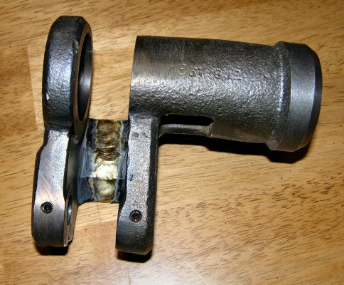

Well more rain today in Ohio, not much one can do outside in this weather and since the garden is a mud hole we headed back to the barn and made a bit more progress on our project.
We kept the broken gearbox casting loosely assembled to keep it in alignment while we laid the brass to it on the outside of the casting. Then we disassembled the shafts and bearings so we could braze it from the inside as well. I believe the casting is most likely now stronger than it was when it was new. I'll hit it with the POR-15 epoxy tomorrow before it's reassembled and put back into the lathe gearbox.
