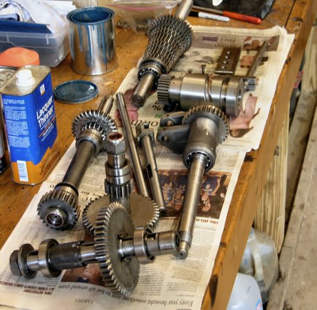

Here's a shot of just a few of the parts from the gearbox as they are being cleaned and inspected prior to re-assembly.

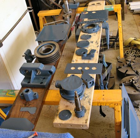

As the smaller parts are spray painted they are placed on this makeshift table until the masking tape can be removed and any over-spray cleaned up. The painted parts seem to be never ending.
