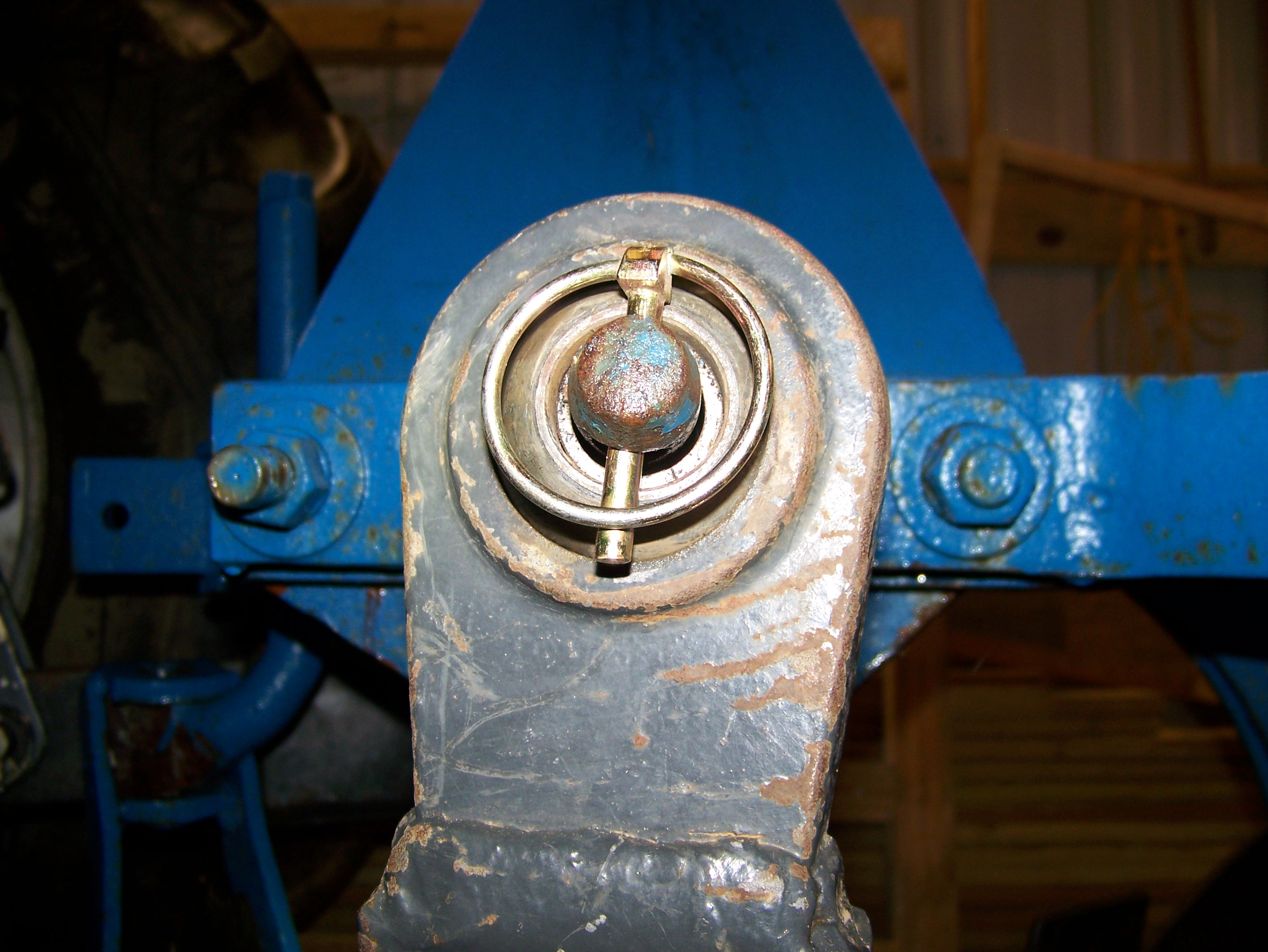

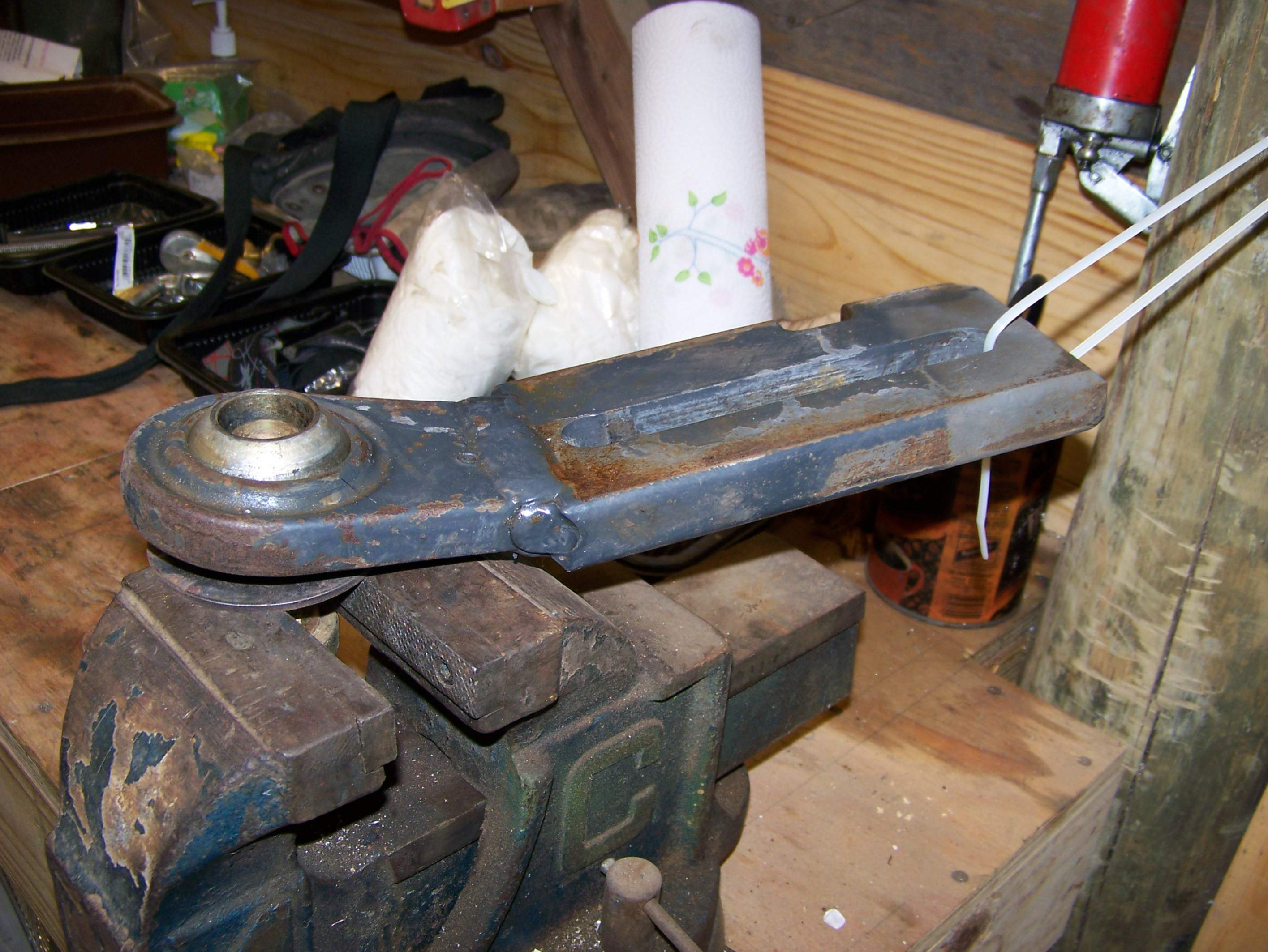

I picked up a longer Cat 1 hitch pin at TSC. It is the bolt on kind. I just might cut the threads off and the plow's pin off and have it welded on the plow. But first I am gonna skillfully radius the shoulder of the plow's pin and also put a concave radius on my Cat 2 swivel ball. It will be raining this weekend and this will be a fine out-of-the-weather job. Photos coming.
hugs, Brandi

That should get you enuf room to use the lynch pin. From pic it doesnt lack much.

I took the end of the left lift arm off today and ground down the ball. I didn't grind off much material. I now have enough room for a 3/16th inch quick lock pin. I would prefer a 3/8th inch quick lock pin, but I can live with this. Mahindra Lift Arm On Ford 101 Plow.jpgMahindra Lift Arm Ball Getting Ground Down.jpg
hugs, Brandi
