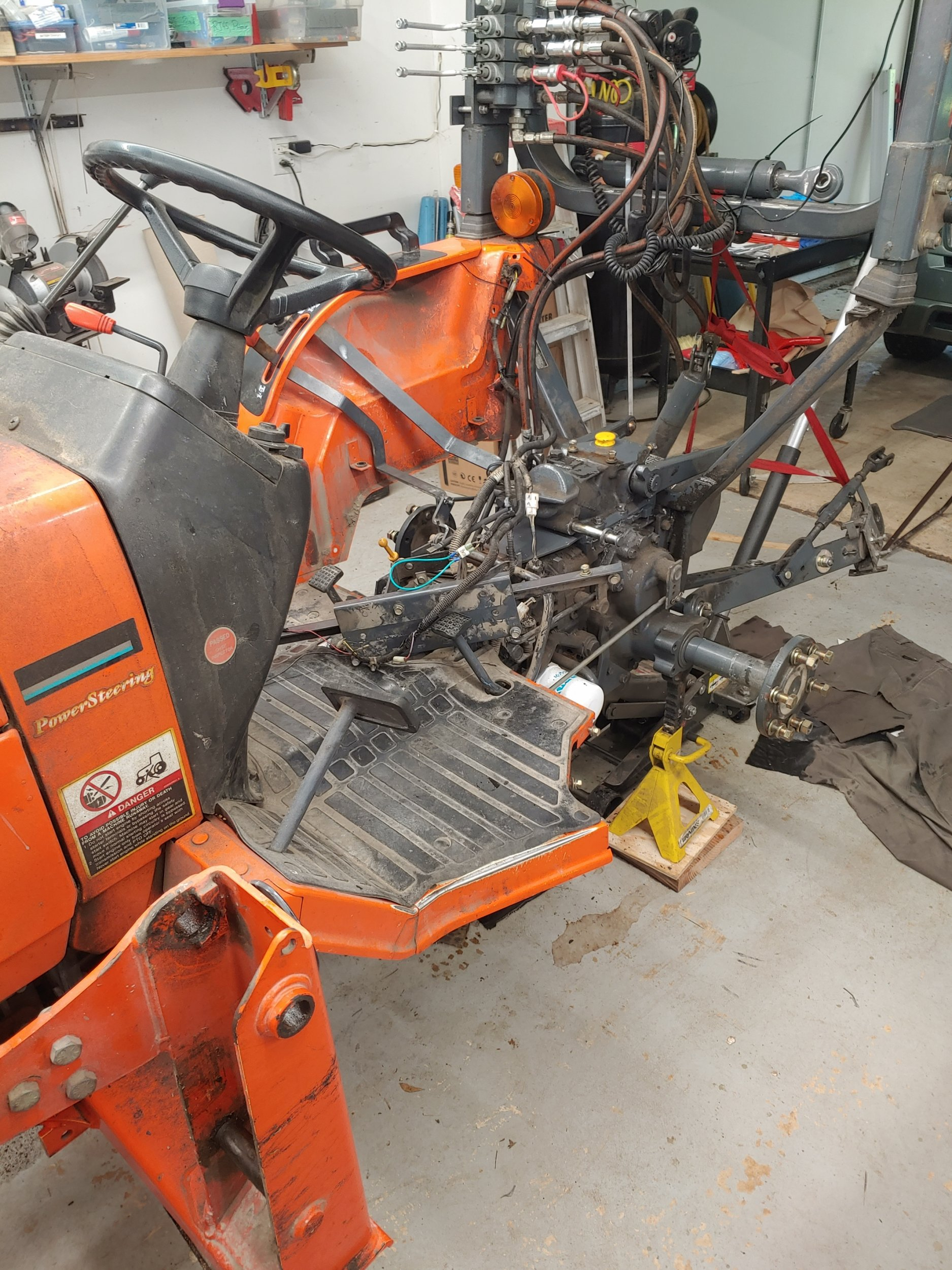

Found one more thing I found, something penetrated the side of the differential case and made two holes into the gear case area. Here's a photo. I cleaned up the edges of the holes, I'm just going to leave it as is. Those two cases share oil anyway, so I don't think the holes will hurt anything. I looked at the price of replacing that case, wow. I'd spend more than the tractor is worth trying to make everything perfect again. The shrapnel from the holes was lying on the bottom of the case, hopefully things didn't migrate around too much in the oil.
Round those holes out. Cracks love corners.

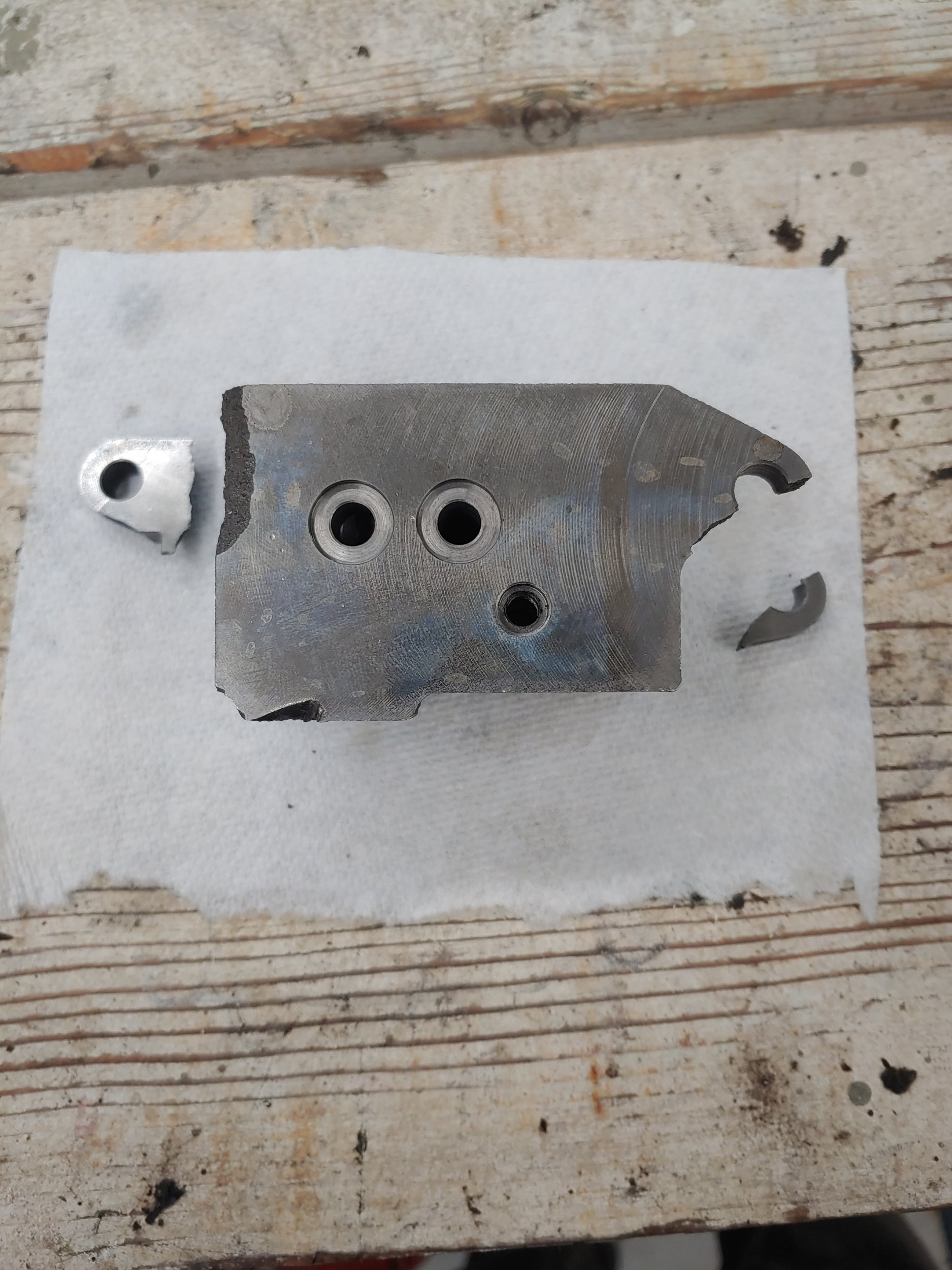

Got the parts from Messick, put it back together far enough to test the 3pt. Seems to work properly, it can lift my sorry ass. So far I'm into this for $500 in parts and $100 for fluid. I won't be able to test the clutch until I get it back together in the next day or two.
Here's the control valve with the broken pieces retrieved from the bottom of the case. Had to buy the new valve and the spool as an assembly, they don't sell them separately. That was $350, the most expensive part. Had to put the old one in the oven for an hour to get it hot enough to get all the plug screws out of it. Should have ordered new ones, would have been a lot easier.
