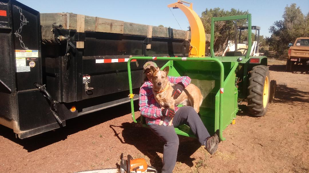

I have a Wallenstein BX42 with hydraulic feed - bought it around 20 years ago. Originally had it on a JD770 and it did fine chipping any solid larger wood with any size to it. I did have problems trying to run leafy and small diameter items through. if you ran a 3" item through it, it would chew it fine until you got to the very top. when you have nothing but leaves and 1/8" twigs left it had issues. instead of taking small cuts it would end up letting the twigs get through the hole in the flywheel where the blade is, and they would end up getting cut to 4-6" length. those short twigs would then rattle around in the out feed chute and make a rats nest at the plate where the chute can be rotated. the next items through would then pile up against the rats nest and it would bring everything to a stall if you didn't disengage the PTO quickly. Leaves would do the same thing - not enough mass to be pushed out quickly and they would flutter around and eventually nest up in the same spot.
I attribute a lot of this to the chipper not creating enough vacuum to push the light items through. my solution was to not let it get to just a top with twigs & leaves. when i got close to that happening I would make sure i stuffed another 2-3" minimum stick in, so it was creating good sized chips that would fly through and bring the twigs & leafy stuff with it. that helped a lot, but not a guaranteed way to avoid all plugs.
I upgraded to a JD 3039R 4+ years ago, and I haven't even converted it over. i have not had any need to chip since then - well, I do, but I have not had the free time to chip anyways. Maybe this tractor with power to spare will generate a more constant speed and airflow, but I doubt it. Maybe I can adjust the knives to help, but again unsure when it comes to leaves. The one idea I had, but never tried was to bolt on some rubber flaps to the fins on the flywheel to maybe make more airflow?
Again, if i were chipping slabs or straight pieces of round wood, it'll eat that all day long with no issue.
One more thing I will add If you have not compared the feed vs. no feed side by side: no feed options will have the in-feed chute angled more vertically so gravity helps you. Hydraulic feed has the in-feed more parallel with the ground. this means you can take a 20 foot piece and drag it in and walk away. with a gravity feed hopper you'll likely need to chunk up your pieces into shorter lengths to drop them in.
