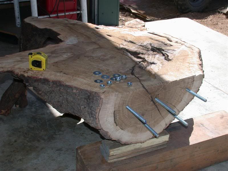

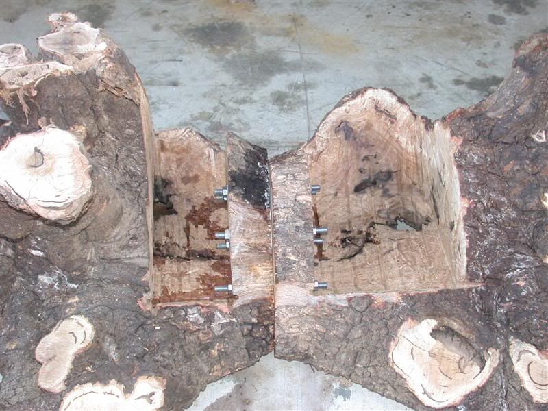

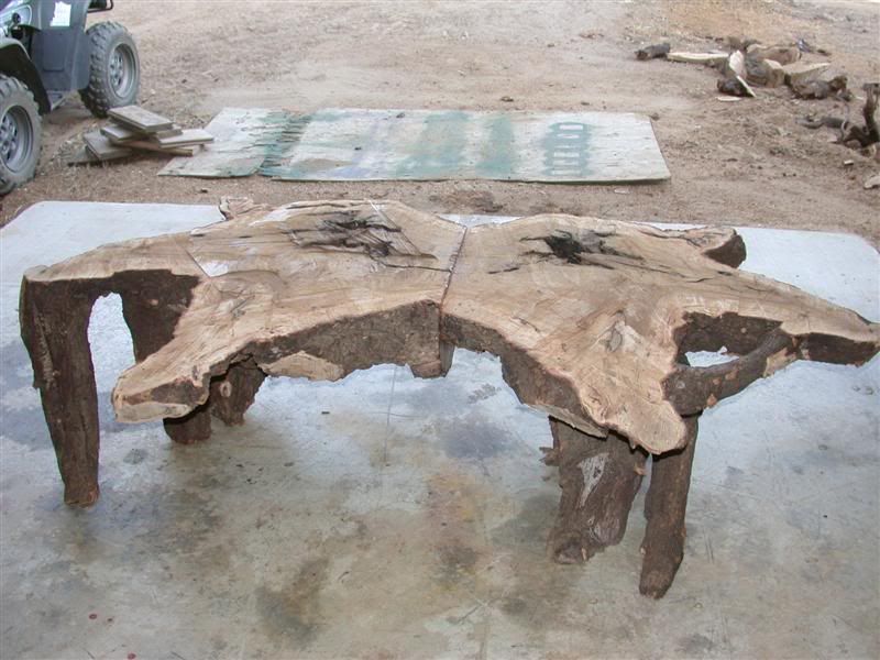

After I got the pockets done and lined the 2 halves together, I drilled bolt holes in each side.
I then glued and bolted the halves together. When it was dry, I continued to work on the roots which are the legs to get them fairly level and all touching.
You can see there is a lot of variation in the table top surface, so I had a lot of planing to do to get them even.
That's where I am right now. In fact, I got the top planed down pretty smooth and level. I have actually started sanding the top now after several days of planing. My next step is to sand with finer and finer sand paper.
You can see it's an interesting shape splitting the stump that way. The table is about 6 feet long and almost 4 feet wide from end to end. It's taken days of work so far.
Then I need to get some type of acrylic to fill up those big voids where some of the roots dip down from the table top. There are also some "burned and charred" voids in it. I want to be able to "see" down into those voids but have them eventually be level with the table top surface so nothing falls into them.
What should I use to do that?

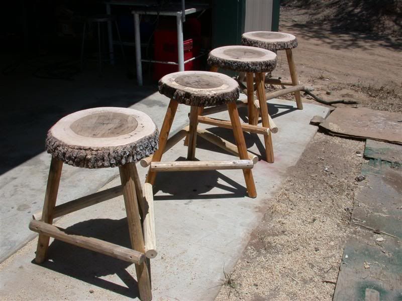

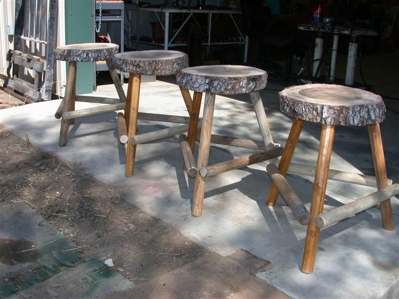

Oh, and here are the stools for the back deck.
They also need to be finished yet. I used an Oak log for the tops and left over spindles from my deck railing. I counter bored the bottom of the seats and press fit the spindles in for legs. They are only glued but the fit is very tight. I screwed on (and glued) the stabilizers (or whatever you call them) and the legs are very sturdy.
All this wood working goes very slow for me. I'm new to it.
Rob-

Thanks for that tip. I see you are a pro so I will listen carefully.
Do you see those voids in the photos? What should I do to fill them up? I really don't want to have any "holes" in the table top. I've seen those scorpions inside plastic, you know and I was thinking maybe I could use something like that to fill the voids. I've read where varnish is a great all around finish and will probably use that for the final finish. But right now I'm stuck on filling those voids up to the table top level.
HELP ... hahaha.

   / 3R Home and Barn Project #1,236
Rob
You can fill those voids with acrylic or epoxy just like the scorpion paperweights. You can use the West system (a brand name) to coat the whole thing which will finish it and "glue" together any cracks or faults. Most boat repair places will have it or hobby stores that have casting materials for those paperweights. Since the epoxy dries by reaction you can fill a lot of the void each time. I have seen stuff that they use to imbed coasters and coins in bar tops -- don't remember the name. Don't use any coating like varnish or oil on the wood until after you have filled the voids.
I think it will look marvelous
ps HF has the chainsaw blade to fit in your 4.5" grinder -- its called a Lancelot
Google table top epoxy and you will find suppliers of the material to fill the voids -- it is not cheap cause those are big holes!

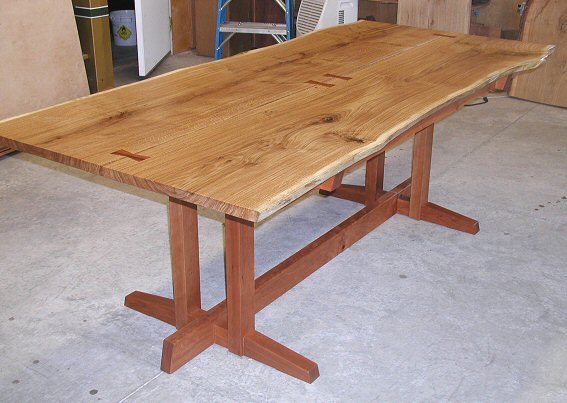

Rob,
I agree with Studor. West System Epoxy is a great product to fill the voids. I don't use it as a surface finish though, although it can be done. I prefer the more natural look of the oil/varnish/terps mix I wrote earlier about. You can also mix colors into the epoxy if you want a different look. This attached picture of a natural edge maple desk I made used West System with black tint to fill a large crack which I then additionally stabilized with "butterfly" inserts.
The second attached picture shows a natural edge oak dining table with the finish I described.
Rick
