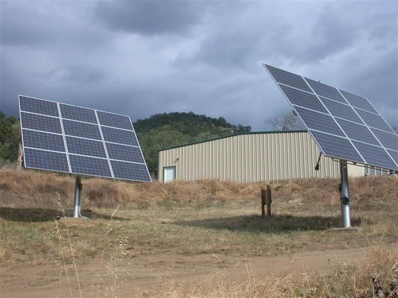

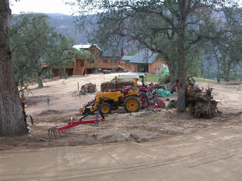

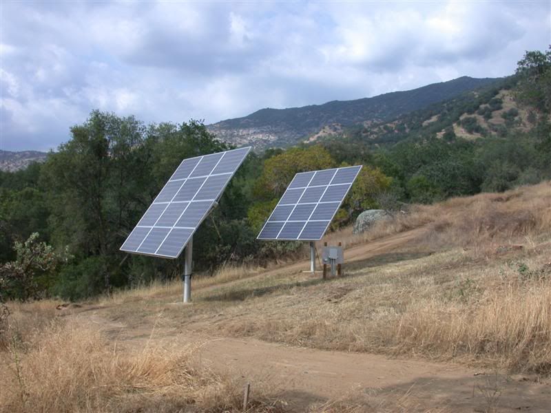

Lucky for me the insulated barn is a little cooler where I do my work. In front of the barn is Loretta's garden and where the tractors are parked. Here are some photos of the barn and the solar arrays behind it. I did a lot of clean up around the solar area removing a bunch of trees there.

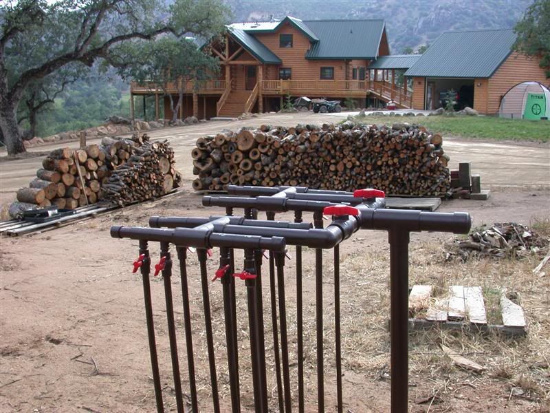

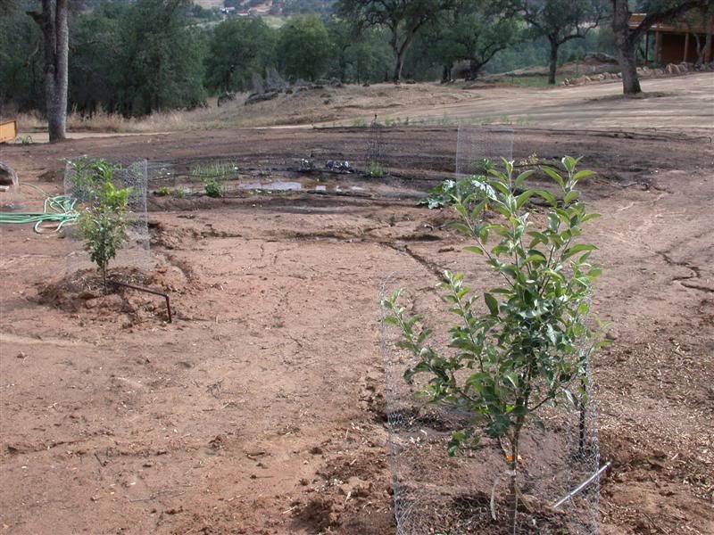

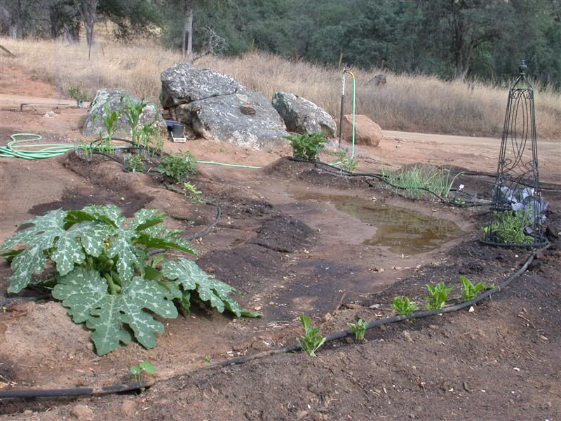

Here are a couple more pictures of her garden area and the orchard.
One of them shows the water controls for the both orchard and rows. It sure makes it a lot easier to water now.

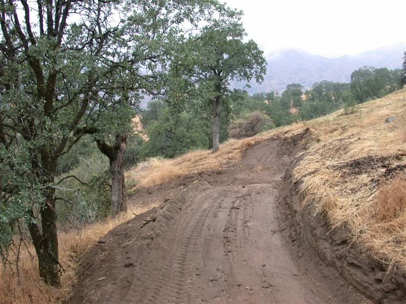

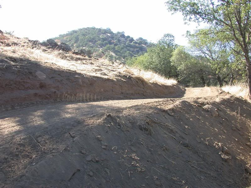

Here is the story on building that service road down to the meadow behind the home.
We needed a way to get our tools down there so we could install the irrigation on that hillside. It is a very steep slope indeed. I started cutting in the road from the South side of the home where the slope was more gentle.
Rob-
   / 3R Home and Barn Project
#1,248
My plan was to allow an entrance onto the steep hillside and also continue the road down the hill to the end of the meadow. There, it connects to a road I cut in last year on the North side near the small ravine. Even on the more gentle slope I had to cut quite a bit of dirt and decomposed gravel away to cut the slope out of the hillside.
The farther down I got, the steeper the hill got.
I used my trusty box blade bulldozing in reverse to cut the slope out of the hillside.
I used the "scalloping technique" like a bulldozer uses to cut roads into hillsides, except I was doing it in reverse going backwards. I was able to tilt the boxblade and cut off the high side so my tires would end up on more level, less sloped earth. Not only that, but the area I cut was now clean and fresh (more solid) than the spooky hillside slope. It took many passes to cut like that but it was a safe way to keep my tractor off a steep side slope and not tip over. I pushed dirt from the high side down to the low side and compacted as I drove over the loose dirt.
#1,249
I had to use the rippers many times to loosen the hard decomposed granite and pull out rocks.
Once a part of the road was level enough, I turned around and used the FEL to loosen the higher banks I needed to cut away. I would dump buckets on the low side. I could do this because my tires were on the level part of the road now. Then to continue further down, I would turn around and bulldoze with the boxblade again. It was tilted pretty good on the first cuts and I would get it closer to level as the road got closer to level. The last photos are of the road dissapearing into the meadow below.

Rob - you sure do a lot of hard work around there but I hope you're having fun at the same time. The place is getting better looking all the time. Like what you did around the solar panels. I thought the trees would hinder their performance. The new road building is cool. Access to all parts of your property is important especially in case of an emergency.
