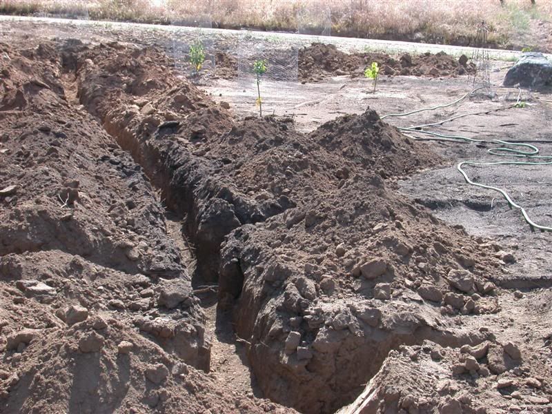

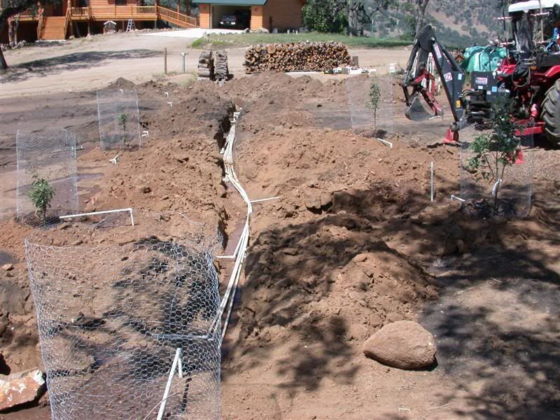

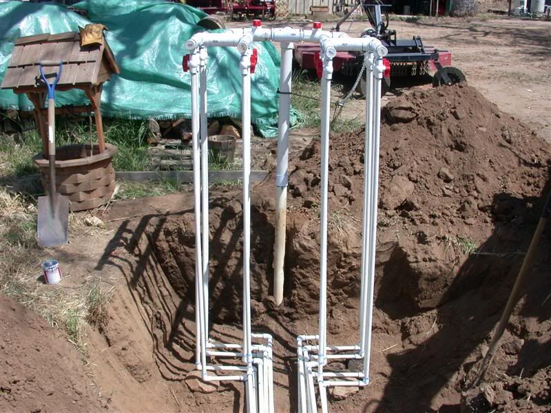

I got some Actos Blue Sequoia trees planted and got the watering system going to them. They are like Coastal Redwoods are should grow nicely in this area as long as there is water for them. We also got the entire garden watering system complete. Did a lot of trenching and ran over 1200 feet of PVC to feed each of the orchard trees and garden beds.

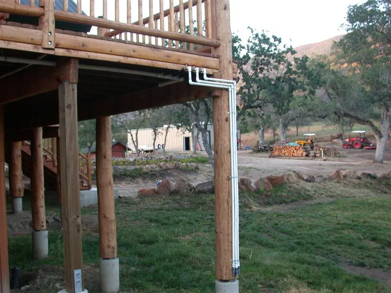

We got another ballast tank and booster pump to use the 5,500 gallon water reservoir to irrigate with.
That will continue to freshen up the water in the tank as we use it and it doesn't affect the house water system. We have a valve that can throw the water from that tank to the house system in case our well pump breaks down. So now we will have both water and pressure for the house in case of a break down. In the mean time we use it to irrigate the garden and also the steep slope behind the home.

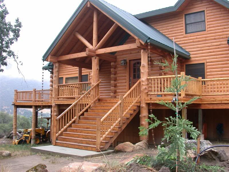

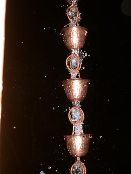

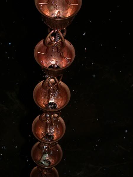

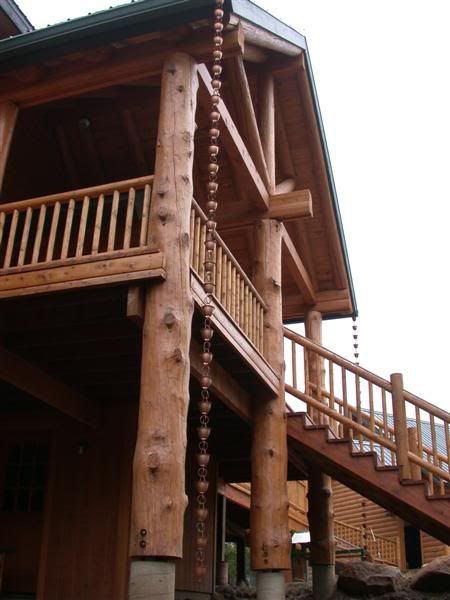

We also got gutters put on the home and decided to get those copper rain chains.
I still need to have the rain chains come down to the ground into collection box or drum so I can channel the run off down the hillside. But here are some photos of that. You can also see a couple of the Redwood trees we planted in the fore ground.

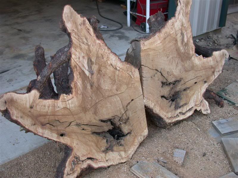

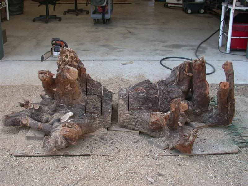

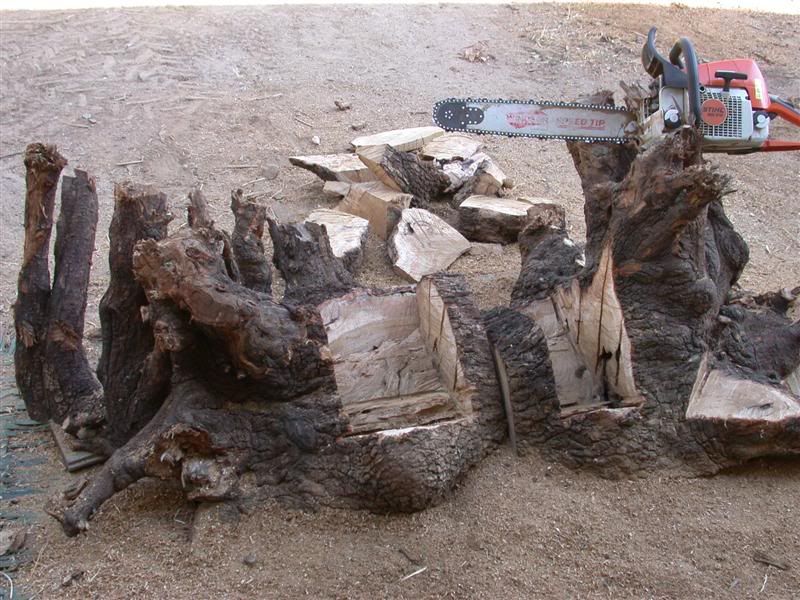

I have seen tables made of stumps before but never one split in half like I am (attempting) to do. I have some photos of the project but will need some guidance on finishing the top.

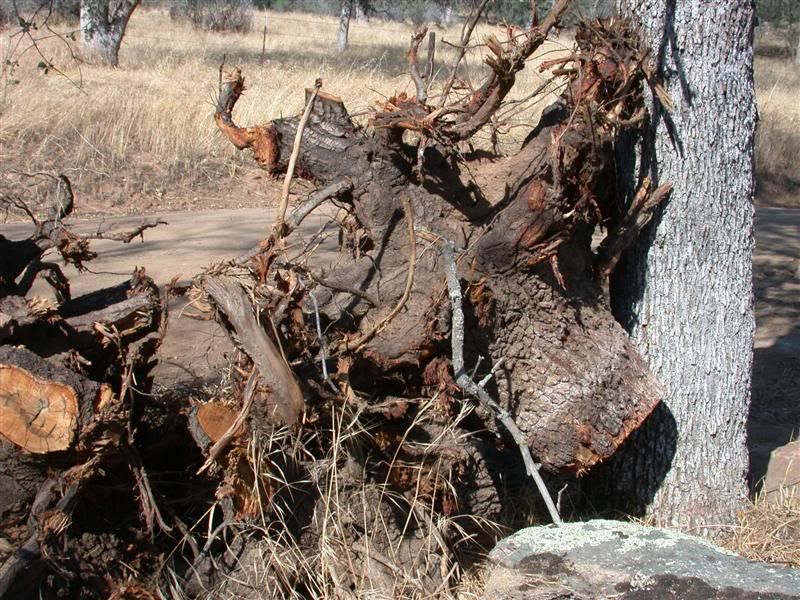

Here you can see the stumps I have lying around and how I split the big stump in half with a chain saw. I cut the trunk off pretty short and planed those ends to but them up together. I blocked up the two halves to see how they lined up.

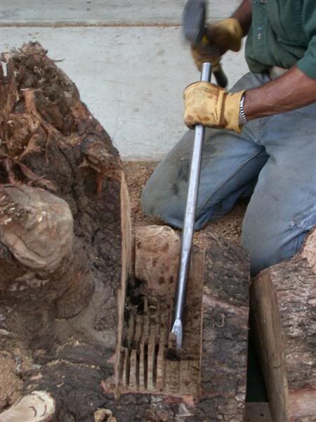

Then I pocketed out on each side so I could use (5) 1/2-13 all thread to bolts and glue the 2 halves together. I made a tool to chisel out the pocket so (3) of the bolts could be as near the table top as possible for maximum strength in case the wood split or broke.

Very nice Rob! Have you ever seen or tried one of those wood carving
wheels you use on your angle grinder? The teeth look like chainsaw teeth
and allow you to "carve" away lots of wood quickly.
