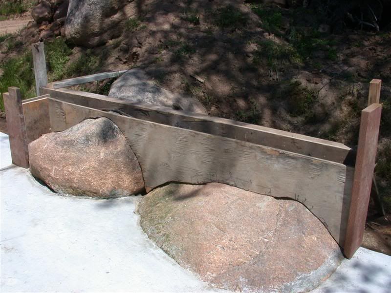

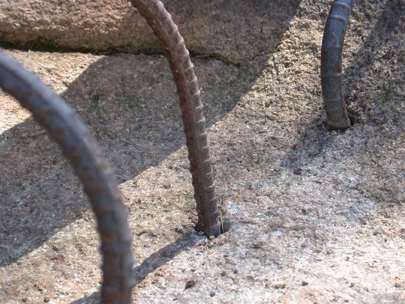

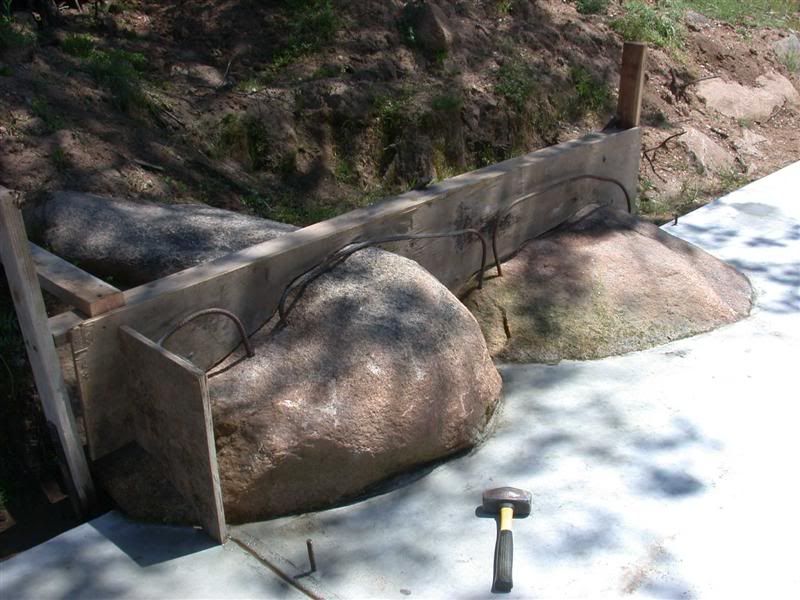

I also have some photos of how the pour around the rocks was done.
First, I traced out the shape of the boulders and cut them into several pieces of plywood. They would be the forms for the short front and long sides of the pour.
In-between the forms, I used a masonry drill bit to install holes for 1/2" rebar.
I bent and connected them between the rocks.

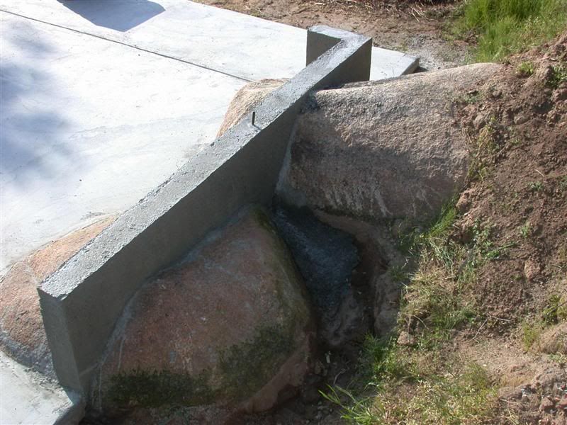

   / 3R Home and Barn Project

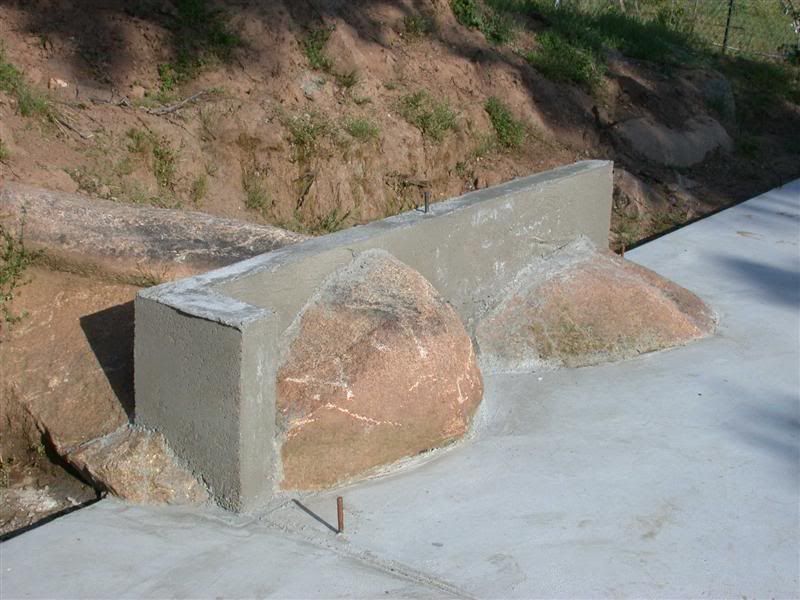

#1,413
I had to use clamps to hold the forms from bulging out too much, but it all worked out fine.
The concrete was hand-mixed in the wheel barrow. This was the last step of the concrete work before we would start framing.
The hardest part was to cut out the plywood forms ... to get them close enough to seal on the front and the back. So I had to cut, place them on top of the rocks, then check where I needed to cut more. Do that over and over again until both front and back forms were fit adequately. Although my cut-outs were not perfect, they were good enough to work and hold the concrete in without too much spill.
Below are a couple photos of how the wall turned out.

3RRL;2619701The hardest part was to cut out the plywood forms ... to get them close enough to seal on the front and the back. So I had to cut said:
Rob, here's a trick for making that effort much easier: use structural
polyurethane foam, which you can buy in cans at the Home Depot. Get the
hard stuff and not the squishy stuff. Use this stuff to seal gaps in rough
formwork up to 3 or 4 inches. It is a trick I used extensively in ICF concrete
work.
The hardened foam trims easily with a knife or saw, and it scrapes off
from the rock afterwards. It evens seals out the grey water leakage
that will stain the rocks.

Great tip Dave !!
I didn't even think of that and it makes perfect sense. We just bought another small parcel which will be used for rental income. I may have to use your tip when we start building cabins on it.
Thanks !!

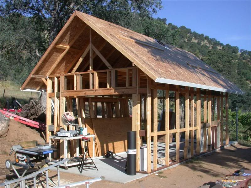

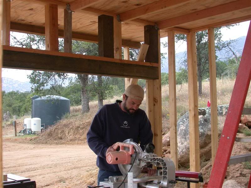

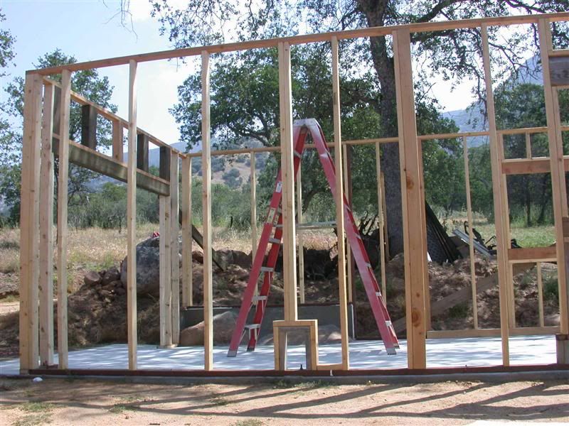

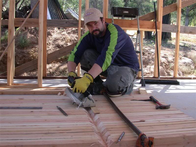

Getting to the final framing of the shed...

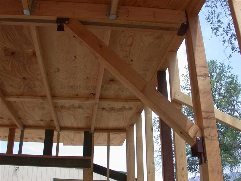

My son Tommy helped me through this whole part. He was having a blast and laughing because we used as much of the remnant beams as possible for headers and such. Some were waaay to big, but it's a garden shed. Some beams we had to rip because they were like 8" x 8"s. Better than turning them into firewood, right? We even welded up some custom made steel brackets for some of the bracing.
#1,417

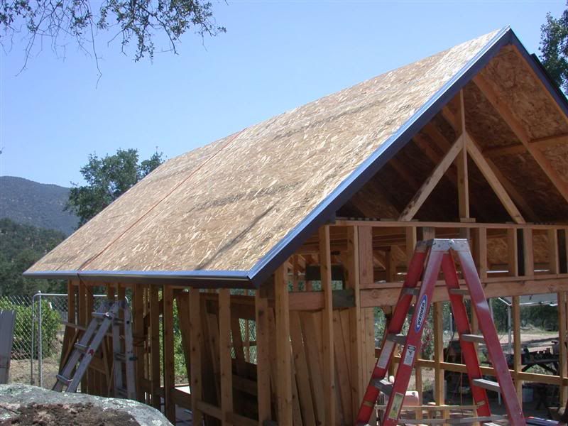

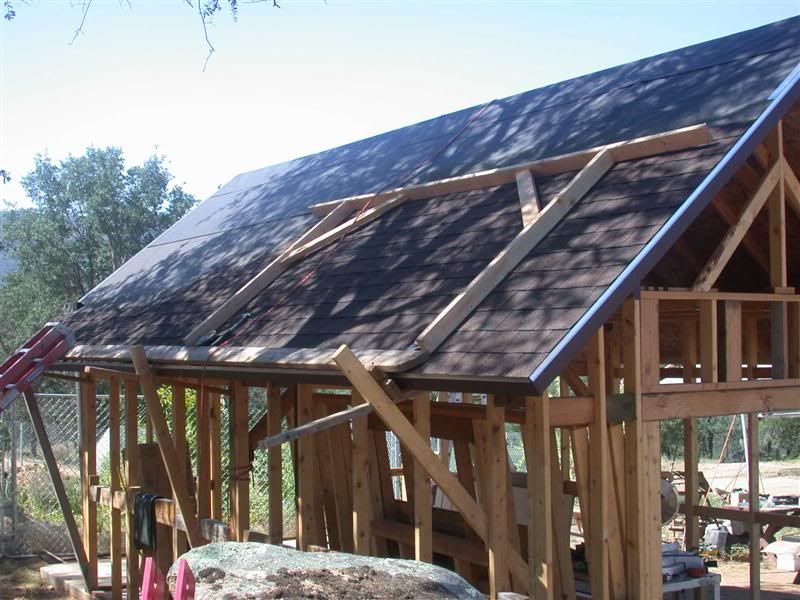

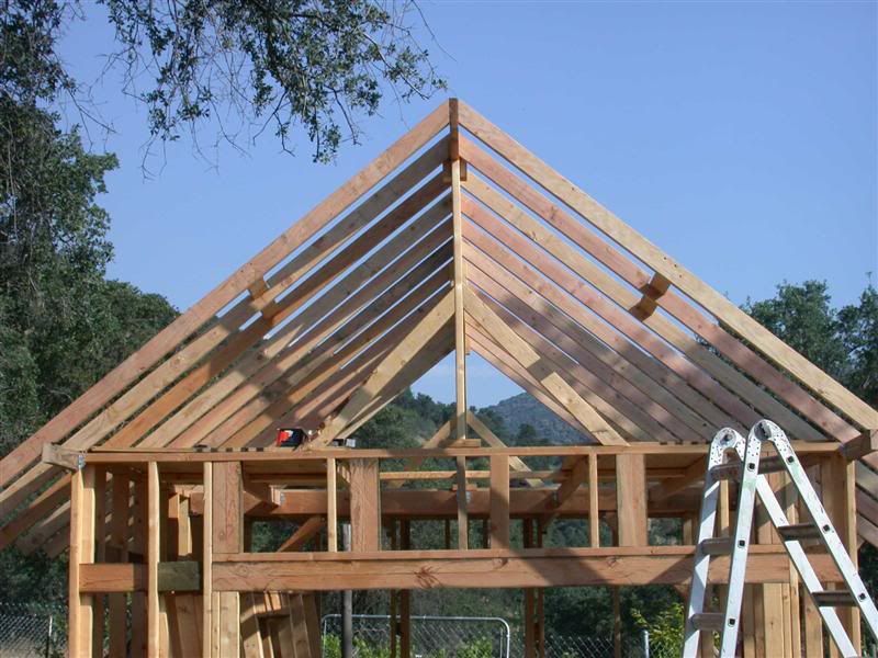

After getting the walls squared up, we started making the roof.
We used the tractor to push on one corner of the building to get it squared up, and then screwed in the bracing and blocking and hung the rafters. The roof came out pretty good. Tommy cut all the bird's mouths at one time and they fit !!
Then we put up the OSB, and flashing and installed a turbine too.

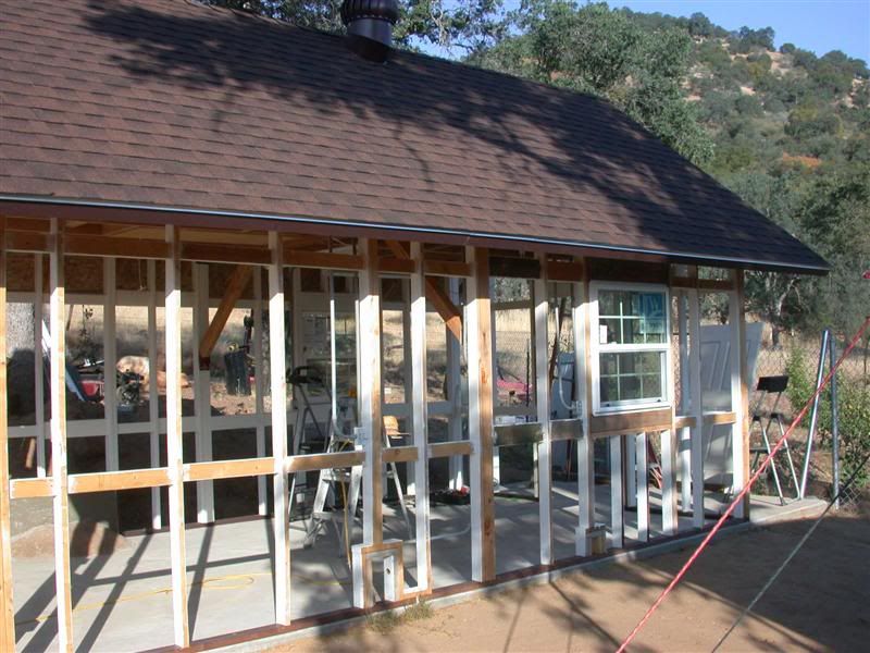

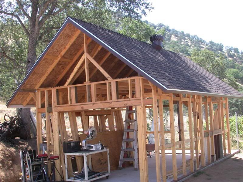

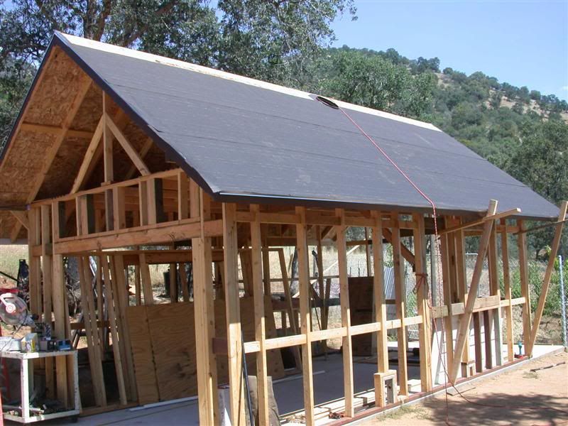

#1,418

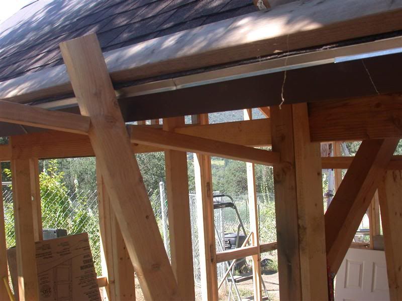

Next on the list was to put down the tar paper and shingles.
We made a make-shift scaffold so as not to fall off the roof. I cut some 2 x 4's so they would fit onto the wall beams with a hook shape, and screwed them on. We moved them from end to end as we needed.

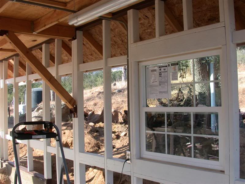

#1,419

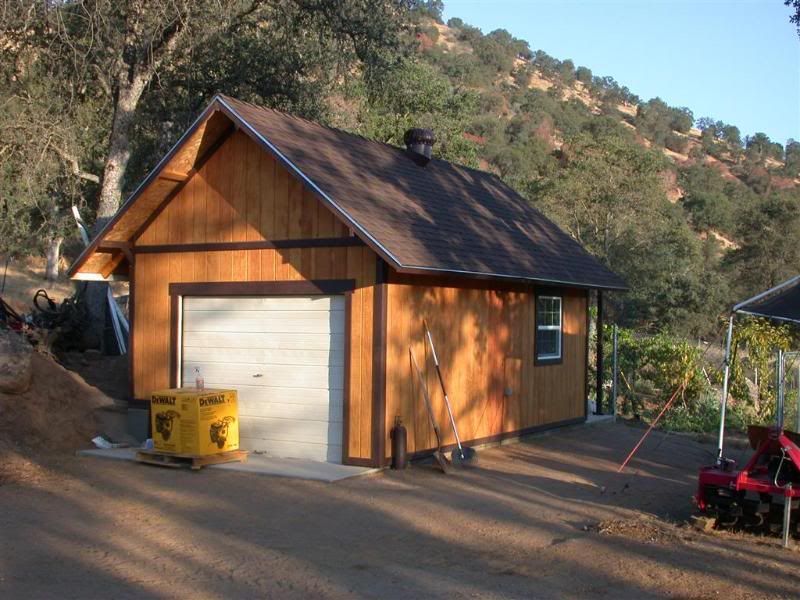

Once we finished trimming, the roof shingles turned out pretty good, I think.
You can now see the turbine in the photo below too.
Then we decided to paint all the beams so as not to get paint on the siding.
We also installed the windows, doors and roll up door at that time.

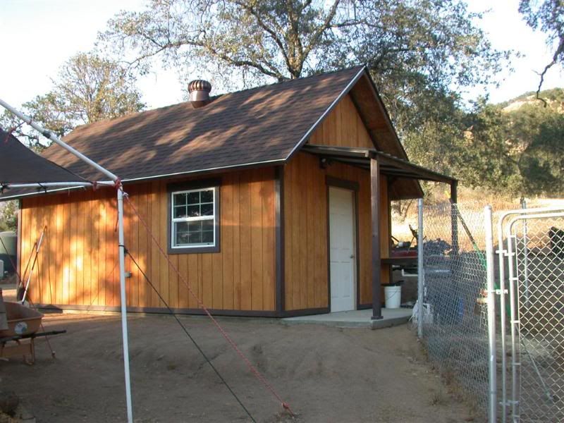

#1,420
One thing I didn't get a photo of was the pull-down stairs to the rafters.
We put plywood in there for additional storage. And you already saw the finished shed, but I'll show it once again.
Thanks for viewing this thread !!
