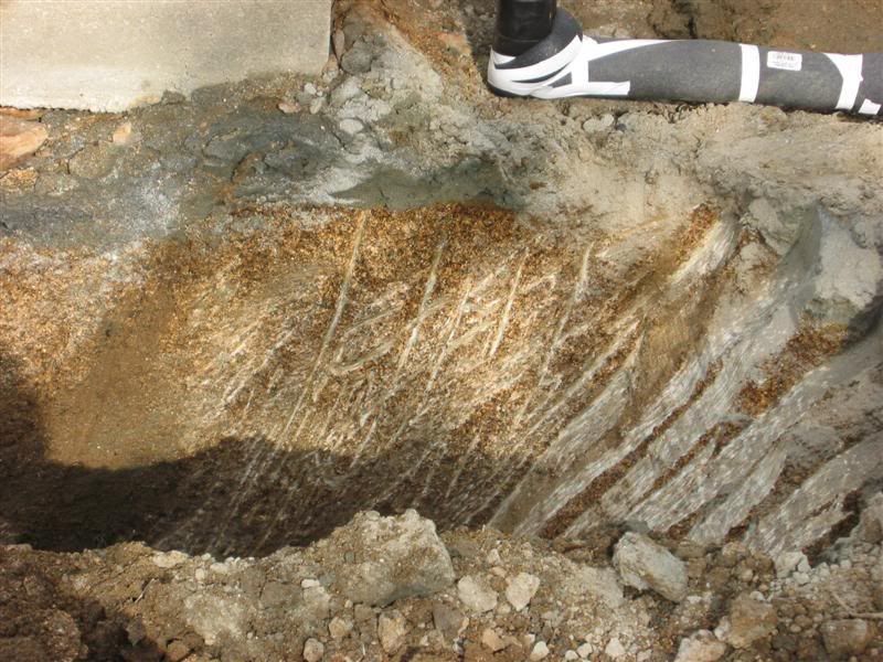

Before all the excitement, I had to dig a water line trench that would connect the 5,000 gallon water tank up to the well. This was in the rain but I figured it would be better to do it now since the Earth would be a little softer. Good thing too, because if I had done the road first this would never have gotten done.
I had to switch buckets for the trenching first. I knew I would hit that hard DG and a narrower bucket would help in cutting through it.
And as I thought, I soon hit the hard granite. It was dry as a bone too! You can clearly see where the granite starts below the dirt in these pictures.

Here are a couple short videos of the painstaking process showing how hard it was at this end of this trench. I'm sure glad the entire 30' trench was not like this part. I didn't hit the DG until I was at least 18" deep on the other parts. So the top layers were much easier to dig with the Nardi Back Hoe than this last section was. It is a pretty good backhoe but I sure wish I had a real TLB for jobs like this.
This one shows the start of the end trench. Notice how my articulated mechanical thumb is kept out of the way. However, it is not disconnected. Just have to control the curl function so it does not interfere. I did use it to hold the dirt in the bucket when I cleaned out the trench as in the other photos.
This is a close up of the work. I had to scrape of about 1/2" at a time to get through it. It took me almost 3 hours to dig this darn trench! Another interesting thing is you can hear the bucket scraping pretty good. I couldn't hear a thing from the backhoe seat, so I never realized that it was making that sound.

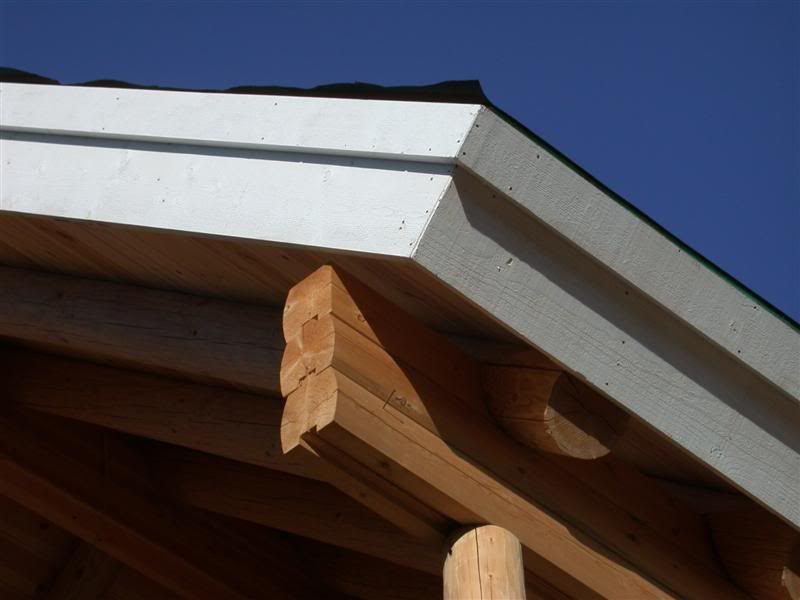

They pretty much got the rest of the logs stained and the bottom section too. There are still areas that need to be done but they wanted to get at least this part done before the weather hits. They should be able to work through the Winter now that they are dry inside.
These are a couple photos of how the boxed in the overhanging eaves and also showing the stain on the exterior.
