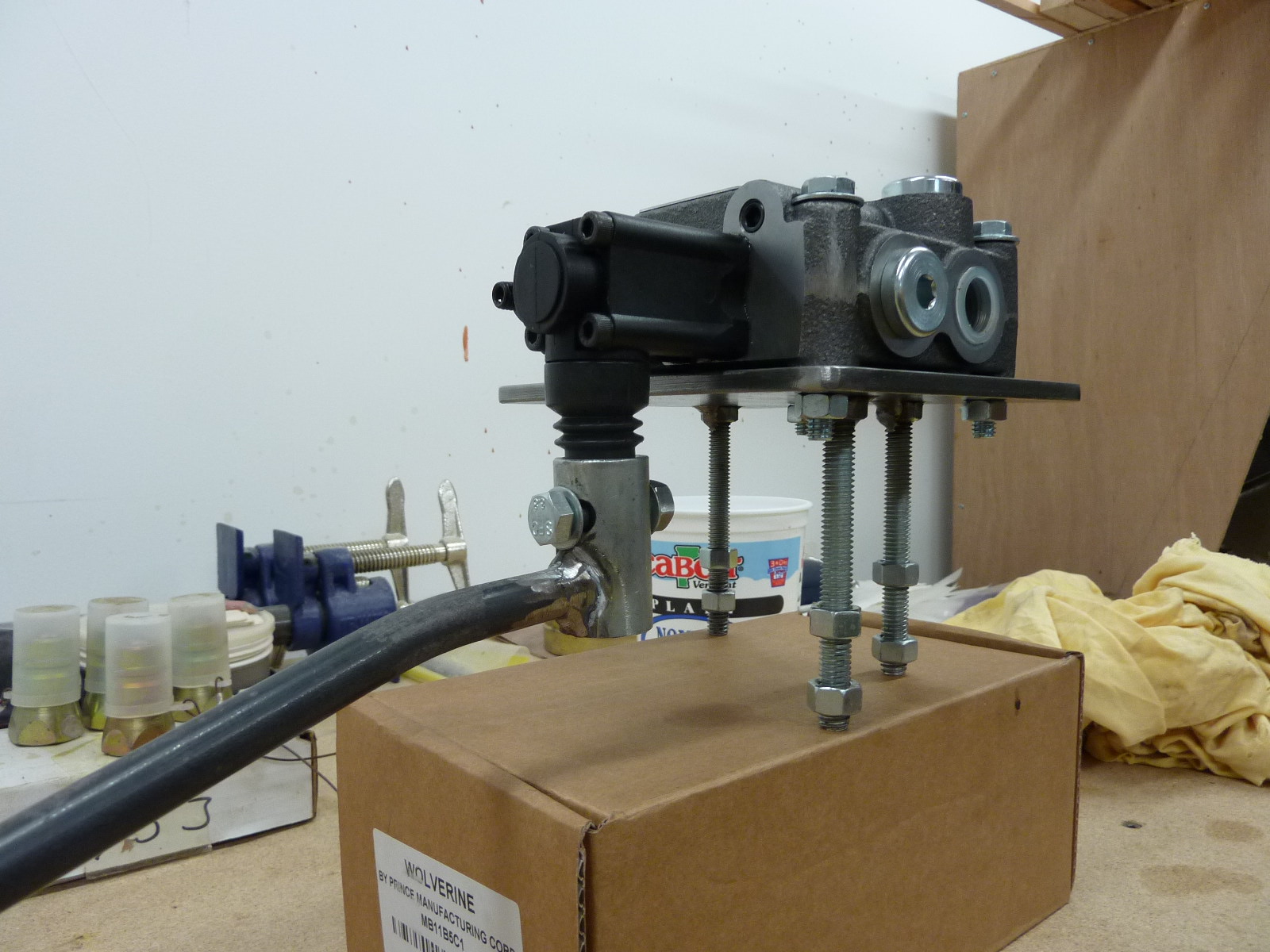

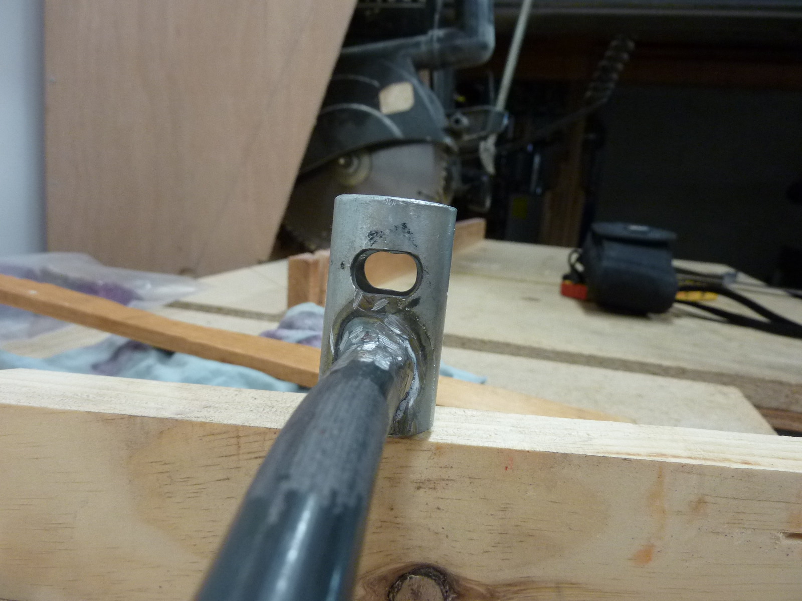

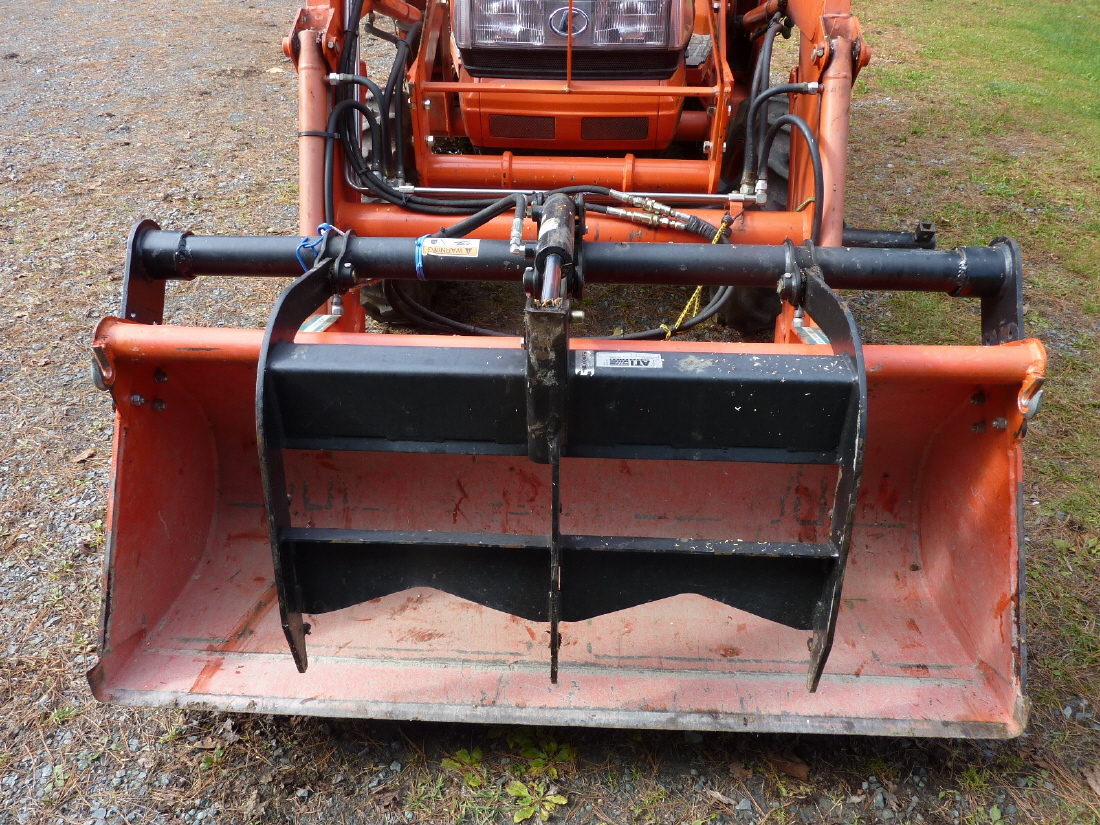

That's a slick setup. How long did it take you to master the dual levers? Also, what's the strap you have hose-clamped between the levers?
I have a bucket grapple on a old pin-on bucket. I made the grapple lever arm so it could swing left and right beside the curl/dump bucket lever so both levers could be in one hand. The strap is a small leaf spring from an ice fishing tip-up flag that holds the grapple lever off the right out of the way when I am just doing bucket work. Then I pull it over to the bucket lever when I want to use both. Easy to use.
