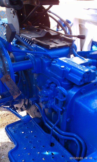

Wouldn't these terms have originated with the first tractors to offer hydraulics other than the 3pt lift?
It was not the first most likely, but didn't old Fords have a valve plate that was added to provide a 2nd function, and then another valve plate could be stacked on top of this to add a 3rd function?
There were attachments then loaders which were used way back, I don't see why/how the label of 2nd or 3rd function would be tied to a loader only and then mis-used, as some have eluded to here, for other attachments. I think they had generic names because they could be used with so many different attachments.
Some examples of the add-on valves plates I'm referring to.

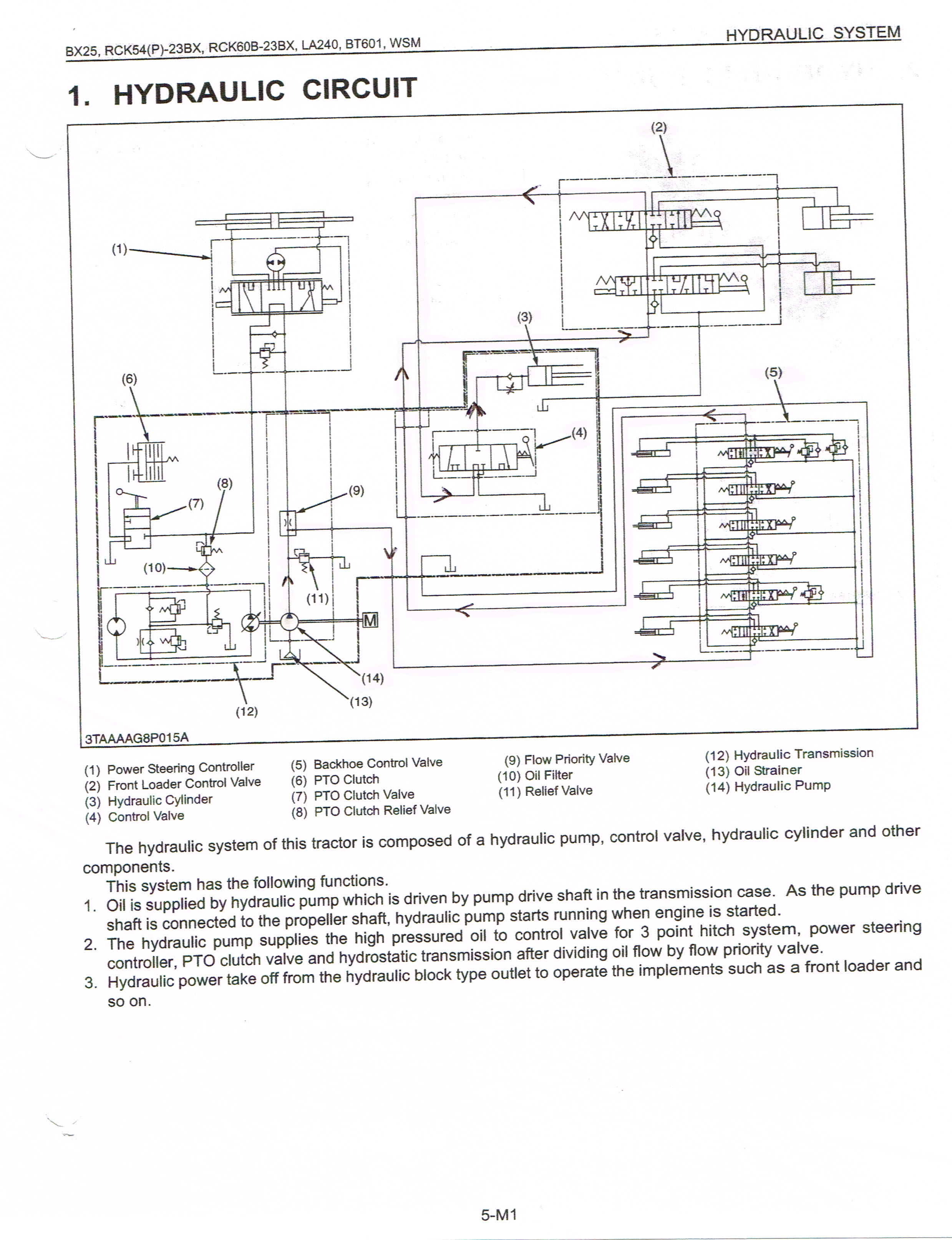

JJ,
The flow pattern is very clear in the WSM for the BX25. Also you can only buy the BX25 w/FEL and BH. The same basic tractor is offered under different Model #s. You cannot install the BH on those models. I have no idea on them but the FEL is optional as well as the front HYD joy stick for other front attachments. I would assume the FEL then is first but ???
Ron

Looking at the BX25 pump circuit from Messnicks, it looks like there is a a cover plate which they remove and install a thread cover plate with two ports which feed the BH.
You guys should have the manual, but I will bet that when they install a loader, the PB port from that adapter plate goes to the loader and the PB from the loader comes back to feed the BH, and the BH return fluid comes back to the adapter plate and then feeds the 3pt.
{ Well, I lost that bet. } see post 51
Do you have the hook up for the loader or is it a dealer function?
If all that is true, then the loader relief is the master relief for the hyd system.

JJ and all,
Attached is a copy of the HYD diagram from the WSM. I have drawn flow arrows on it for clarification. Note item 11 the relief valve, it establishes the pressure right at the pump, it is part of HST housing casting. Items 4 and 3 are the control valve and cylinders for the 3PT. When the BH is off the P hose plugs into the PB circuit going to the FEL as the P input. The BH valve block is a PB and there are three hoses to/from it.
Ron
