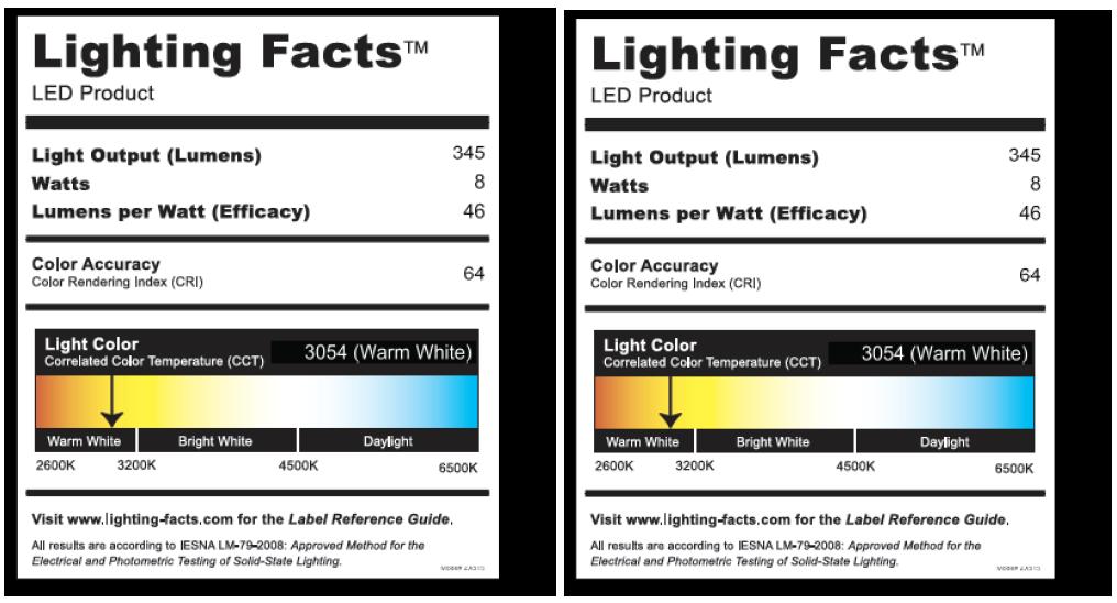

When comparing or shopping for these, be sure to note the lumens. There is a wide margin of light output all being sold as "shop lights", so do your homework. Some produce lower light than T8 or T12 lamps, while others produce much more light.
More importantly, IMO, is to pay attention to the Efficiency of the light. That is, the Lumens/watt.
Every light sold in America today should have a "Lighting Facts" label on it's packaging. Example:
Another version:

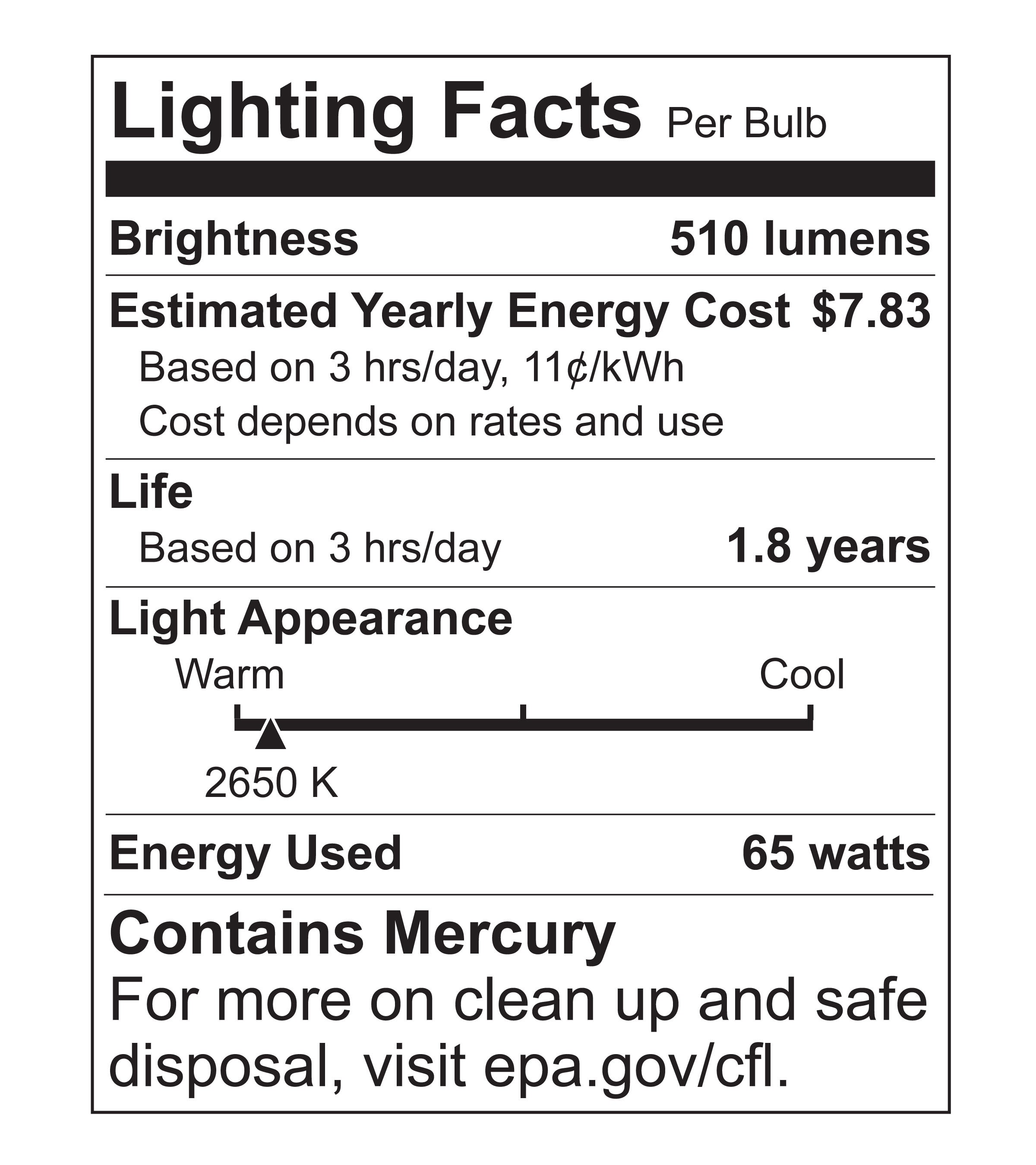

The first label above explicitly states the Efficiency: "46" (lumens/watt. Which by the way, is a miserable efficiency.
The 2nd label, you have to infer it from the Lumens and the Watts, to whit: 510 lumens/ 65 watts = 7.8 lumens/watt, which is even worse.
For shop lights, I wouldn't even bother for anything less than 100 lumens/watt. Those Rural King specials are around 78 lumens/watt last time I looked. That means No Way I'm buying them.
