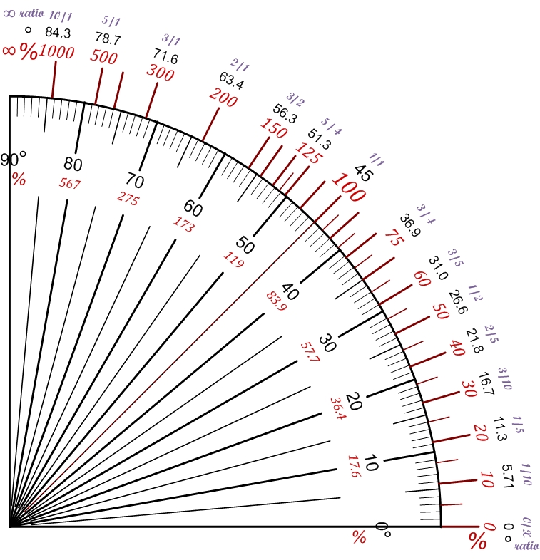

I am in the process of purchasing 40 acres of mountainous terrain in NE Washington State. It has a roughly 1 mile access road I will be responsible for. It is steep and windy, over 25% grade in many areas. The road needs a bit of work, but appears well built, plenty of water bars, a culvert or two, nice stone, etc... The property is steep as well, about 10 acres are developable, but still sloped. The property has several leveled buildings sites and a cabin. Planning to use the cabin for a couple years then build a house.
Thanks in advance!
How did you determine the grade?
A 25% grade is only 14 degrees, not very steep.
A 25 degree slope is a 46.6% grade, pretty steep.
14 degrees or 25% when it's snow covered or icy is steep, my driveway 14-16 degrees and it can be a handful in the winter.
Plowing down it chains keep you from having a runaway, driving up it chains allow you to make it up.
Everything that I have plowed with needed brake or a really low gear not to run away even with blades down and pushing snow.
Very seldom is throttle needed going down, brakes are often needed.
