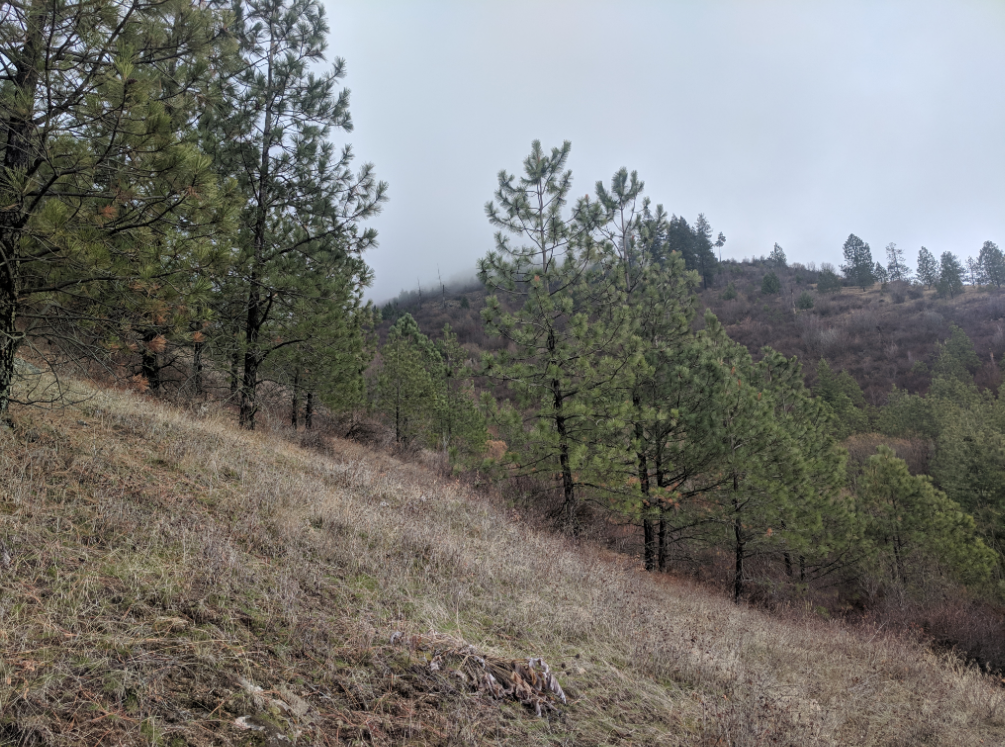

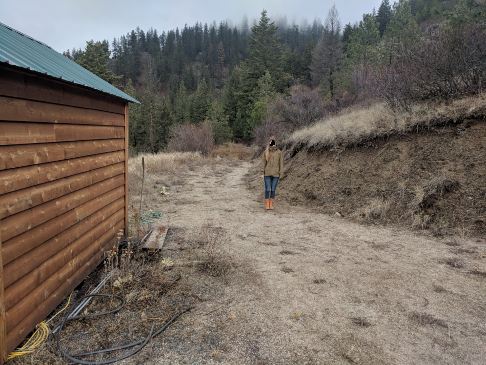

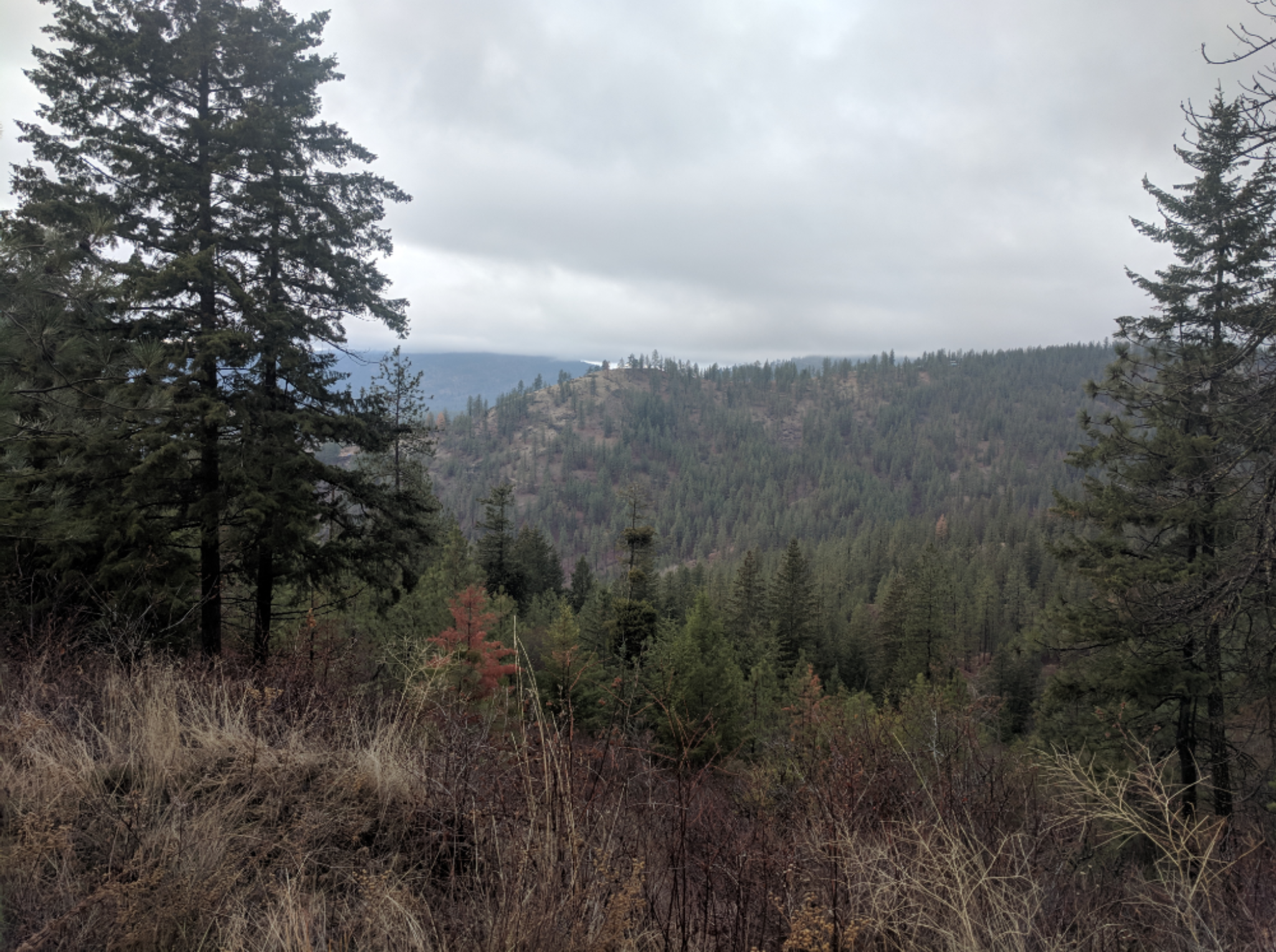

Attaching some photos. None of the road, I keep forgetting to take pictures of it... The first shows what is typical of the property (sorry about the greyed out face). The next shows the worst slopes encountered, not planning on driving on those. One more pic for good measure, you can see a neighbor's house on the ridge in the foreground.

OK, I've got the picture now...and just looked at the photos you posted.
That could be my own backyard! Similar weather pattern too. We can have snow from one inch to five feet in succeeding years. Now I can also bet that your soil is probably sandy disintegrated granite (DG) with some porphoritic crystals. Not much clay except in pockets. (Most of the clay washed down to the flat lands.) Occasional rocks & boulders. Lots of Ponderosa pine. Water high in iron and possibly dissolved manganese.
No, I'm not an active miner. Those mining claims are from 100 years ago and are mostly historical. Old mining claims that produced enough to be "patented" is how most local property ended up as pockets of private land within the National Forest & eventually became residential. Mountain houses turned out to be the real "gold" around here. These mines produced a little fluospar with traces of heavy metals like tungsten and such. Not commercially feasible or impressive - just 200 foot by six foot diameter tunnels into the mountain side with ore car tracks and nowdays inhabited by bears and foxes.
There are a couple of us here who have similar property along the rocky mountains and pacific ridge from Arizona right on up into Canada. Lots of us ended up owning similar tractors, too.
On blades vs blowers.....If you get a back blade get a heavy 8 foot blade, hopefully with end caps and definitely with 3-way adjustability. Simple angle adjustment will not do much good for road work. You are going learn to hate always looking over your shoulder....but pulling such a blade with the 3pt is the simplest way to work that really accomplishes things. Used rear blades are as good as new. Ours is an old beat up manual 3 way adj. "Big Rhino" (cost $1000 with end caps) and is tough enough to deal with dg outcroppings. Ugly though....
