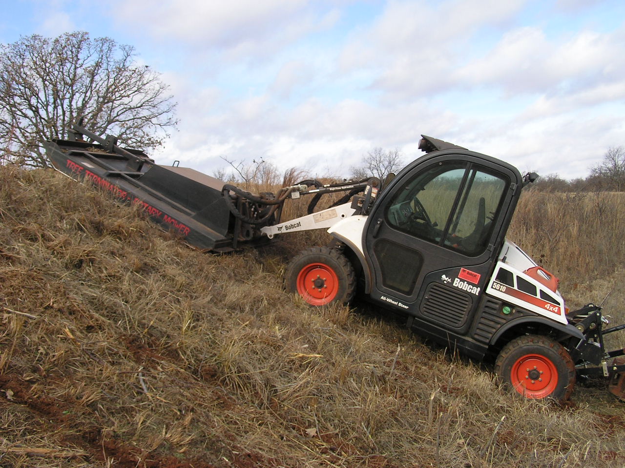

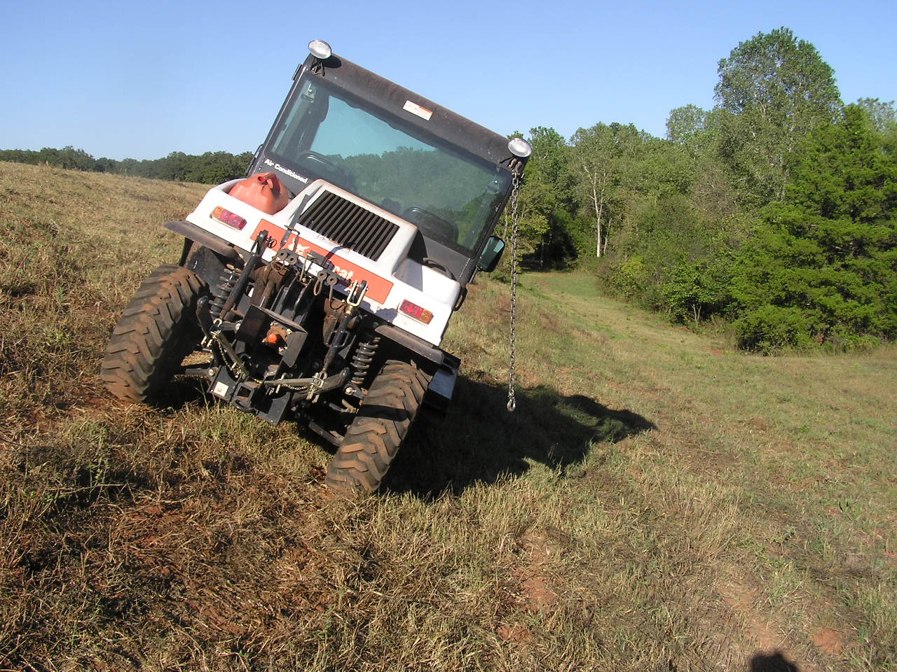

Low center of gravity, here is our 5610 on a 27 degree side hill, the hanging chain shows true vertical:

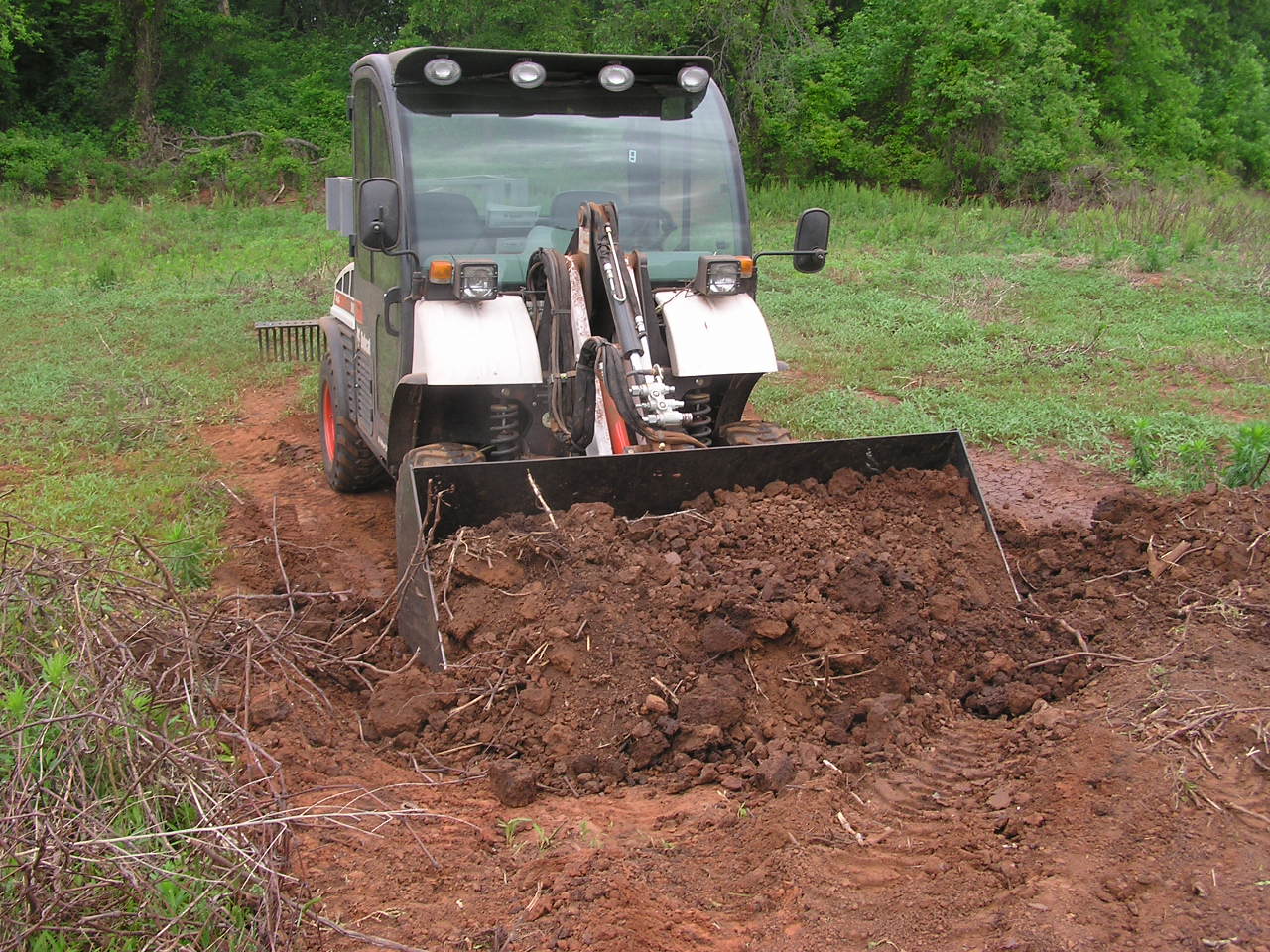

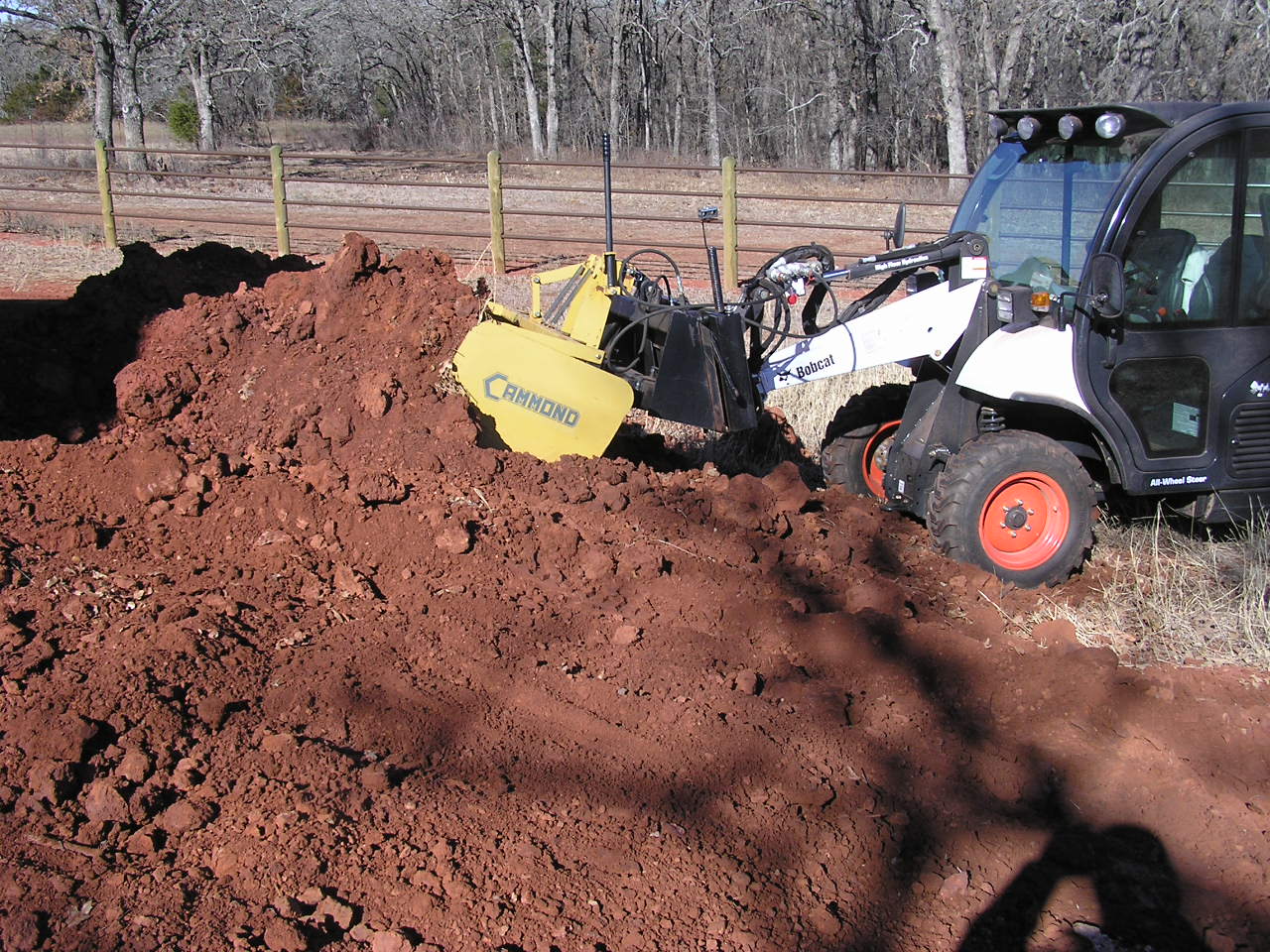

Digging and hauling dirt with a 6', 1 cubic yard bucket:

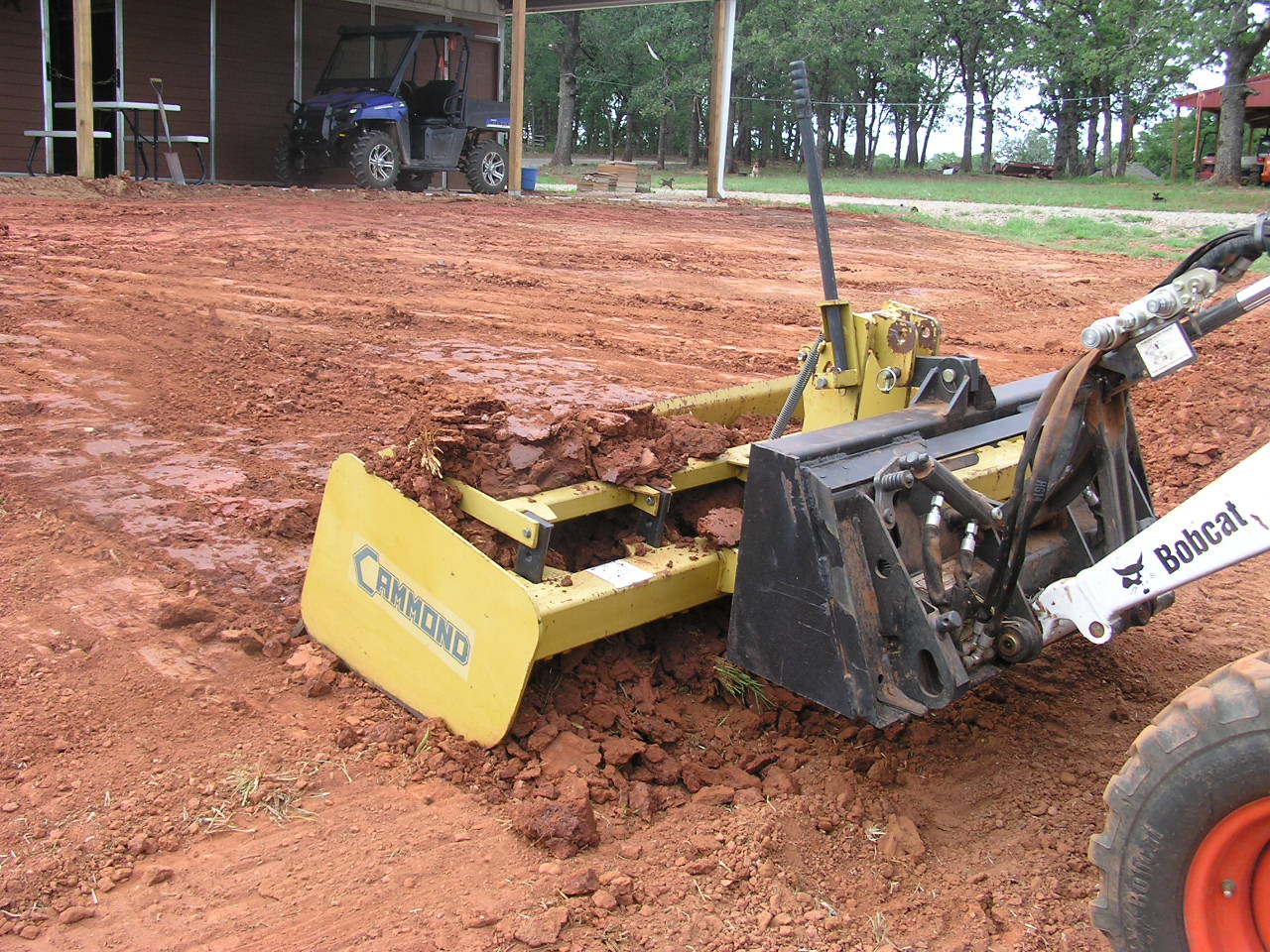

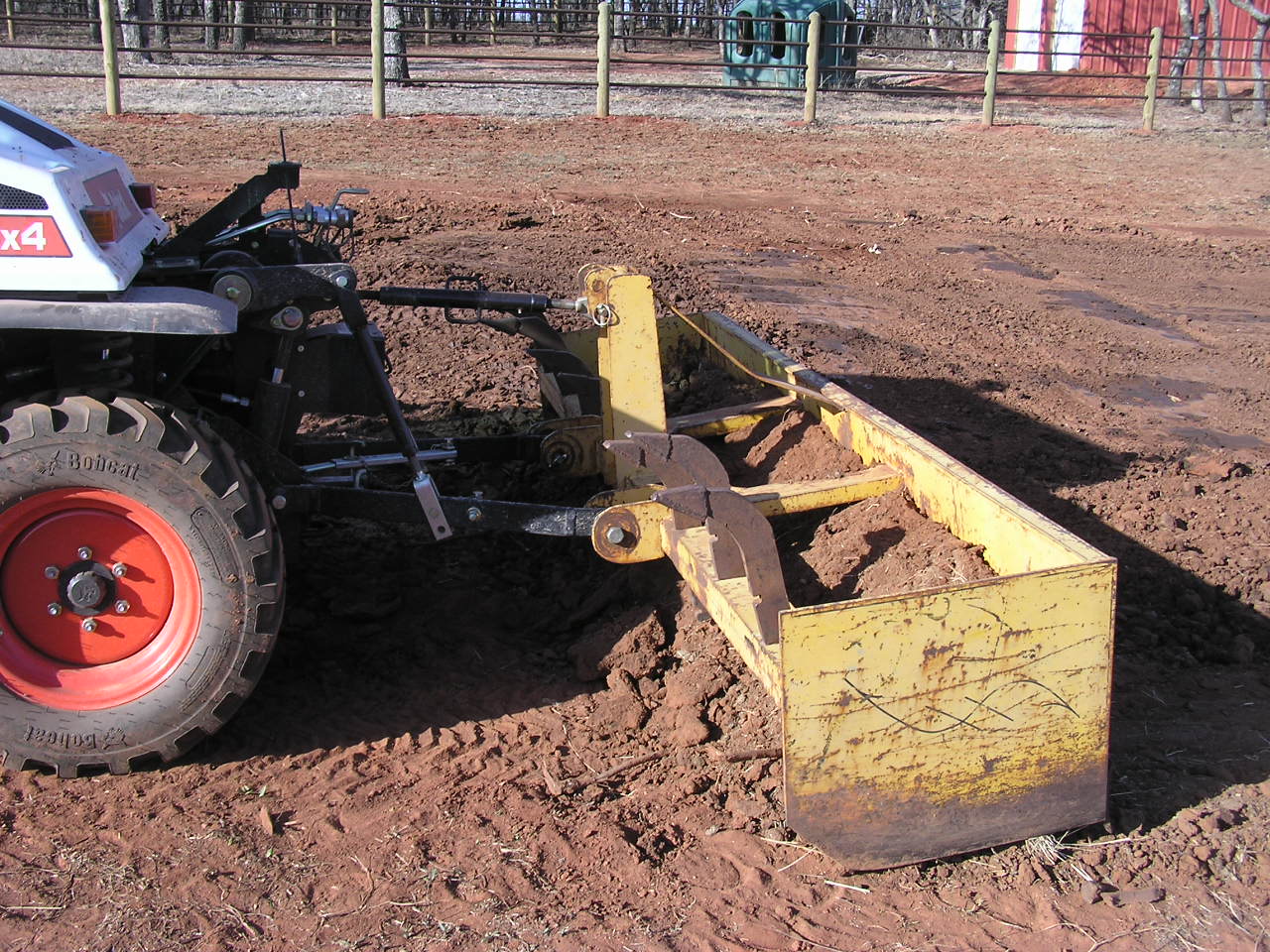

The 8' box blade:

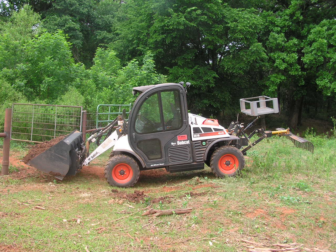

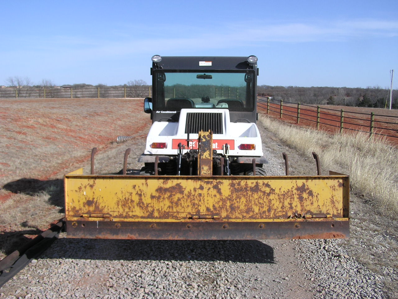

The 6' box blade on the front:

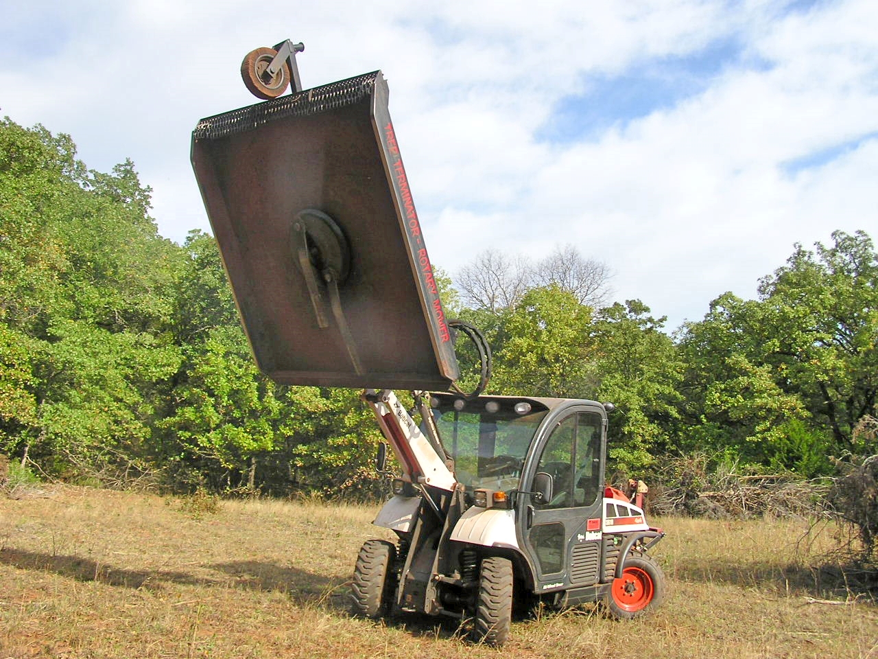

The 8' brush hog:
