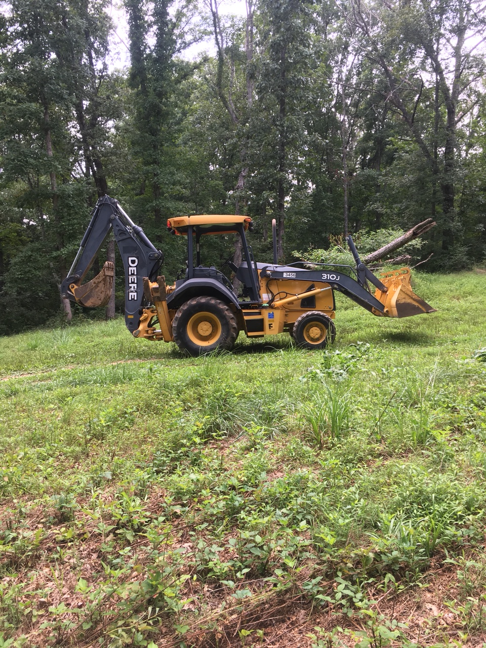

I have 40 wooded acres.
I need a tractor I can work on and repair myself.
I want open station, hst, 4x4, will have backhoe, loader lift 2,000 pounds or more.
I have very heavy/rocky soil. Chores will include- fire wood, move logs to staging area, plow snow, build roads/trails, food plots, misc. landscaping.
Any new tractor that you buy will be computer controlled with Teir IV emissions equipment unless you stay under 25hp. New tractors are not as easy to fix as a 1952 Ford 8N but they’re far more reliable and capable.
Korean tractors (TYM, Kioti, Branson, LS) tend to be robust and less expensive. The Japanese tractors (Kubota, Yanmar, Iseki) tend to be refined and a little more expensive.
Your spec for minimum one ton FEL lift skews choices available to heaviest tractors with HST.
If you can make do with 1,100 to 1,300 pounds FEL lift capacity you can avoid spending considerable money and have a tractor that will fit in a garage.
If you move logs with pallet forks mounted on the Three Point Hitch, rather than the FEL, you will not need as heavy nor as expensive tractor. Kubota L2501 Three Point Hitch lift capacity is 1,918 pounds at lift points, 1,389 pounds 24" behind lift points. (Including weight of pallet forks.) Carrying a ton is much safer with cargo weight on the heavy rear axle and large rear tires.
Every tractor brand includes a model in the 2,600 pound to 2,900 pound (bare tractor) range with 100 cubic inch/24 horsepower engine ample for your applications. Tractors under 19 KW ( 19 KW = 25.4794-horsepower) are currently exempt from stringent, Tier IV emission controls which abruptly increase a tractor's cost some $2,000 above the 19 KW power demarcation.
