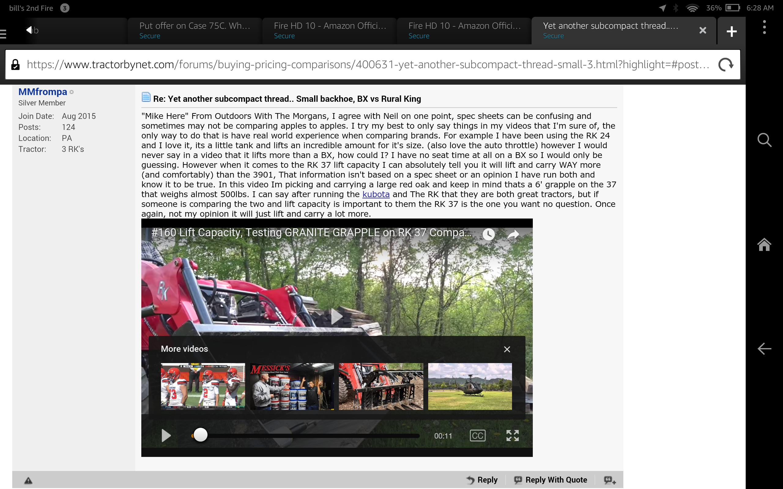

Interesting video on loader ratings. Thanks. I think I need to get out the notepad and start comparing models/brands and work my way down. This may take awhile.

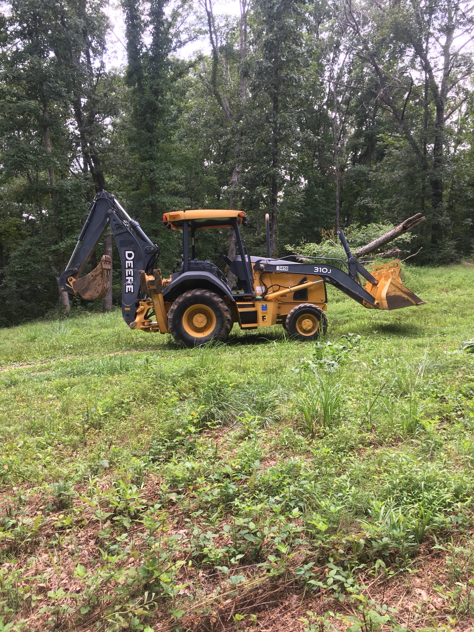

I got rid of my tractor and got a backhoe. The breakout force on the loader is 8500 pounds and full height lift is 6500 pounds so significantly better than a regular tractor. I don’t know the backhoe specs but it blows a tractor backhoe out of the water. IMG_4564.JPG

You are correct and that is a very nice backhoe. Exceptionally nice.
But I would not want to drive it on my pastures and fields in the off season as I do a tractor. I get enough ruts with a tractor half that weight.
But like I said, you have an exceptionally nice backhoe. Tratordata lists it as 13,880 to 16,220 pounds. That is heavy.

I agree those commercial backhoes are heavy - especially the 4wd ones. But that's not the whole story. It depends on how the tire loads the soil. Those big backhoes use a wide industrial R3 tread that really spreads the load out. The load gets spread out even better when the tire tire gets a little worn. I actually prefer to run half worn out tires on my backhoe for that reason. Unlike a tractor, construction machines never use a lugged Ag tire of the R1 type that are designed to cut into the soil for traction.
With the right tires, those industrial R3 tread are pretty easy on the turf even on a big heavy backhoe ---- just as long as it is 2WD.
In 4WD any tire or weight of tractor is going to tear the soil up. On my backhoe, the front wheels leave much larger divots in the soil than the rears. That's why I like to run really smooth wornout tires on the front.
