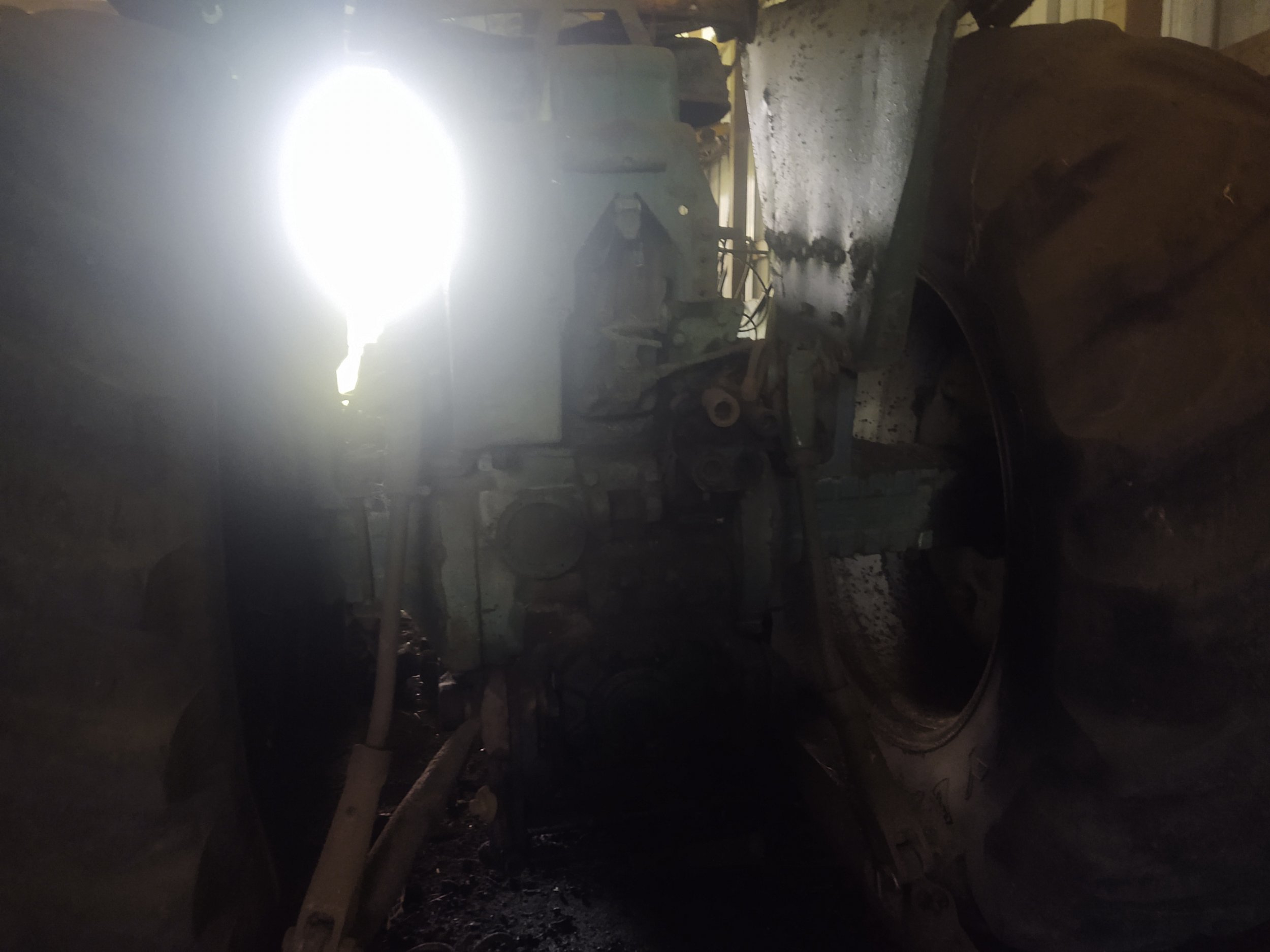

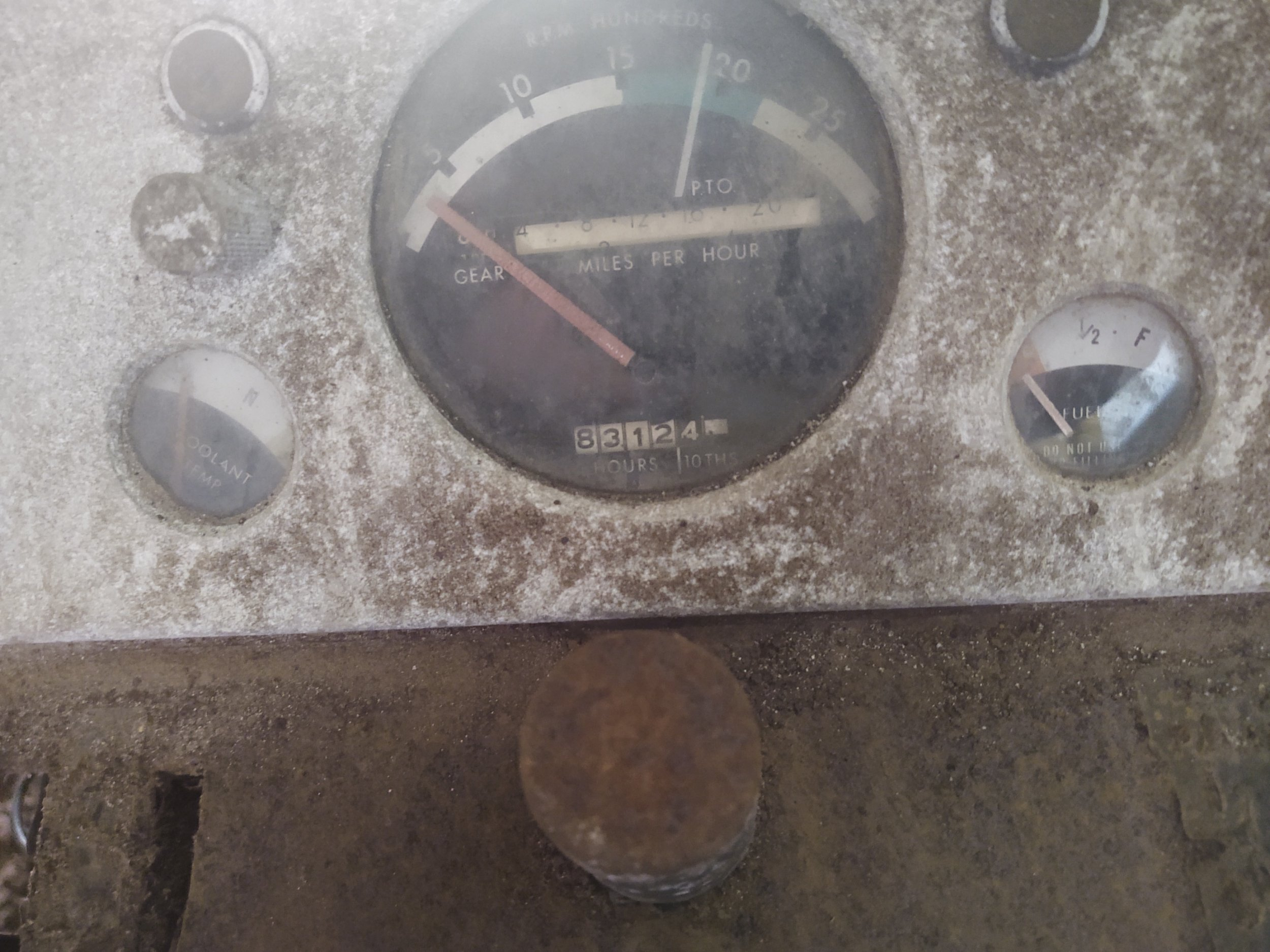

Hey everybody,
I've got a big question about my '68 4020, but please forgive the backstory first. . .

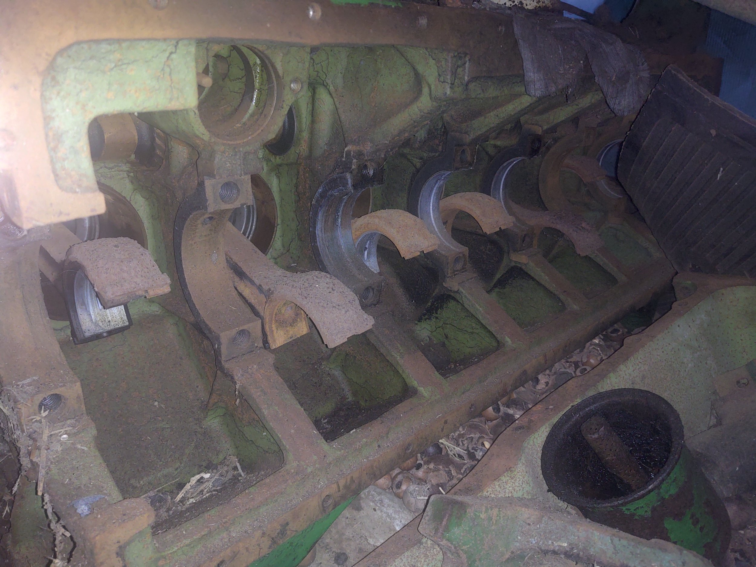

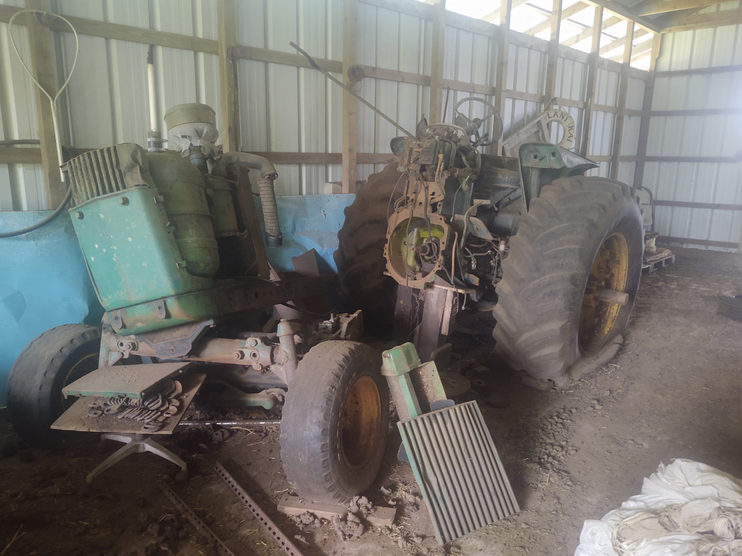

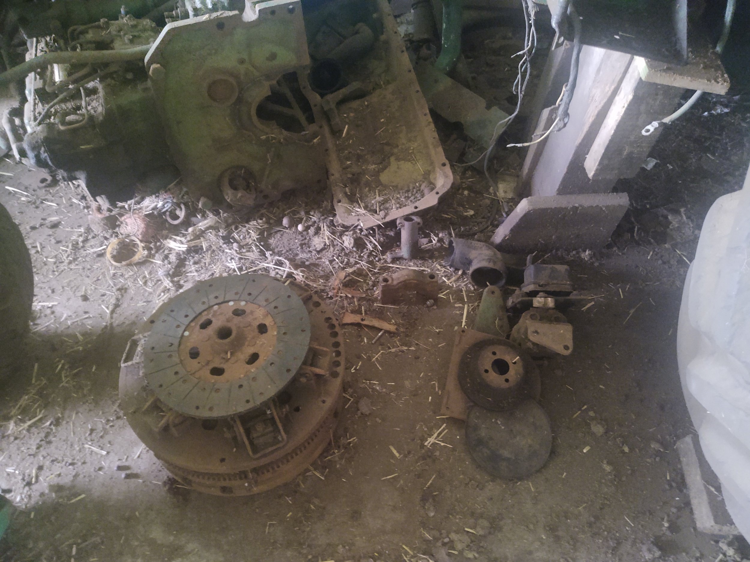

The wife and I just bought an orchard that hasn't seen any attention in years, and it came with a house, and a bunch of broken down equipment, including the aforementioned JD. We desperately need a tractor and shredder to start revitalizing the orchard (but we're on a budget), and I'm trying to figure out what's the best way to get there. Should I try to sell the 4020 as (rusty) parts and buy something running, or would it be worth it to fix it and buy a brush hog? Someone in the long forgotten past took it apart, and somehow lost the crankshaft, don't know what else grew legs in the meantime. To make matters even more interesting, we live in a place where everything rusts, and everything needs to be shipped in at high cost, but it's beautiful, and everything grows here. I'm handy, I weld, and do automotive repair, but I've never worked on a diesel, or any heavy hydraulics, but I've got friends around who have and can help. I'll attach photos, any and all advice or derision is welcome.

Oh my.
If you have the skills and time it would probably be very satisfying.
I personally would go another way.
Best,
ed

Parting is such sweet sorrow.,
....but I’d part it out or sell “as is”.
People like those 4020’s and they were very very popular. They are iconic as they came to represent Deere’s transition into a new era. For a lot of small farms, back in the small farm heyday, they were often the first “big tractor” at 90Hp, and often the first diesel.
It’s nice to see them restored and a lot of people restore them as a hobby (or as a tribute to their dad, or their childhood, etc..) ....but getting yours to running condition looks expensive. And that’s just restoring the stuff you can guess needs to be done. Could be a bottomless pit if you then discover it needs a lot more.

Welcome to TBN
If the piston rod & CS main brg caps original locations weren't marked then engine block would require being "lined bored" & I'm not sure if piston rods could be reused by resizing. One could locate/install a self propelled combine engine or salvage yard engine. Also closed center hyd's such as a 4020 utilizes if there's a hyd problem requires very knowledgeable diagnostic procedures. Rear tractor tires are expensive. I'll advise to sell 4020 & buy an operating tractor. I think salvage value which is dependent on location should be in the $2500-$3000 range. Granted the two tractor 1/2s will be a challenge to load on a trailer.

That looks to be less of a tractor and more of a good start to a salvage yard ;)
Personally I'd keep it to rebuild just because I like doing that kind of stuff, but also buy another working tractor to do work now. If it's anything like cars, by the time you got done restoring it you'd have twice in it what it was worth but if that's what you enjoy doing it would be a lot of fun.

IMHO, a 4020 is the ideal haying tractor, but not the best thing for an orchard operation: To big, more power than you need and not operational at the moment.
But, there are companies here in Michigan than sell re-manufactured crankshafts for anything. So, you could hold out to eventually get the 4020 put back together. But you may not even know why the crankshaft was removed. What other damage is there yet to be found? It may take you 5 months to get it all back together and running.
Best suggestion would be to get a used small subcompact diesel with 30 - 40 hp and hydrostatic drive to run a big (84") rear mower, can crawl under trees, pump water, supply backup electricity as needed, pull wagons and carts and is easy and cheap to run by anyone in the family. Lots of Kubotas and Deeres in our market and staying ahead of inflation because of their predicted longevity.
So, locate a dealer close by and see if they would rent you something to try out and begin your search and budget allocation(s) there.

I'd part it out and loose it. Way beyond normal capabilities and you'll have serious bucks in it.. Basically a pile of junk parts but there will be a market for those parts.
