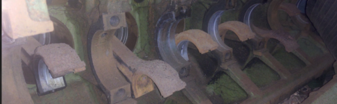

Best bet would be get another 4020 and you can use it and look at it to put the other one together. Im finishing a JD skidder now. Jimmy Carter was president when it was bought new. Had it all apart. Sandblasted and painted the parts individually before assembly. It is worth it. Im trying to teach you a lesson that you dont have to learn yourself. Just go out and buy s newer one that has adjustable timing, plastic fuel tanks with rubber hose and lift pumps, computer, regen, etc...Our oldest is an 81 and newest is a 91. Will use any one all day weeks on end. Never been to any type of shop. I would use a big tractor for little things before Id use a little tractor for big things. Got a call about another machine abandoned 20 years ago. Wheels torched off and parts missing. Yeah im gonna get it if its gettable. Have you priced new skidders lately? Have you priced a new tractor that size? With a slush box tranny? This new stuff is over complicated. I worked as a mechanic at a dealership. You could end uo with two tractors that run good. Dont worry about the main and rod caps not being marked, if they are not. Just turn the crank as you tighten things down. It will stop if the parts are not right, move them around. Put several werengines together out of buckets and nothing was marked. They ran fine and still are running. If it was a off brand tractor I would get rid of it. But with it being name brand, I would run it. Those were gas or diesel engines in 4020, gas usually propane, seen them with carbs too. Find one just like it that is usable and also use it for a looker to put the other one together. Find a crank, hone block, put new rings, lap the valves, and put together. Or you can call a salvage place and get an engine. Ive bought too many that had trees grown up through them and chain sawed them out and come alonged on a trailer. I have never parted anything yet. In fact, i have a 58 Fordson power major diesel that had been passed through 15 people that couldnt get it running. Nobody could figure out that vacuum governor system with a butterfly like a carburetor. Glad i stopped listening to other people a long time ago. If that was my 4020, Id be using it before they knew what happened. I went and fixed a fork lift for a guy once. Worked for JCB at the time. He had 300 of those JD tractors. Big ones and most were 4 wd. All were ready to go. Not any for parts. Funny, he wanted me to remove all the electric junk so it would just crank and die with the key and a kill. The electronics things get old fast.
   / 4020 fix it or forget it? #30
I'm going to reiterate IF ENGINE ROD/MAIN BRG CAPS AREN'T correctly marked/identified Forgotten Orchard can't SUCCESSFULLY REBUILD present ENGINE without some unknown added expenses. It would be an eye/wallet opening experience to spend the time/$$$$ to get that engine running & a rod or main brg FAIL and a large hole appeared in the side of the engine block!!!:devilish:
