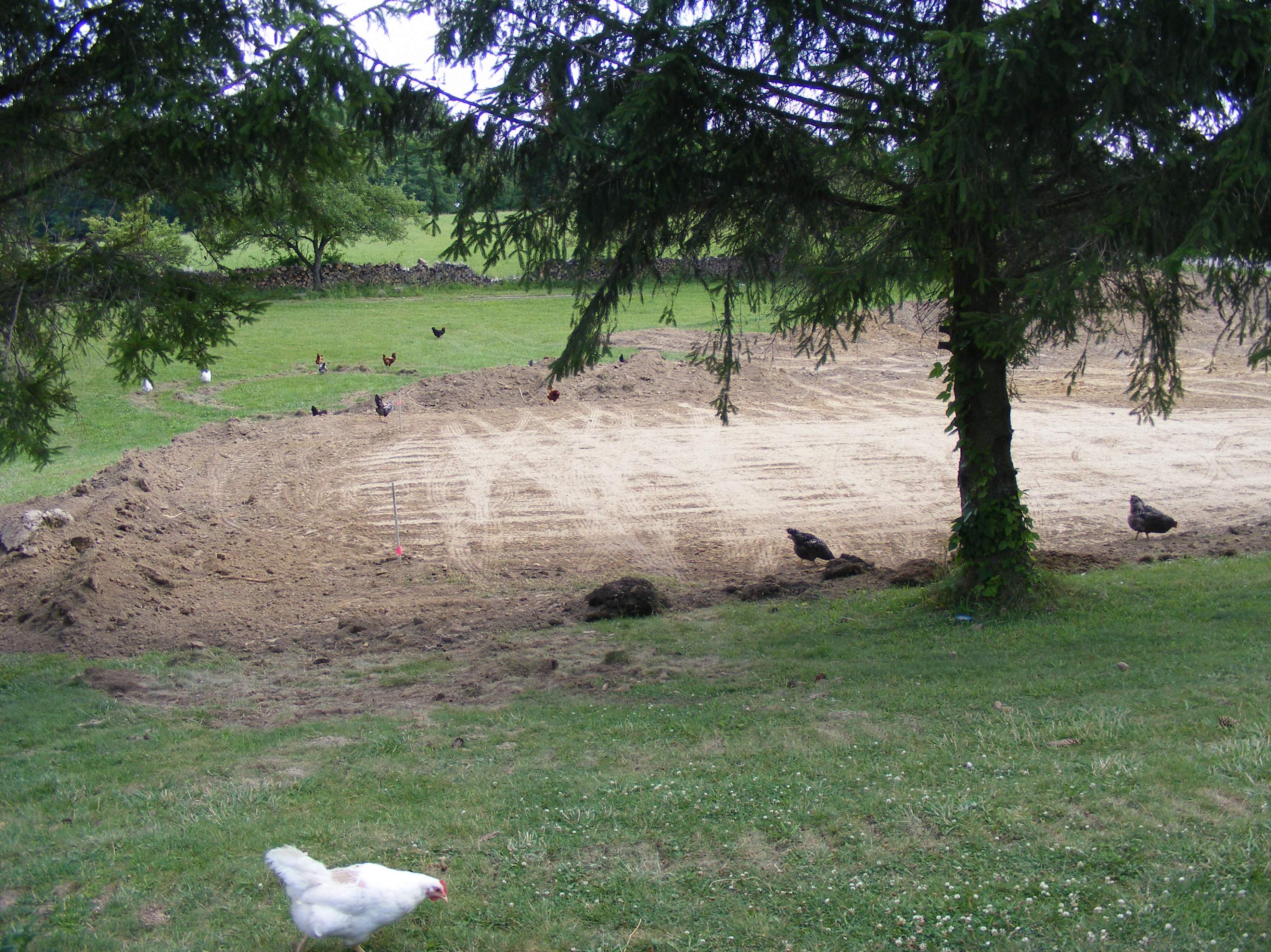

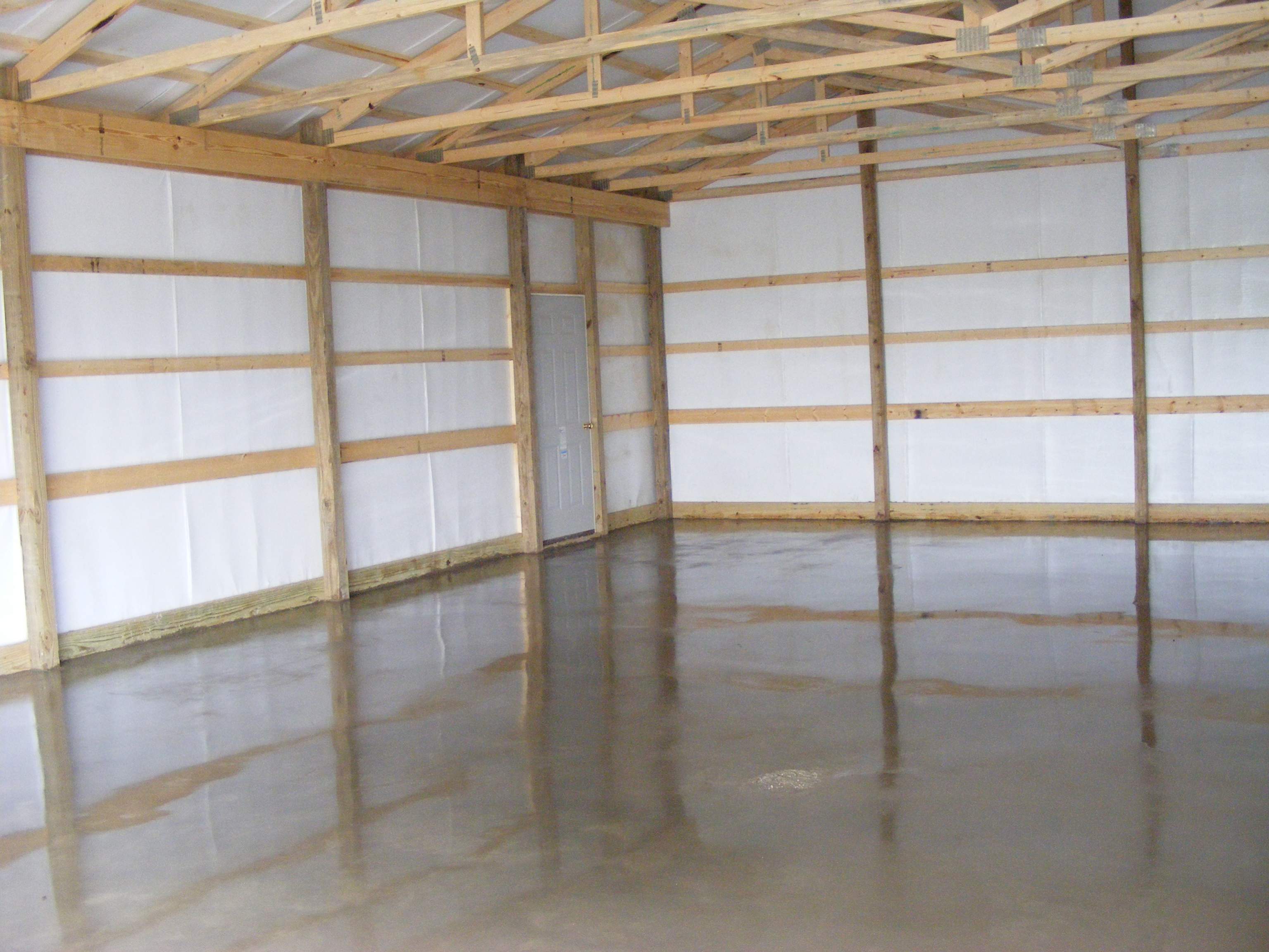

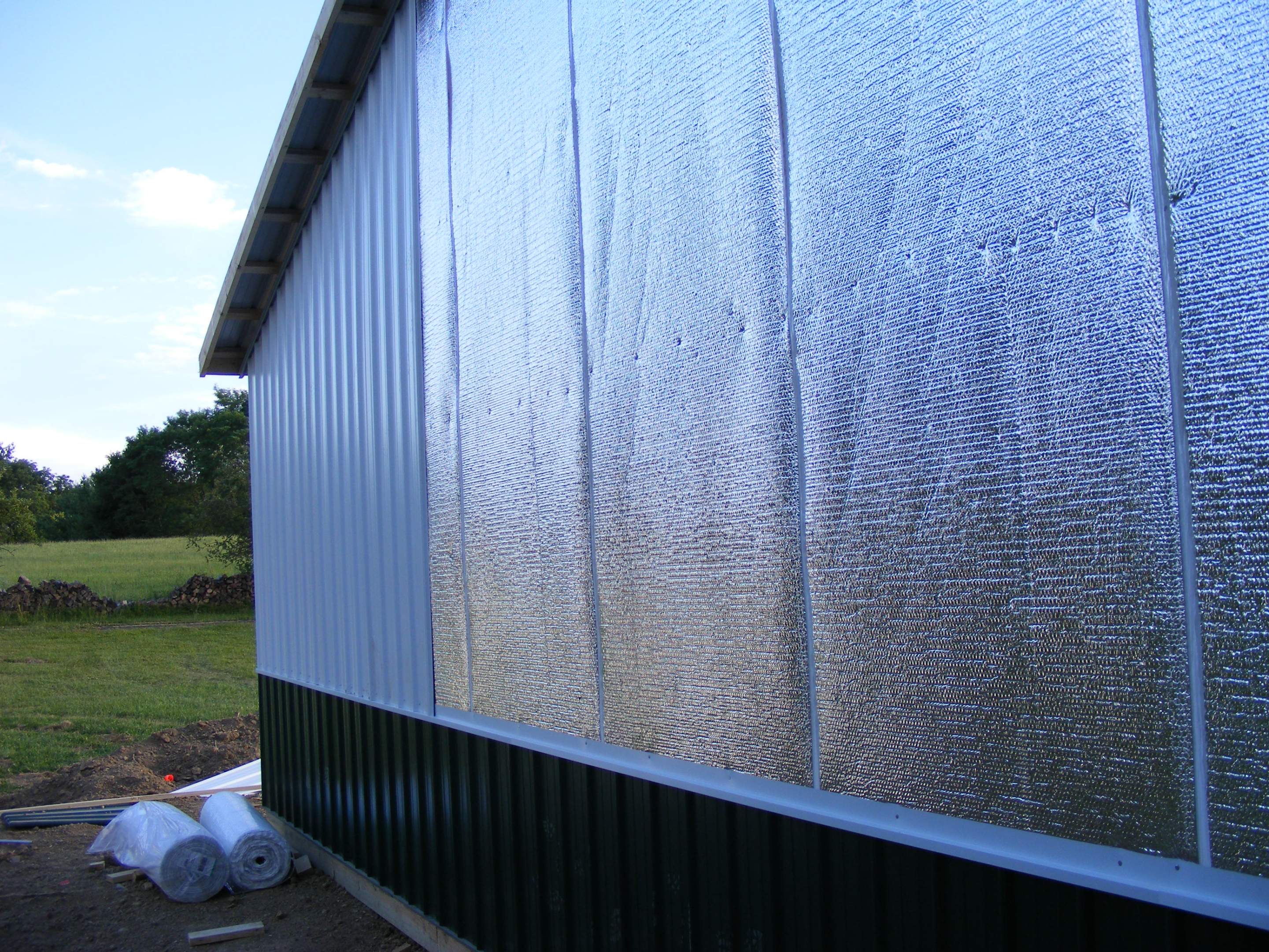

They just finished mine today. Built by some local Amish. Took them 3 days. 30x40x10. 1' overhang all around. Winscoting, 18' insulated garage door with opener, 3' man door, 4" concrete floor with floor drain, single bubble vapor barrier/insulation on walls and roof, vented ridge and soffit. I did the site work. Total price: $12900. Still need to get the lighting and electrical done.
I will try to attach some pictures (you will see the garage door is not installed yet but it is included in the total cost). Also, he needs to come back in two days to cut the concrete seams.
The cost breakdown:
materials $7288
concrete 1524
gravel/wire/drain 674
labor/concrete 1000
labor/building 2400
Total $12886
