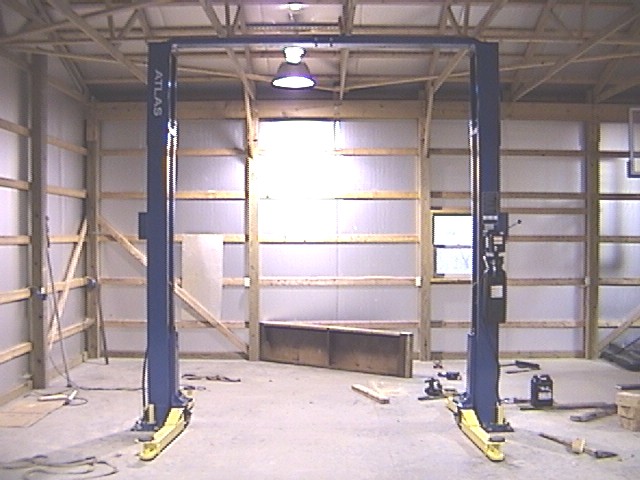

Here is my 10,000lb automotive lift. Before I had the concrete poured, I dug out two 2'x2' pad areas 8" deep where I thought the 2 post would be located at. The manual states 4" of concrete, but I thought more (8") is better.

Another shot of the lift. The Kioti also came in handy setting the post up. /forums/images/graemlins/cool.gif
I must have been pretty close on the pads in the concrete. I drilled all holes 5" deep for the two post, but did not go through the concrete. /forums/images/graemlins/laugh.gif
I have already had 4 or 5 vehicles on it.
