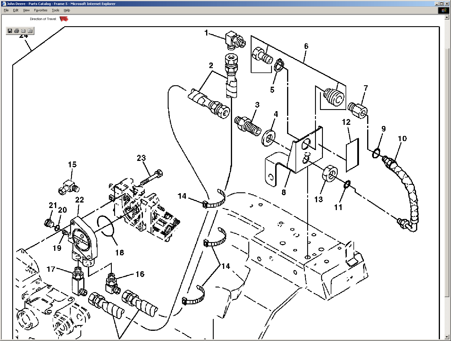

Anybody have the Power Beyond Rear Auxiliary kit (part # BM19290) on thier 4110?
I need a remote and I am trying to figure out the best wat to add one.

The power-beyond kit looks like a good deal at only $210. It gets you the fittings, plugs, and hoses you will need to connect to the SCV. Its kind of a tight space, so you could mess around for a while getting the right combination of fittings.
The power-beyond only gets you the by-pass pressure line and return lines from the SCV. It is suitable to connect a down-stream valve-bank like that on a back-hoe. This pressure line is always "active", and must be allowed to flow in order for the tractor's SCV to operate. When it is not being used, it is looped back to the return using the supplied male and female quick-connects.

If you look carefully at the diagram, you will see that one hose terminates in a female quick connect socket (6) that is mounted to the bracket (8).
The other hose is permantly assembled with coupler (13) to a pig-tail (10) with the male quick-connect (7). When not using the PB, you plug the pig-tailed hose into the connector on the bracket.
The pig-tailed loop hose always stays with the tractor.
If you were connecting a valve up instead of a backhoe, you might leave off the quick-connects, the bracket, and the pig-tail loop and instead just thread the hoses directly to the valve body with the appropriate adapter fittings.

The picture on JD parts does not show that loop. Is that picture you have from the instuctions?
/ 4110 & Power Beyond? #8
Strange.
Under the 4100, BM19290 shows the extra length of hose.
Under the 4110, same part number BM19290, no hose.
The drawing numbers, however, are different, so it must be a different rev or something.
