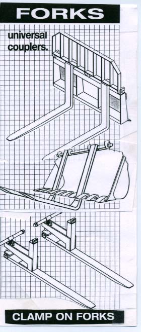

So, if I get the Kubota, most likely I would leave the mower on for good counterbalance for the loader (I want the pull behind finish mower), and buy an aftermarket forklift blades (see attachment). However, the versitility of the PT is not lost on me. So, does this impact anyone's advice?

As the NON-PT owner here, but someone who has a Kubota, let me make a few comments.
Using a RFM (rear finish mower) as a counterweight is not recommended unless you have some wide open spaces. That thing will be roughly 5' wide and will stick out about 4' back, you will be amazed at the places you cannot get into with one of those attached on the back of your tractor. Furthermore, it is my general understanding of your yard (based on a couple threads and a photo) that you have a HEAVILY landscaped yard, that will further hinder you with a big RFM hanging on the back.
Now with regard to the front forks. Forget it. You are looking a very small (7510) and a small tractor (7610). There are no quick attach forks built for those little machines. That would limit you to clamp on forks. Your lift capacity would be so dramatically reduced that you'd only have a few hundred pounds of lift capacity! That is hardly worth the effort. Certainly you would NOT be able to lift any stone, and even if you tried to pick up a pallet of mulch, it is likely you'd only get 1/4 of a pallet of bark mulch off the ground.
Let me offer a bit of an explination. The farther FORWARD you carry the load, the lower your capacity. Kubota measures bucket capacity at the center of the bucket. So whatever capacity you have at the bucket center, for every 20" you go forward, you can deduct about 30%. Bucket forks clamped to the bucket would move the load out from the 'center' of the bucket to a point that would roughly be centered 40" forward of the bucket center, so roughly you'd lose 60% of your lift capacity! That may not be 100% accurate, but it is a pretty good estimate.
