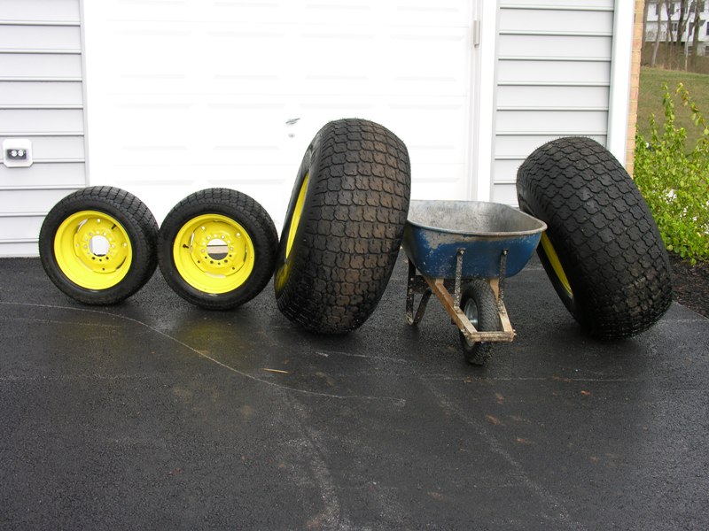

Good points and thanks for the updates. BTW, i found a good deal on some wider tires and I got them coming to the house next week. Only worry I have is that if I put them on their wides setting, will I be able to get the 4310 into my garage! LOL!
   / 4320 do I load the tires or not #42
here they are

   / 4320 do I load the tires or not #48
Nuru said:
I used, used anti-freeze and that was very cheap and no rust worry on my 4100. The 4310, i am not sure if i will need to do that. Looks like usings the ballst box will do it, especially when i run on the Turf Specials. But Foam loading on the fronts might be a way to go. However the tire manufacturer said not to do that, so...etc.
I don't think that I would load turf tires since the whole idea of turf tires is that they should float. You don't want any extra weight on your lawn or you will end up with tracks in the mowing pattern. You can drop the weight box anytime you want to.
Since you now have two sets of turf tires. I suggest that you trade off the old set for some R1 or R4 tires. There are plenty of people out there that are looking for some turf tires. You could load the R1/R4 tires and just run air in the turfs. I have always thought that having two sets of tires is the way to go (or having two or more tractors ;) ).
Marshall
   / 4320 do I load the tires or not #49
Marshall
Hmmm, trade in my other R3's, Hmmm. That is an interesting thought. Did not think about that route. Another route is to just get the rubber and replace it . Hmmm, let me think about that. Thanks for seeding my mind:rolleyes:!
