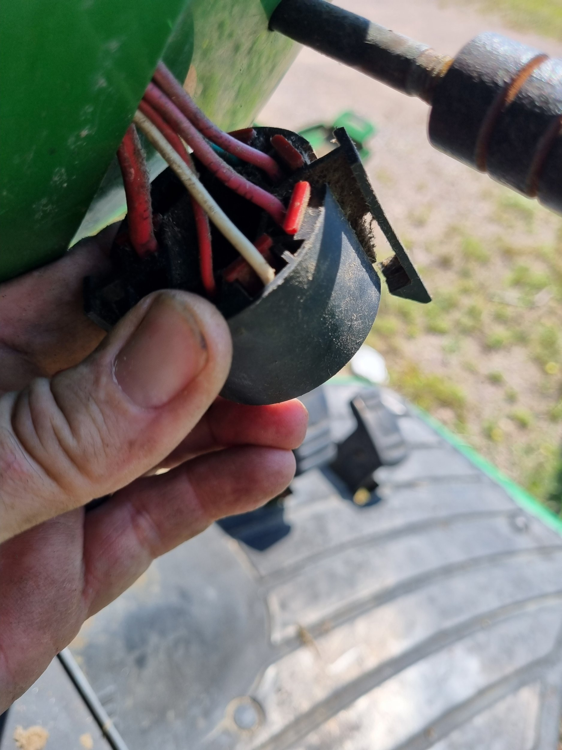

So to me, this means the starter and solenoid do work, and the battery is good.
While I was doing this I did have the ignition key in the run position, but the engine still did not start.
I pulled the ignition key assembly out, then tried to test the white wire from the back of the ignition key to the solenoid.
I could not get a signal through from the white wire in the electrical connector at the back of the key to the solenoid.

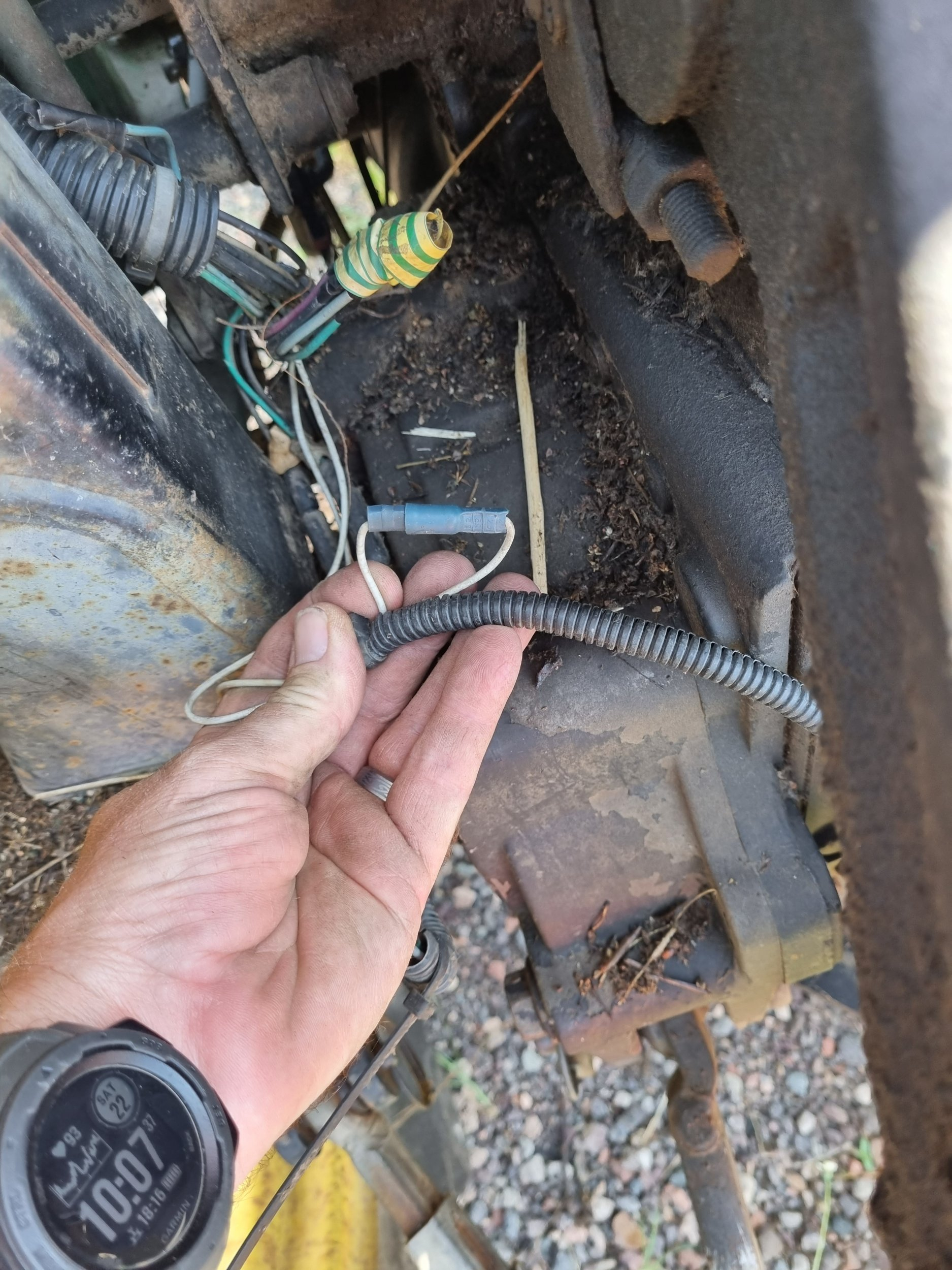

Neutral safety switch seems to have been bypassed, I am looking through the manual at the moment trying to understand the wiring diagram to see if the pictured white wire below driver's seat on the left is the neutral safety wire. The picture is taken from behind the tractor to the left side.

   / 4400 will not crank. #14
That may be where the seat switch was. Crimp on terminals like those are suspect - may want to verify they haven't corroded by measuring continuity across them

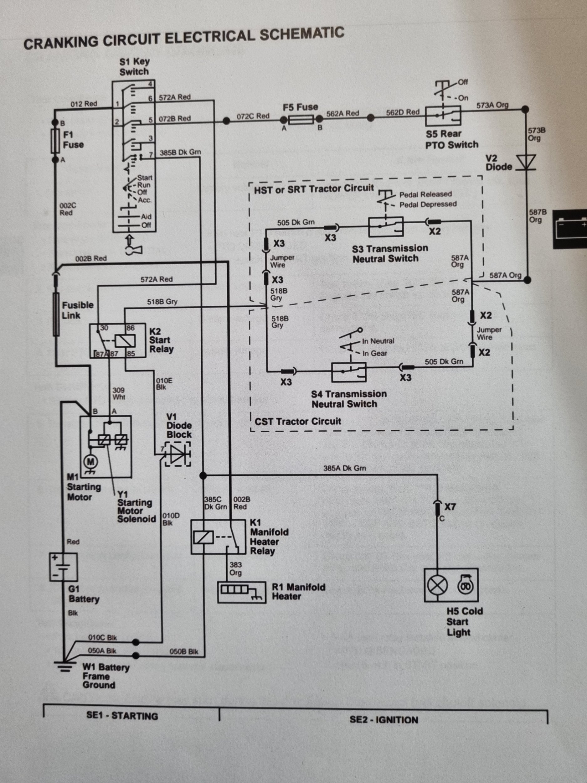

I may have the incorrect wiring diagram as I believe this diagram shows 3 red and 1 dark green wire coming from the key switch.
But my switch has 4 reds a dark green and a white.
How should I test the key switch?

   / 4400 will not crank. #17
Try tracing back from the start relay to the key switch - that will be the wire that needs to be energized in the key start position. If that gets power check the start relay output.

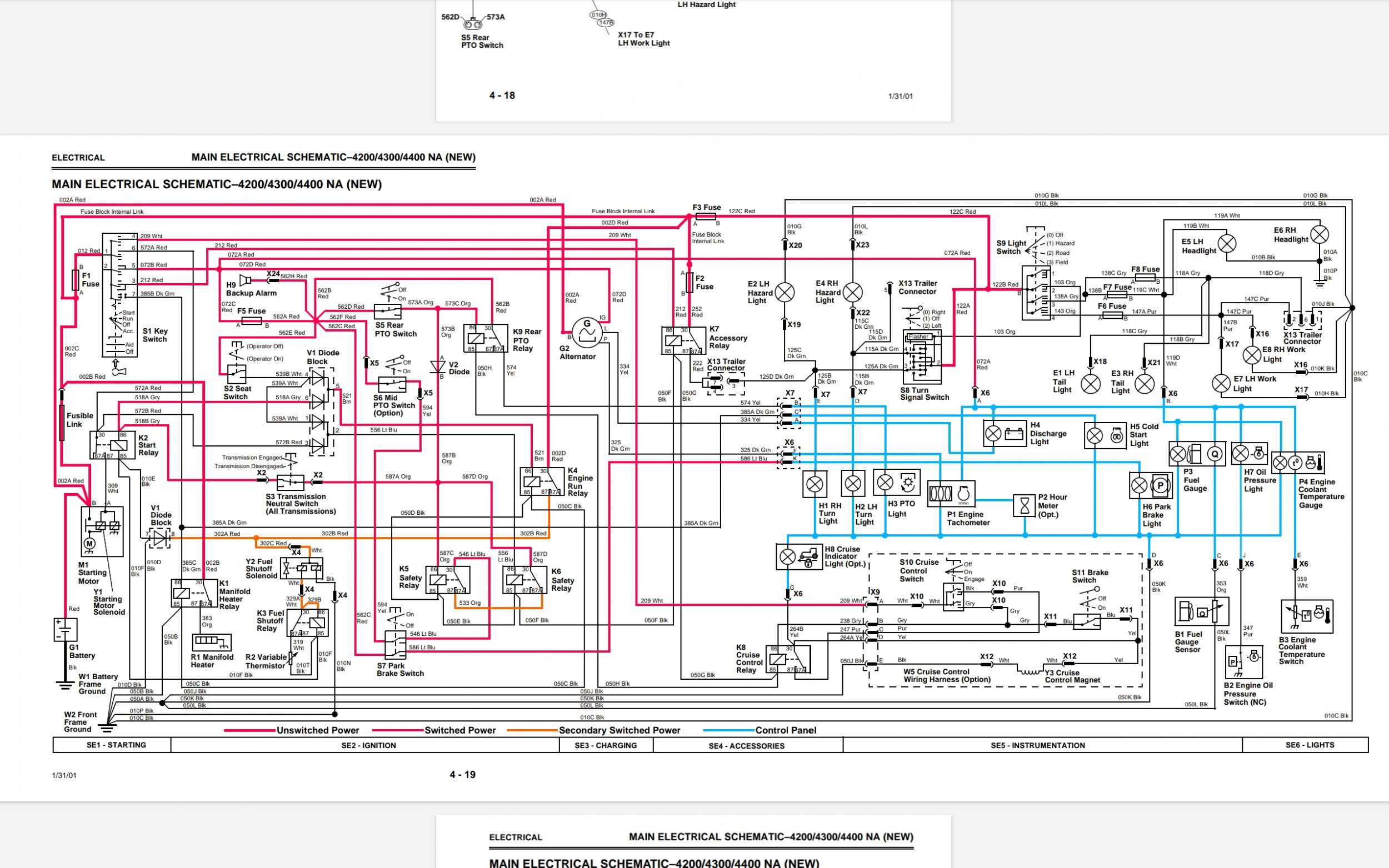

I was refering to the wrong diagram, this one seems more relavent. I plan to get back to it tomorrow, before things get too hot, it was almost 90 deg F here and over 85% humidity.

   / 4400 will not crank. #19
Keep at it. Follow the battery voltage. Make sure that it the voltage switches to the appropriate terminals on the switch in accordance with the switch diagram.
