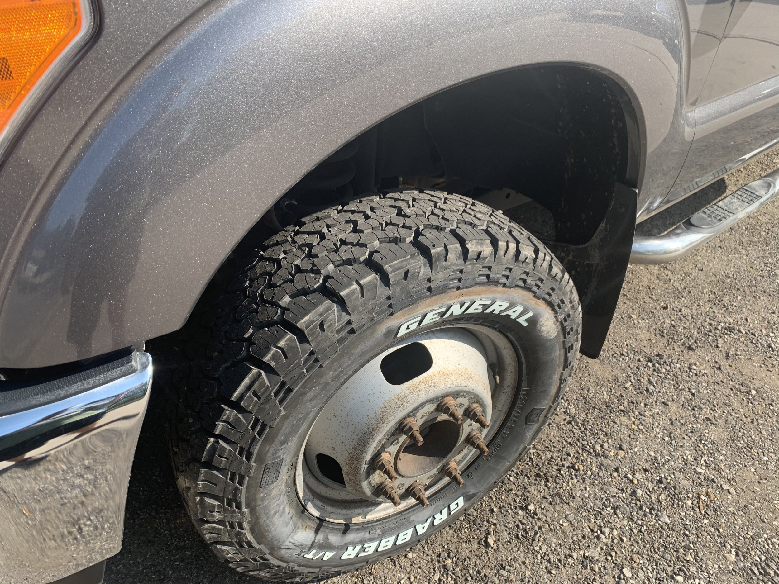

I’ve only put 6k miles on my new set of General Grabber ATX’s. Thus far, very happy. On my half ton I had, I put General Grabber AT2’s on and they were spectacular. The AT2 was the predecessor to the current ATX.
Yeah I run the same tires on my 2500. (General Grabber ATX - load range E)
Great tires, had them for a few years now. Winter up here is a big deal and we run to the UP towing a 23ft trailer to ride sleds so I definitely wanted the best winter traction available in an all terrain type tire.
