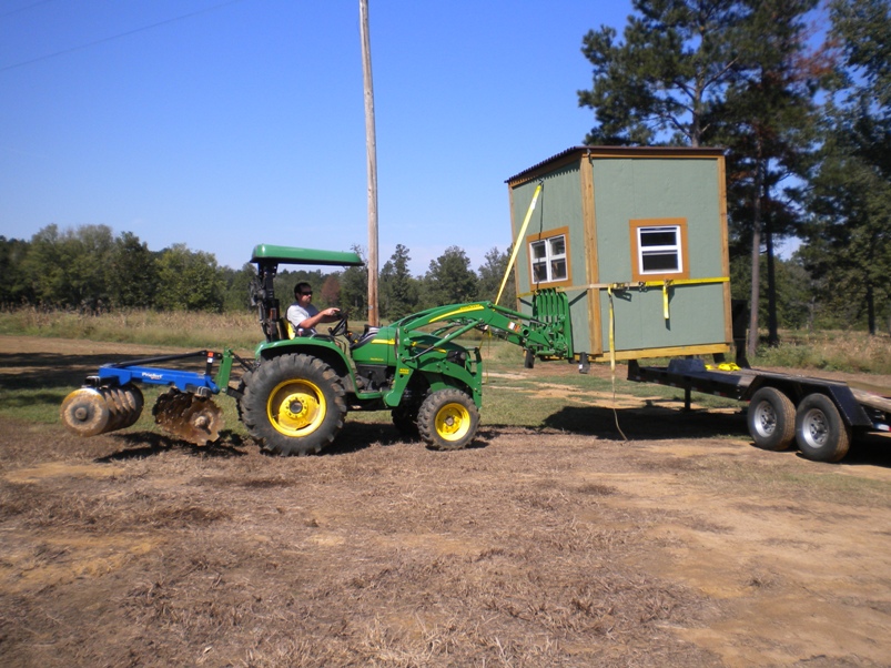

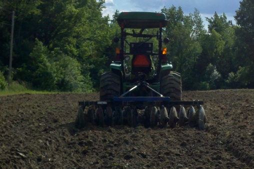

I have a 4320 with the PR tranny. While your 4520 has a few more hp, the frame size is identical. I use a 8ft. Priefert disk with 24-20" blades. I'm not sure of the weight, but I'm sure it is substantially less than the disk you are looking at even though the Priefert is a heavy, well built disk. I have sufficient power in B2, but I could certainly use more power in B4 (around 5 mph) which is where I need to be to get the best results. This is all the disk my 4320 wants. In some situations, it really works the 4320. In fact, if I sink the disks to the axle, it is too much disk. If I were you, I would look for something no bigger than my Priefert.
