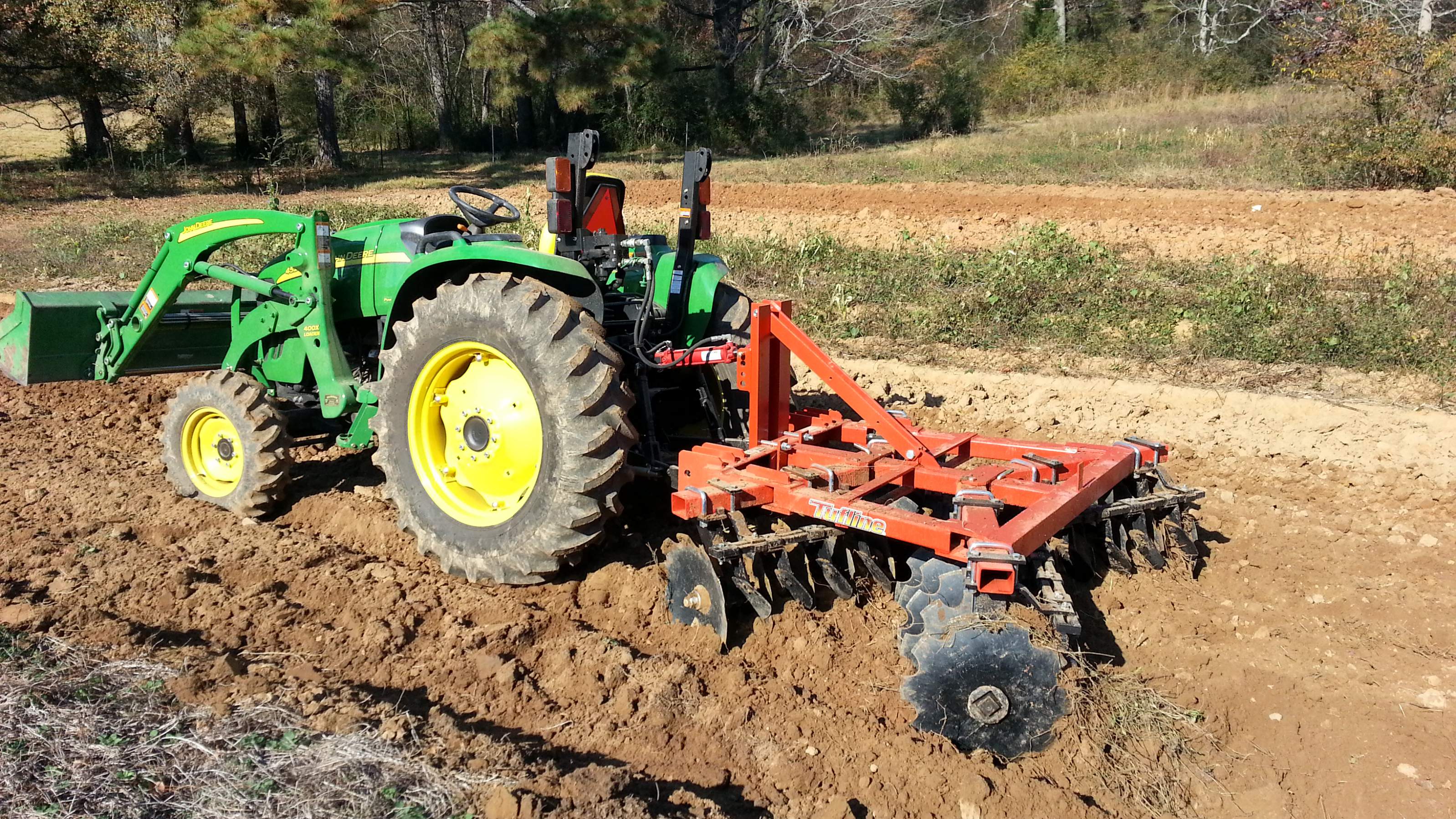

Pic.
What size blades and spacing is this unit? Is your tractor a hydro or gear drive?
Has crossed my mind to consider adding a 4000 series unit in the future due to greater maneuverability. Thinking the hydro would be handy, but curious how it would do if needing to pull some ground engaging equipment.

i had the hydro 4520 with the ag tires and i didnt have any luck pulling my two bottom plow . dont get me wrong it would pull it but it was always giving trouble with the load match feature . i finally traded it on this gear drive 4520 and the difference in pulling power is very noticible . i wouldnt trade back for nothing . whenever it comes to ground engagment gear drive cannot be beat. my disk has 20inch blades with 9inch spacing i believe .

Good choice on the disc harrow.
I have heard several times that the gear is a more efficient drive train. My thoughts were to have one and be able to utilize a grapple for clean up work and also have the grapple set up for the 5303 too. Have been operating a skid steer with grapple all afternoon reclaiming old log roads. It is very handy being able to ease into something and keep pressure on it while lifting and curling. Do you miss the hydro for that type loader work? The truth of it is I don't think any tractor will match or best the skid steer for that type work. The visibility is unbeatable. I have the ground engaging work covered with the 5303. Might be best just stick with it and consider adding a skid steer in future instead.

I do kinda miss the hydro for the really close up tedious bucket work. But after some time on the power reverser transmission I have now I think it will be about the same. I can't stress enough how much better this tractor pulls compared to the hydro model I traded in.

Both units were set up the same except for transmission? Same tires and ballast?

Yes both machines where the exact same other than the transmission. And I never said the hydro was useless. I said for GROUND engagement type work the gear tractor can't be beat. And if you can swing it I would definitely be looking at the tuff line it's a top notch piece of equipment.
