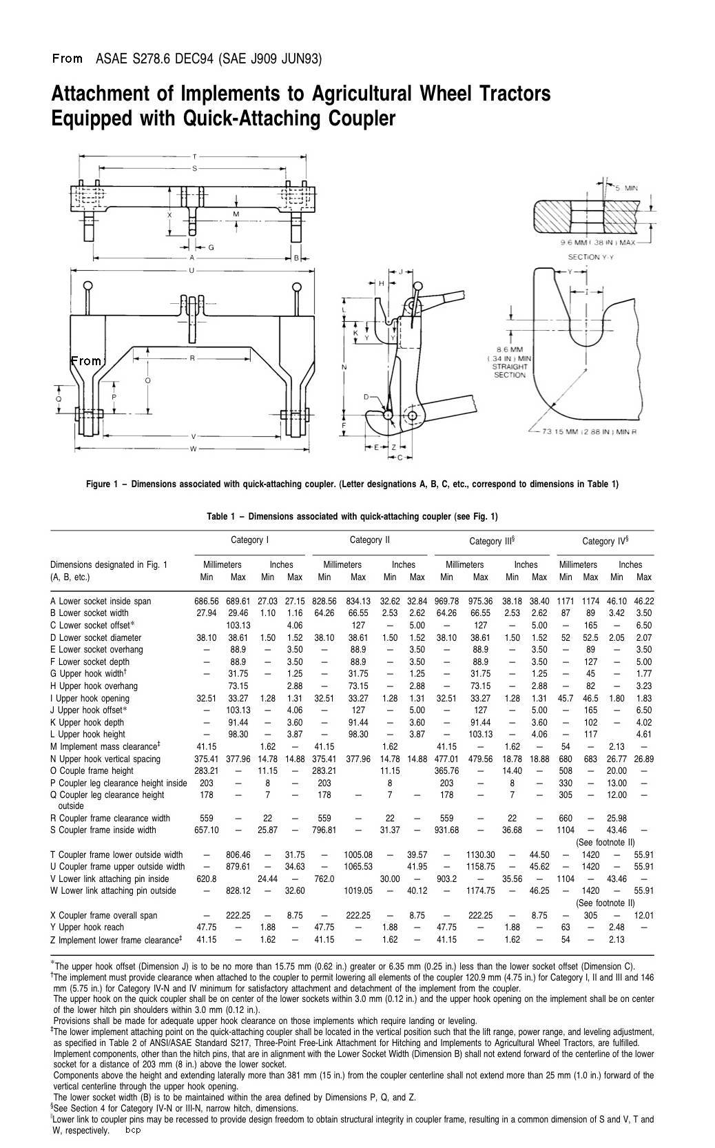

There is no spec, no standard. There are hopeful ideas about standards but there is no standard. The industry generally has embraced ideas about diametrical standards but even that is mostly serendipity. It's just dumb luck that they are fractionals
AND there is this....
  • ISO 730 - 3 Point Linkage.pdf
   / 4707 3 Point adjustment issues
#72
There is a spec/standard. If there wasn't - then there wouldn't be much point in declaring what category it is. Also see above, ISO and ASABE both have standards listed.
A question I did not see a answer to is what is diameter of pins supplied with cutter....
I don't know the measurement but they fit my ball ends perfectly. The pins are 100% cat 2.

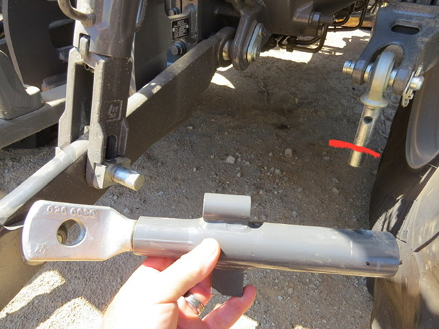

You point is well taken, but if industry creates a standard, and a manufacturer does not recognize it or built to it its on the manufacturers shoulders...
Got to agree with MinnesotaMorg... Push it back to manufacturer...

Good news.
I thought I was going to encounter pushback about returning the unit, but it seems that my message eventually made it to the owner who is going to make a design change and trade out my unit.
I have to say it's a bit relieving that I got someone in the industry to agree with me that something isn't quite right here. After getting enough pushback you start to think you're the crazy one.
I hope this makes the product better going forward, and I guess this is now a good example of pushing back on manufacturers to help enforce standards.

I think I would drill a new hole in the part that attaches to the tractor 90 degrees from the other hole. Maybe split the difference from the end. That would give more flexibility.
So I finally got back out to my new (2022 mfg and June 2022 delivery) 4707. After going through this thread I wanted to see just what I have for adjustment. On mine, another hole would not bring the lower bars closer together because the limiting part is the swivel eye on the tractor end of the sway link. Even with the pin removed, the lower bar won't go any closer to center because the swivel eye does not have enough rotation. My lower bars are about 32" apart when there is still some play in the eyes. At 31" everything is bound tight.
It really looks like the geometry (not the pins) was designed for Cat 3 and the adjustments barely get you to Cat 2 spacing.
