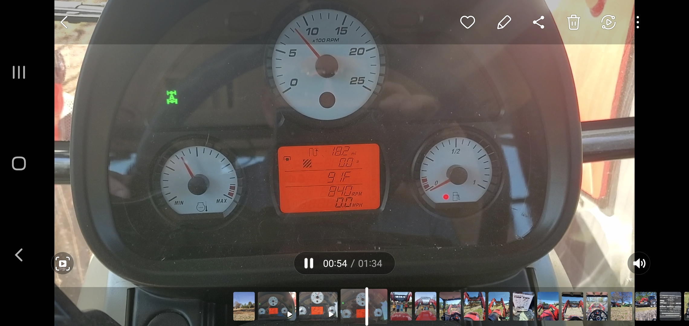

Anyone happen to know what the following fault code is:
d 3
516427
Guessing it has something to do with the fuel gauge which is reading zero when it’s half full.
   / 4707 #496
d 3
516427
Man I just logged on to ask the same question. The fuel Guage was at about 3/4 and it pegs empty and slowly comes back up while in neutral and pegs spuradically when driving. I got the same code sometimes and an audible alarm. Sometimes I only get the pegged needle with the red empty light and no audible alarm or fault code. Mine is a 2022 4707 with about 5 hours on it.
