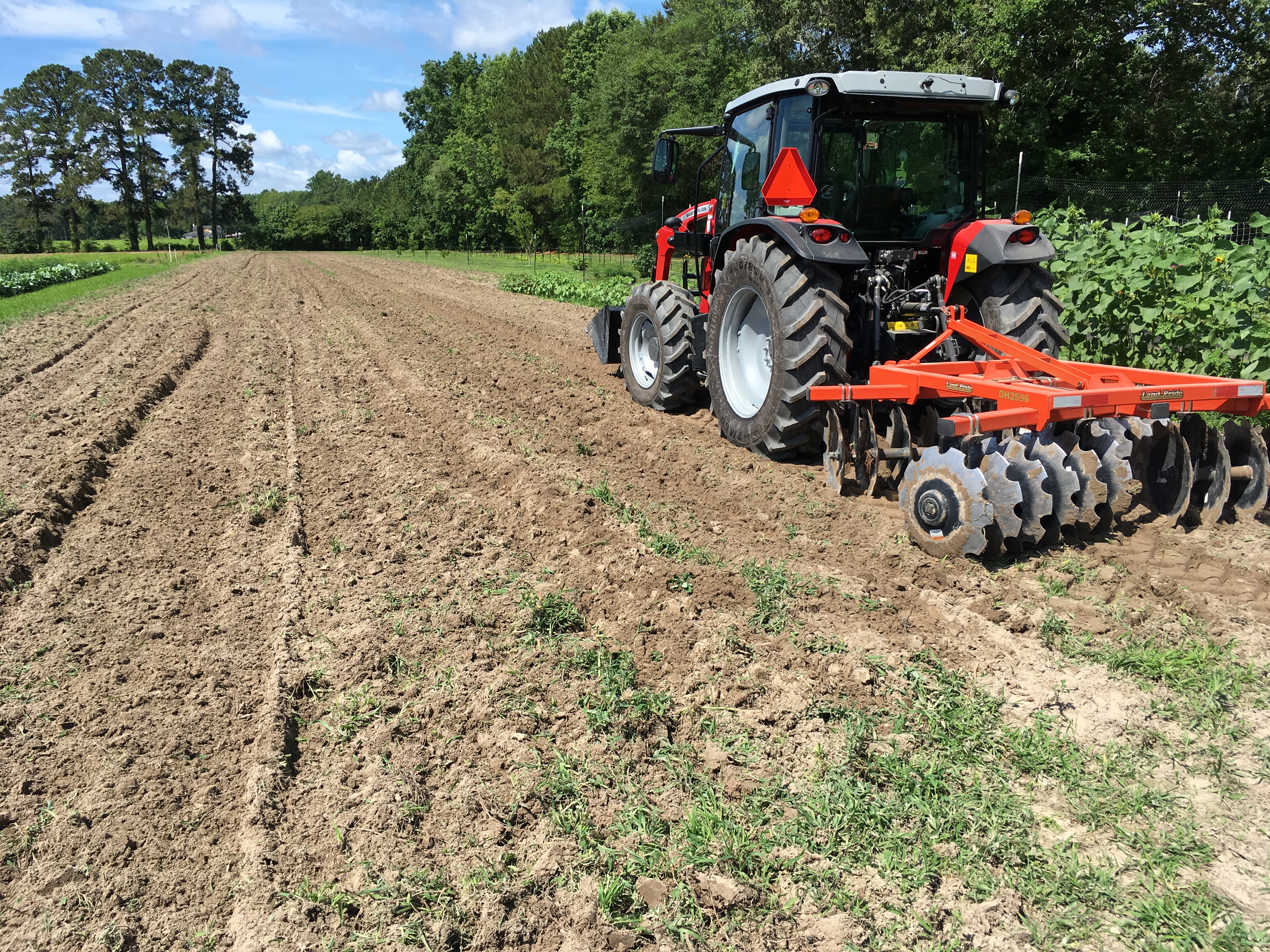

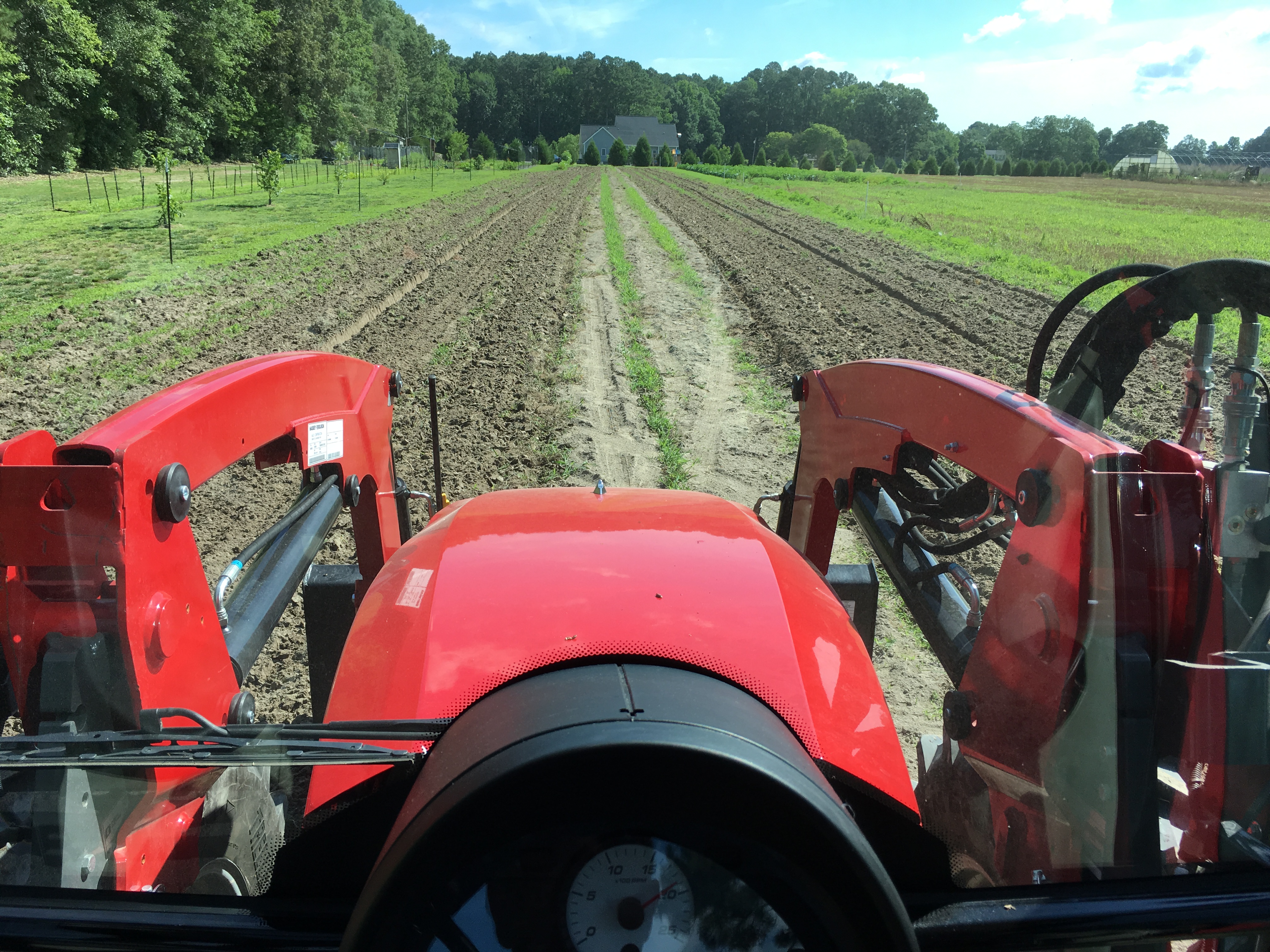

You still liking your 4707? I am considering buying one with in a year. I am trying to find out everything I can on these machines. This forum is awesome! I am very interested in the the Dyna 2 transmission. How is line of site out front window with the FL3615? Does loader obstruct front view much? Does this machine have enough power to run a 8' to 10' bush hog or a 4x4 bailer on 20+ degree slopes or should I go to a 4708 or 4709? I only have 20 acres of pasture and 10 acres wooded. Want to make sure I buy the right size tractor the first time. I would appreciate any input and suggestions you have. Thanks in advance.
I still like mine. I just got it back today from a shattered door. The windows and doors were installed incorrectly after the tint was applied which made the door alignment off. That is what the door shatter. For the bushog, a 10' should be fine but I cannot speak to the baler.
