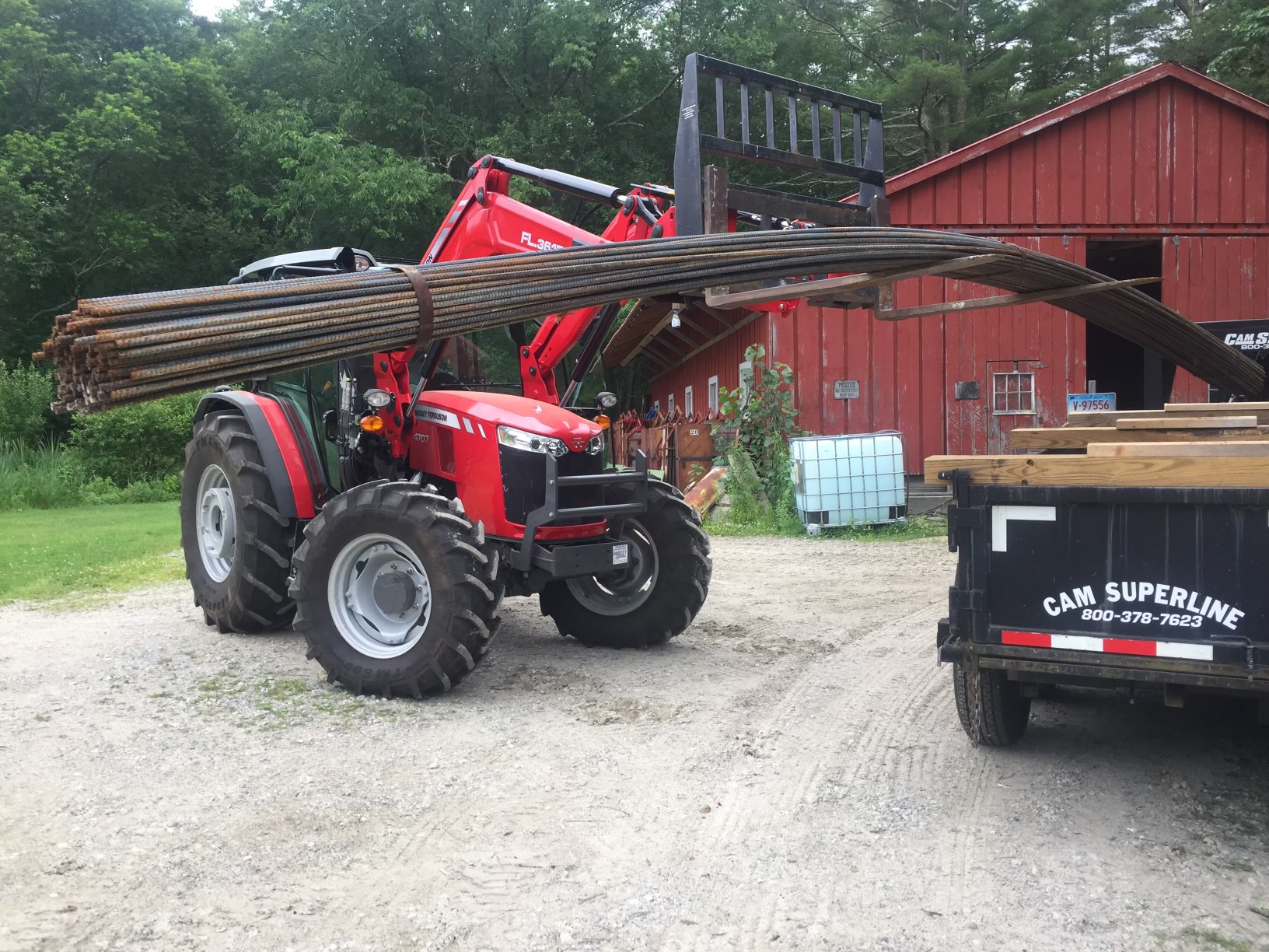

My 4707 has the FL3615 loader, which has a rating of 3,400lbs. I routinely lift and move 2,000lbs with the loader and many times fill the bucket with gravel or loam and that must run 2-3,000lbs. Even with just 2k, the back end is light and forces me to engage 4wd.
