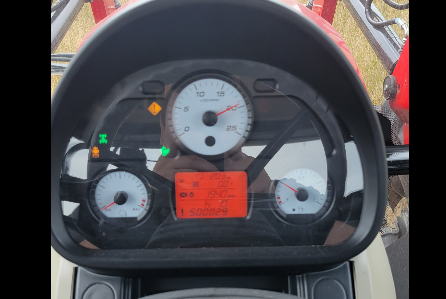

I got my 10ft rotary cutter going with some help from the guys on the 4700 Series facebook group. Temp on the dash was showing 165-180, not sure what that is measuring.

My coolant Temps never get over the last hash mark to the left of half way on the dash gauge.
The temp displayed on the LCD middle screen is trans oil temp. Mine heats up slowly and on a hot 100 plus degree day levels off around 165 to 170 degrees while running the bush hog.
